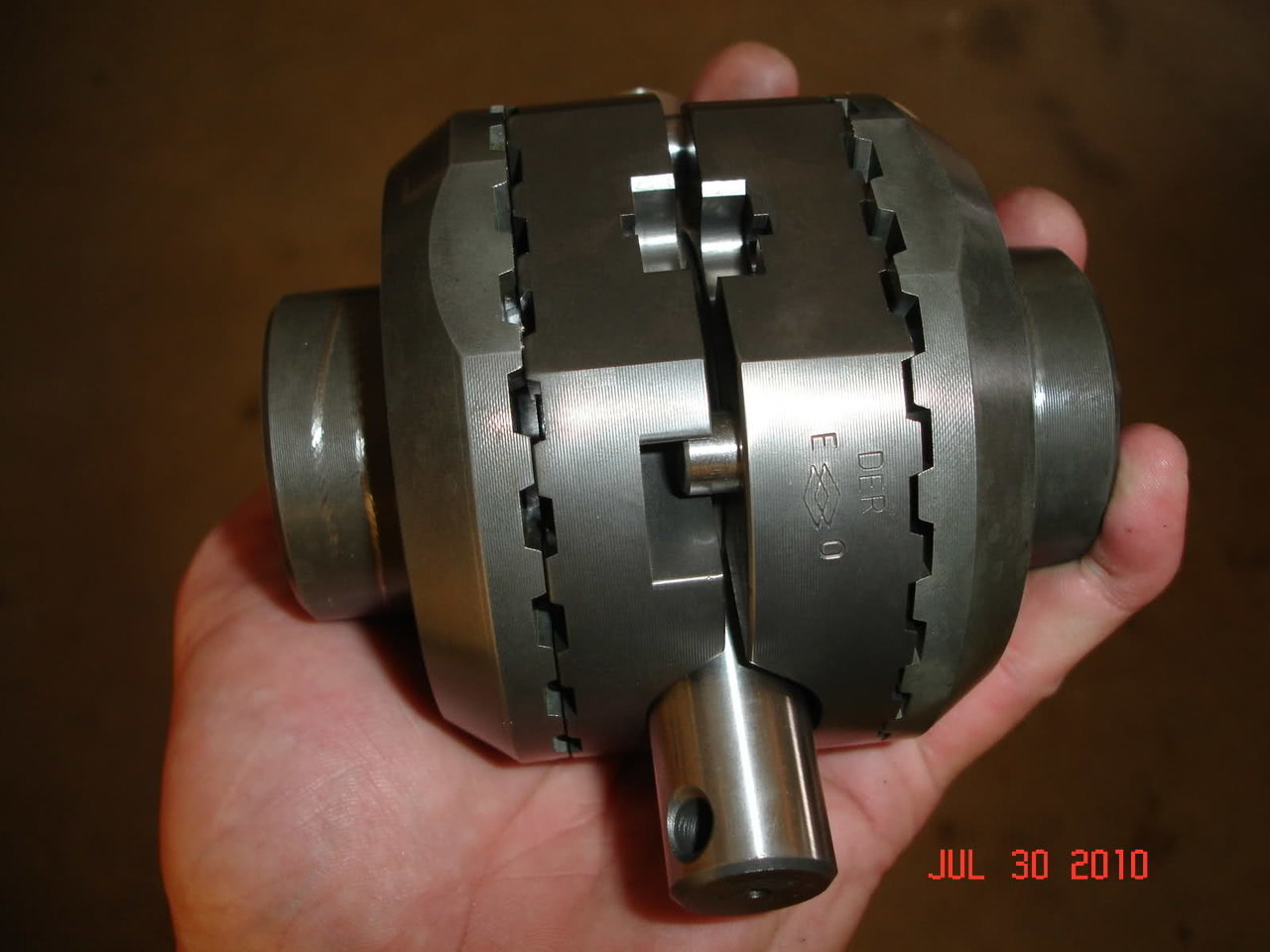

    are you happy with that rear powertrax locker. im still scared of locker because of axle binding issues. can you shed some light on how it has performed in your truck and what all went into the installation. i hate using gear paint over and over on the spider gears until is perfectly aligned. vwill i be able to avoid this with my truck. oh yeah its 2004 prerunner ext cab sr5 with trd package. love the way your truck looks to!!!!

    Gear paint? Theres no backlash adjustment here with the poweretrax sir.
    No binding issues. no strange tire wear. nothing.

    b-e-a-utiful!!! thats what i wanted to hear. now just to clarify wont see any of the stated issues with a powertrax lockright because i just realized you have a no slip in yours. dont mean to bug asking almost the same question twice just dont more issues to deal with for a little more traction.

    Hey man, when you go to install the locker do you need to buy a seal for when you reinstall the the 3rd member in the axle?

    No. It,s a really thin paper gasket. Just be sure and scrape it all off and clean the surface really well with some tolulene or something. Then apply some orange rtv gasket sparingly around the diameter of the housing.
    Some people also regimens replacing the axle seals. I didn't and have had no problems but I do keep a good watch of them.

    Hey man, if i order a powertrax no-slip would you still be up to helping me install it?

    Sure. Let me pm you some info before you order.

    Awesome truck man, trucks like yours made me start looking at tacoma's. You have done right with with your mods! Ive already ordered my powertrax and should be installing it in Feb. No more open diff!
