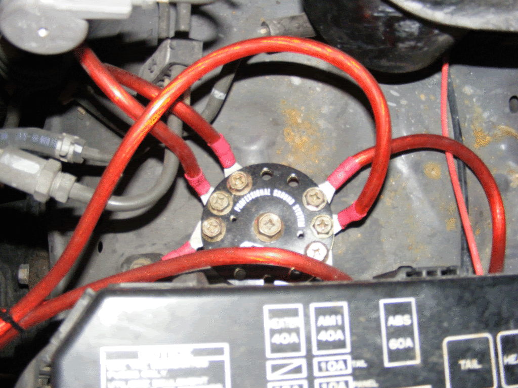

    I started out with simple things. My senior year of high school(2004-2005), I bought a 10 CD changer and installed that with the help of my friend David. Later on, thanks to the crappy construction job done by the lunatics they hire to do roads here in Miami, my truck's shocks blew. I drove it that way for a while and thanks to all the excess vibration caused by that, my truck developed a few rattles. I eventually grew tired and went to Toyota where I bought 4 new shocks and installed them, literally the first time I had done any serious work on my truck(All I had done before was changing brake pads or oil).
    On my second year at the University, my friend Ricarfens got me into the idea of adding a grounding kit so I ordered one and installed it. It noticeably smoothed the idle and improved how loud I could turn up the music without distortion(my factory ground was probably just in bad shape). My friend Javier later bought an intake which was not meant for his Corolla. It was too long, so we cut it and part went on his car and the remainder was used to replace the corrugated plastic part of my intake. Before long, the spark plug wires went bad so I ordered up a set of MSD wires and these also smoothed the idle, even more so than the grounding kit. Javier, who helped me install both even noticed; which he didn't after the grounding kit. Soon after, I bought some ebay "projector" headlights and destroyed all but one of the clips holding on the grill because the stupid Hanes manual said I could remove the grill without taking off the bumper- WRONG! Luckily, the bumper holds the grill on and so do the corner lights. I gained better lights, the ability to change just the bulbs, and some bootleg angel eyes as well.

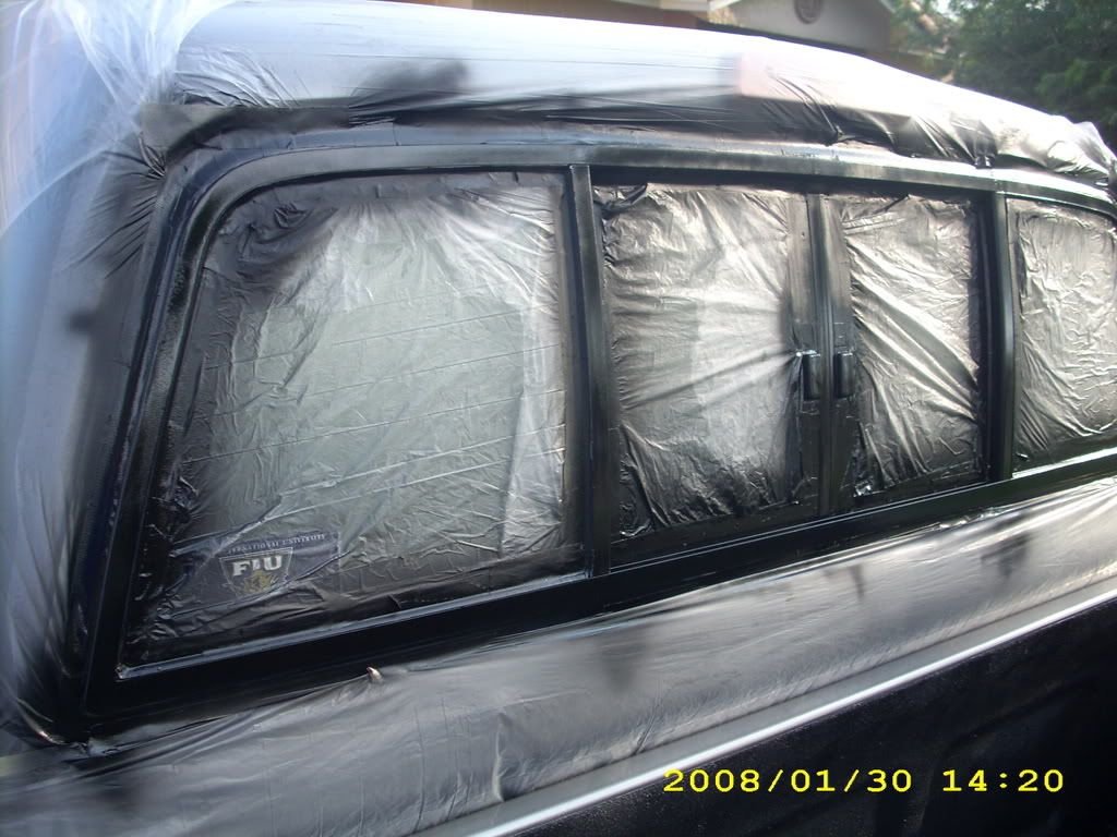

    During this summer(2009), I started my new job and began saving up for mods. Some idiots vandalized my truck by breaking the back window. I rode with it that way for awhile until I found a place that replaced it with a single pane for $130. I watched ebay like a hawk for a while until I found a set of Lancer Evolution VIII wheels for sale at a good price. I sniped the bid and won the set. When I got them, I left them in the garage for a few weeks. I later realized two of them were warped and oval instead of round. So I painted the two good ones and my friend Javier hooked me up with free tires (takeoffs from the front of a BMW), he worked at Pep Boys back then. He also mounted my tires, balanced them, mounted the wheels in the back, and moved my rear wheels to the front and balanced those as well (they had more tread). All of this was absolutely free! It really pays to have friends!

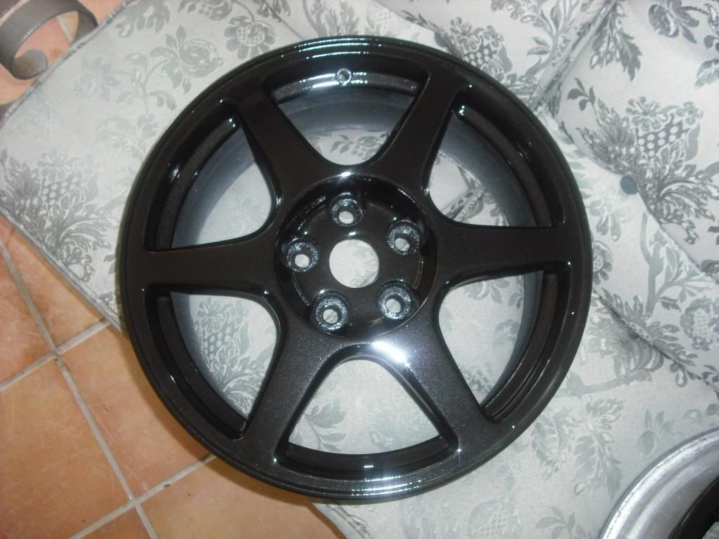

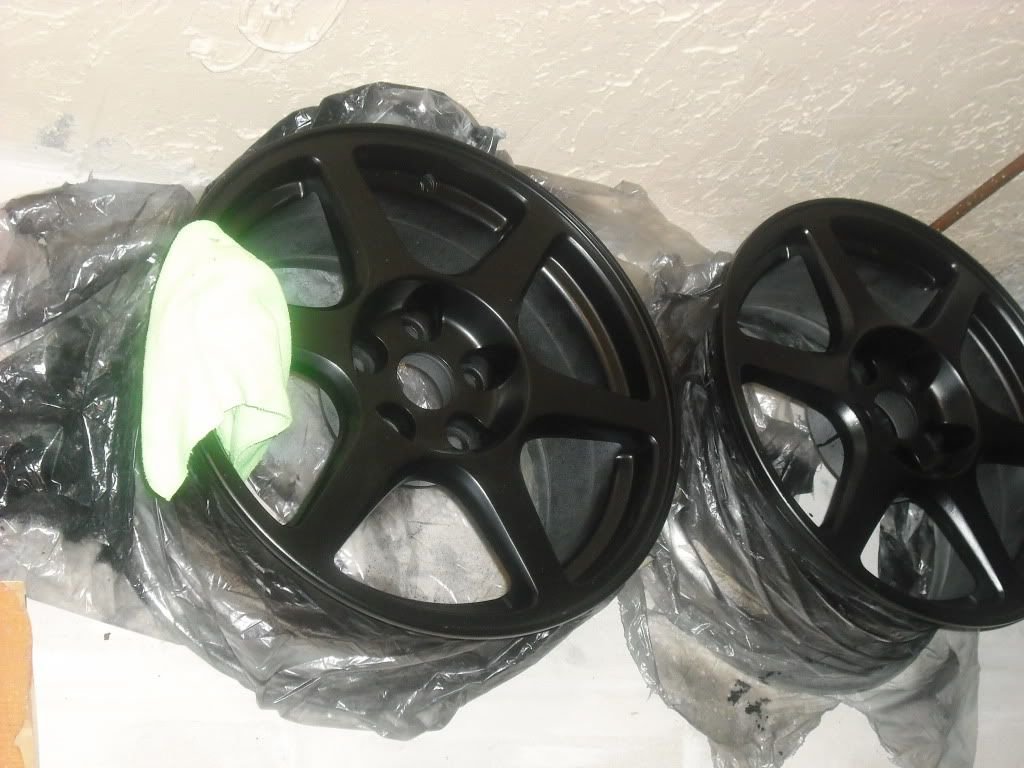

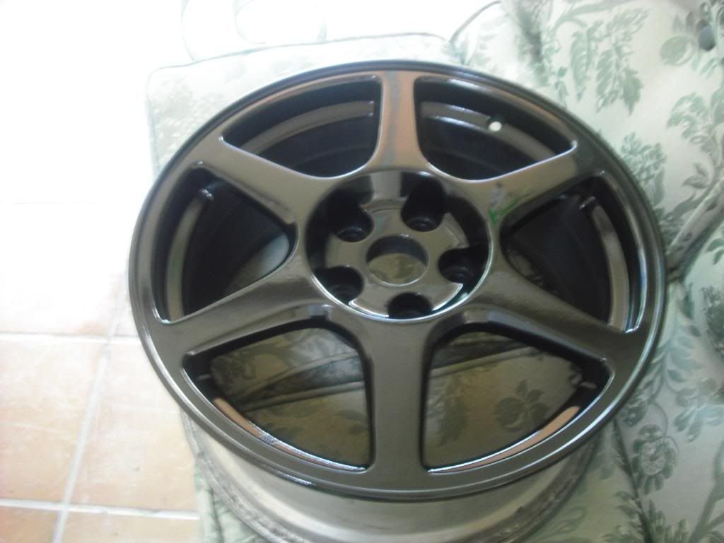

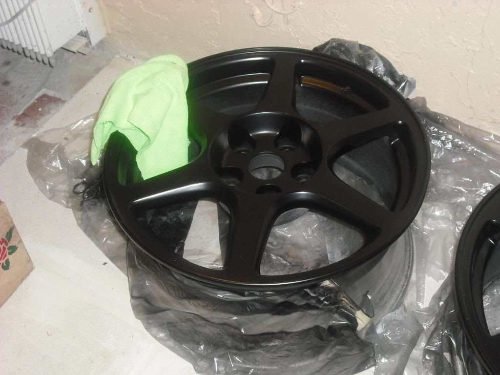

    My rims were painted in Black Sand Pearl, a stock Toyota color. It looks flat when sprayed, the pearlescence only shows after the clearcoat. I actually did the basecoat under an awning as it rained and I did the clear this past weekend (wrote this in 2009, so not literally this past weekend in 2021 lol). I used my smaller paint gun in order to get the best spray pattern and I went around the rims in a specific way in order to get the best coverage. As for the results, the pictures speak for themselves.
    I then ordered two extra Evo VIII rims that were true and painted them to match. I painted these two rims some time before the holidays, however there had been no sun for a few days so when I took them to get the tires mounted, the lips got the paint stripped right off of them by the machine. I taped them off and then went on vacation. Once I came back I painted them and then left them in the garage for a good week before mounting them, I did not want any more mistakes!

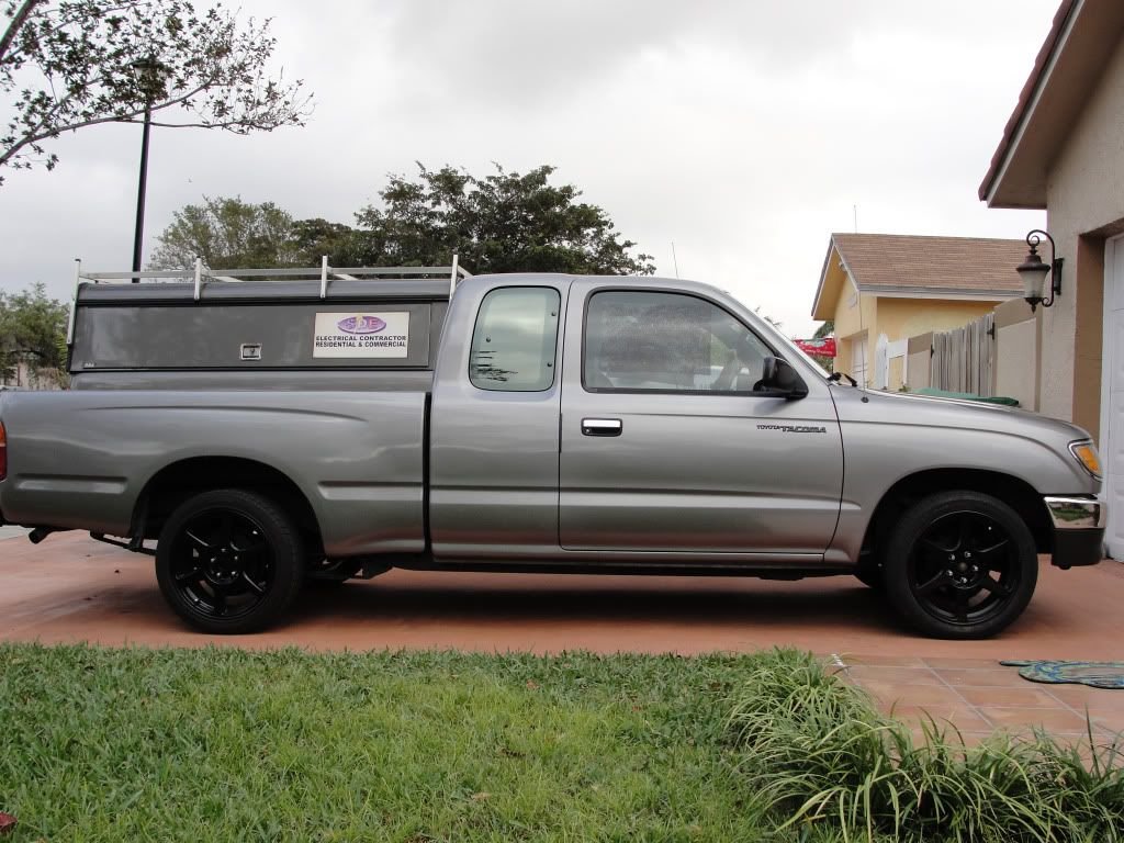

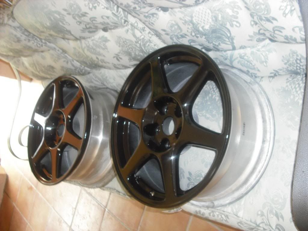

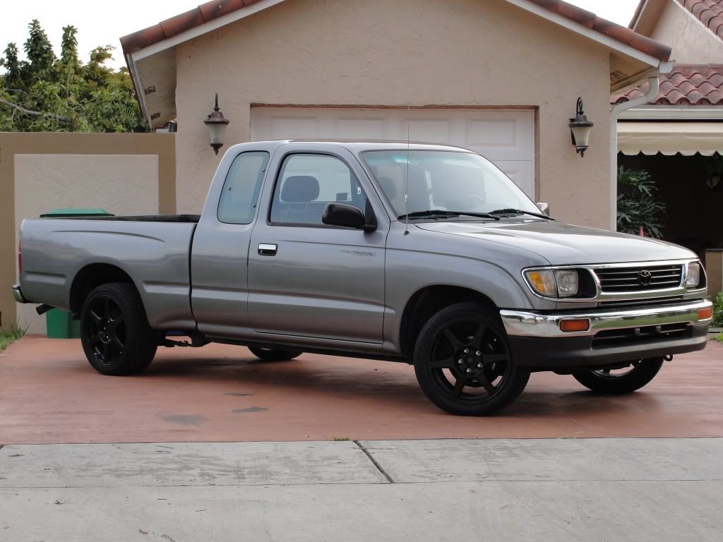

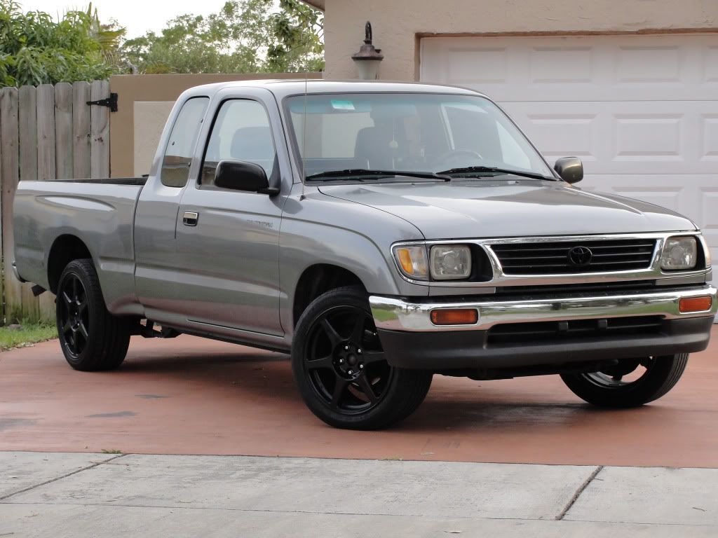

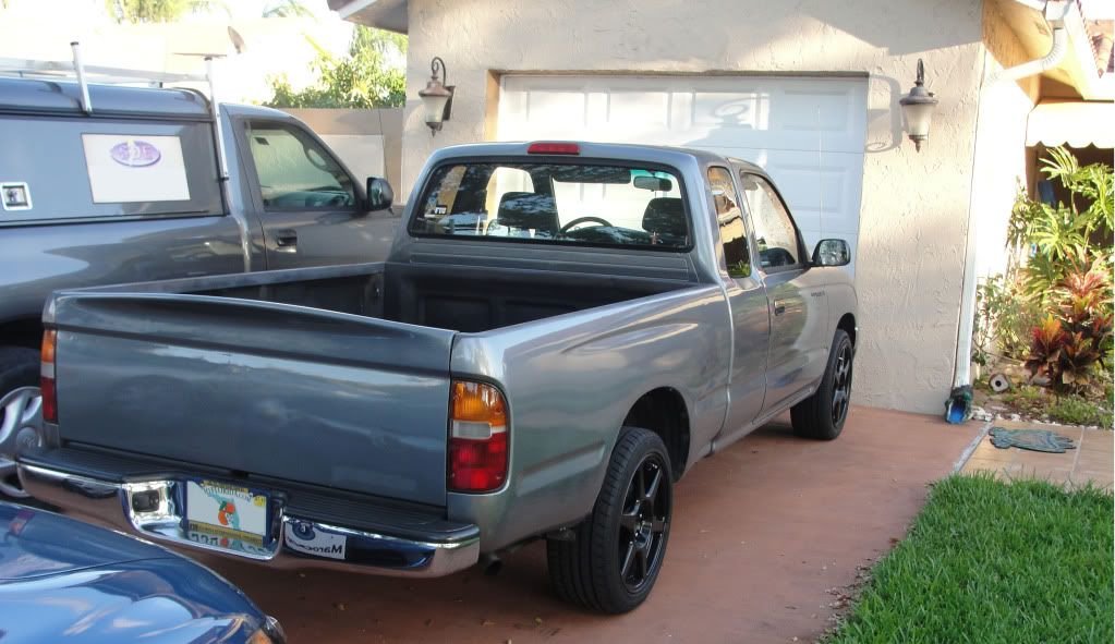

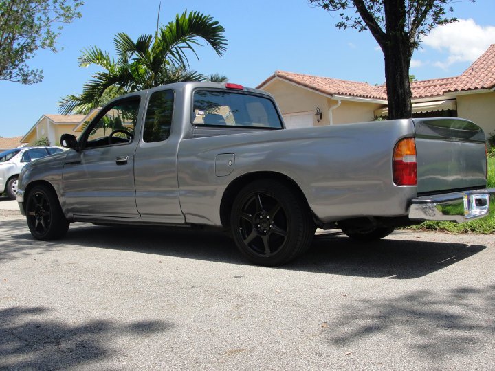

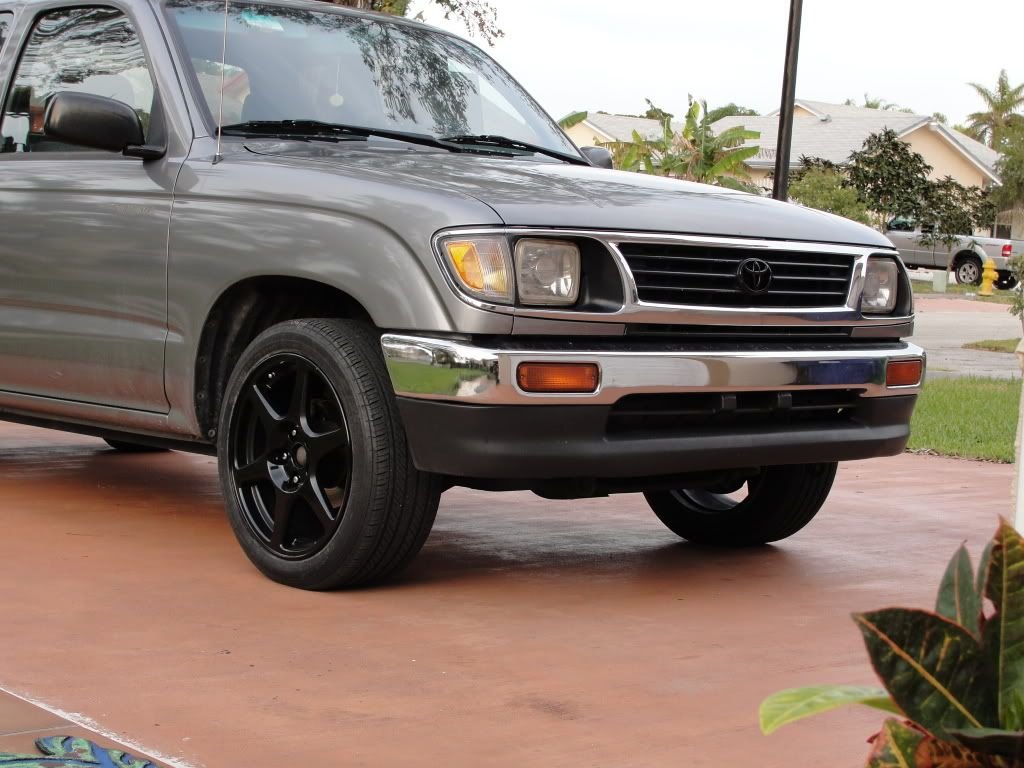

    Here are the images of the rims mounted.

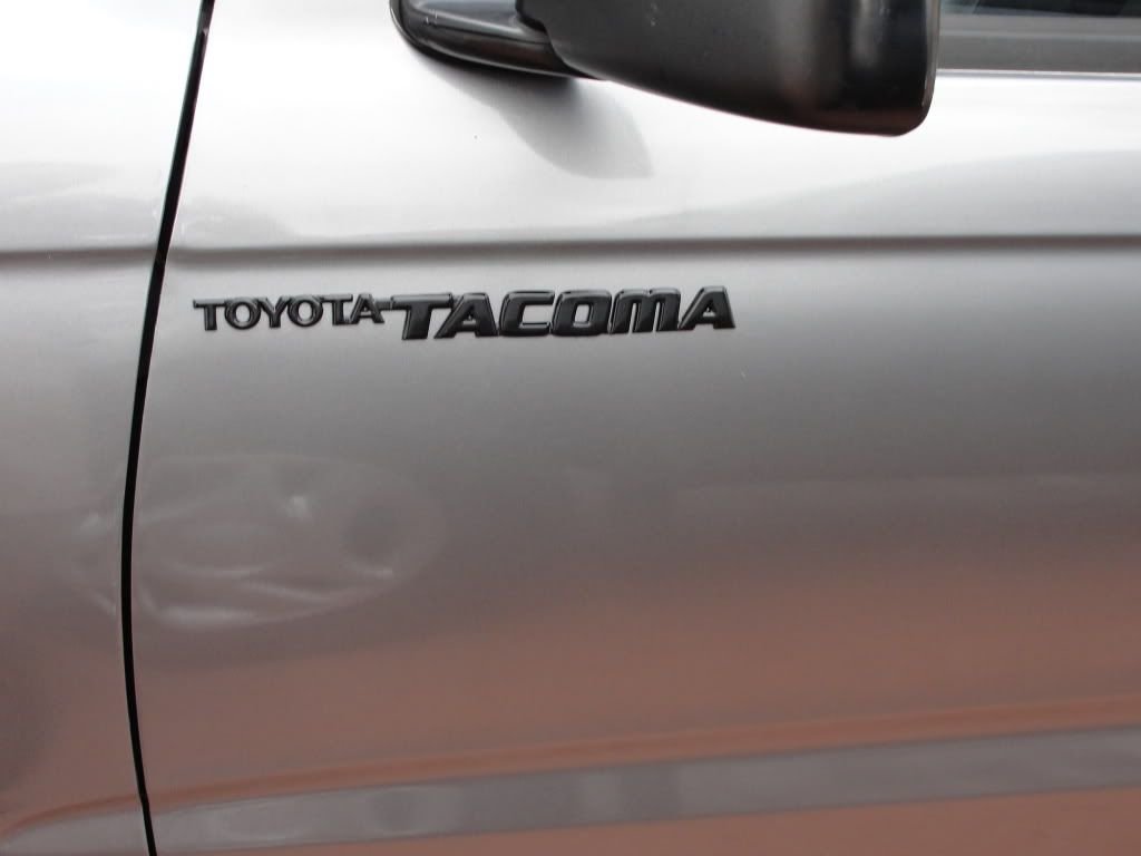

    I took advantage and used the excess paint in the gun for painting my front Toyota emblem along with the Tacoma emblems on the side. I made sure to sand the emblems then hit them with the same process as the rims- self etching primer, filler primer, then base and clear. I left the side ones off for awhile though, I was liking the smooth look.

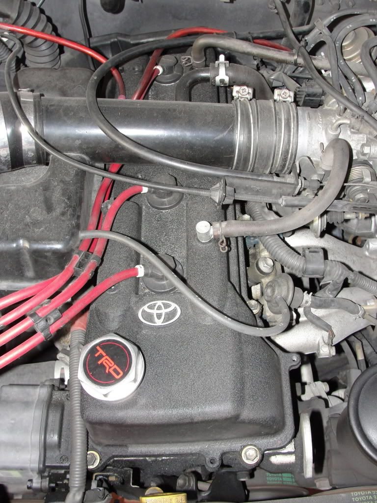

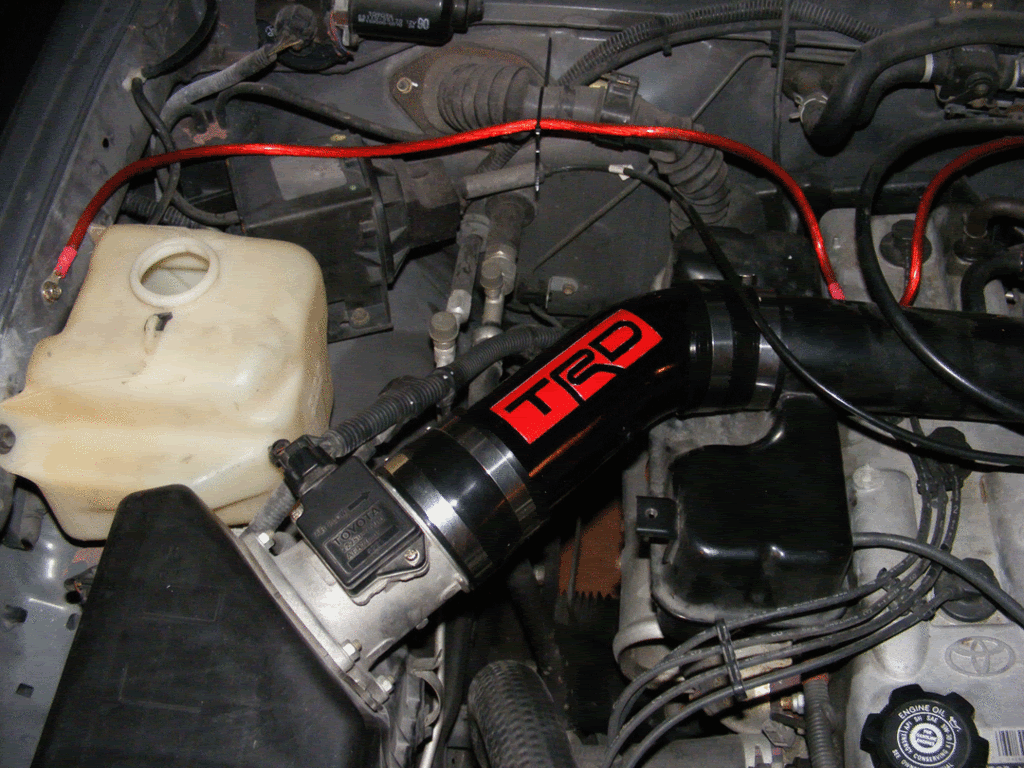

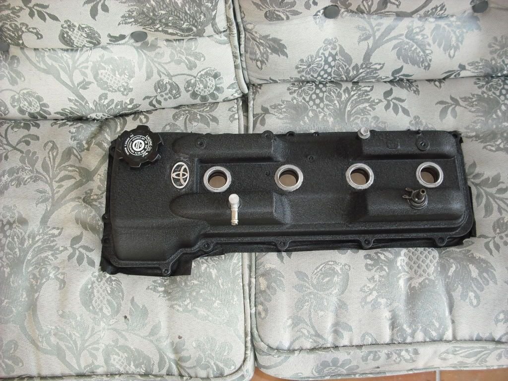

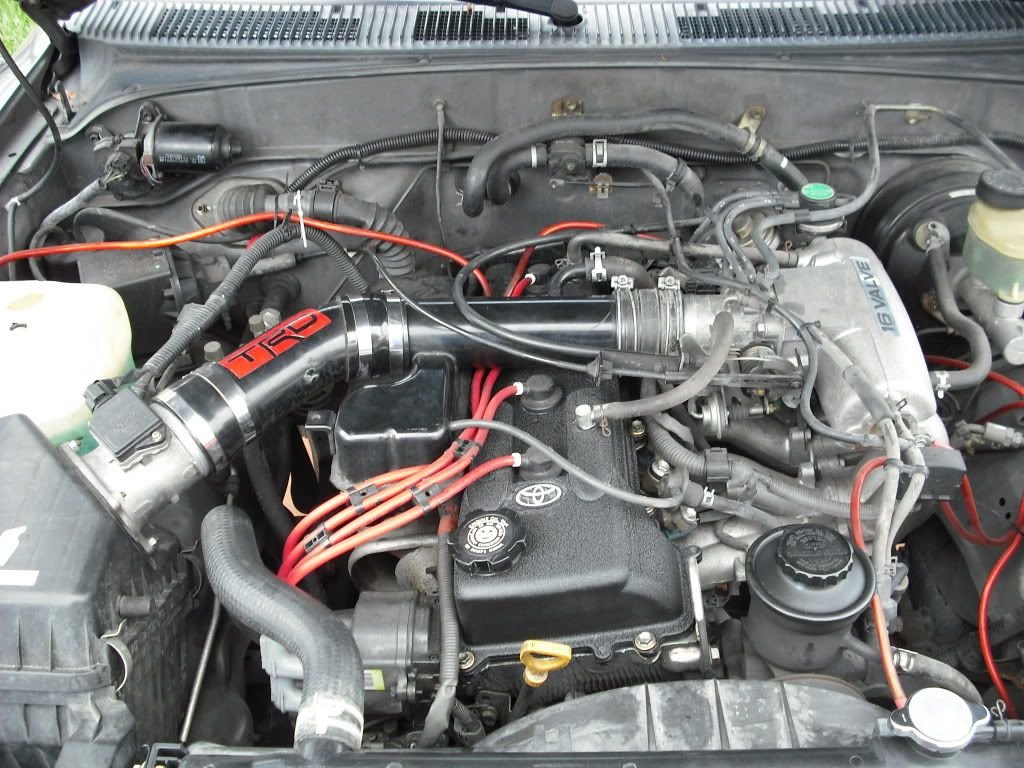

    Took some images of the engine with the TRD oil cap, my engine was quite dirty at that moment, that weekend was cleaning weekend.

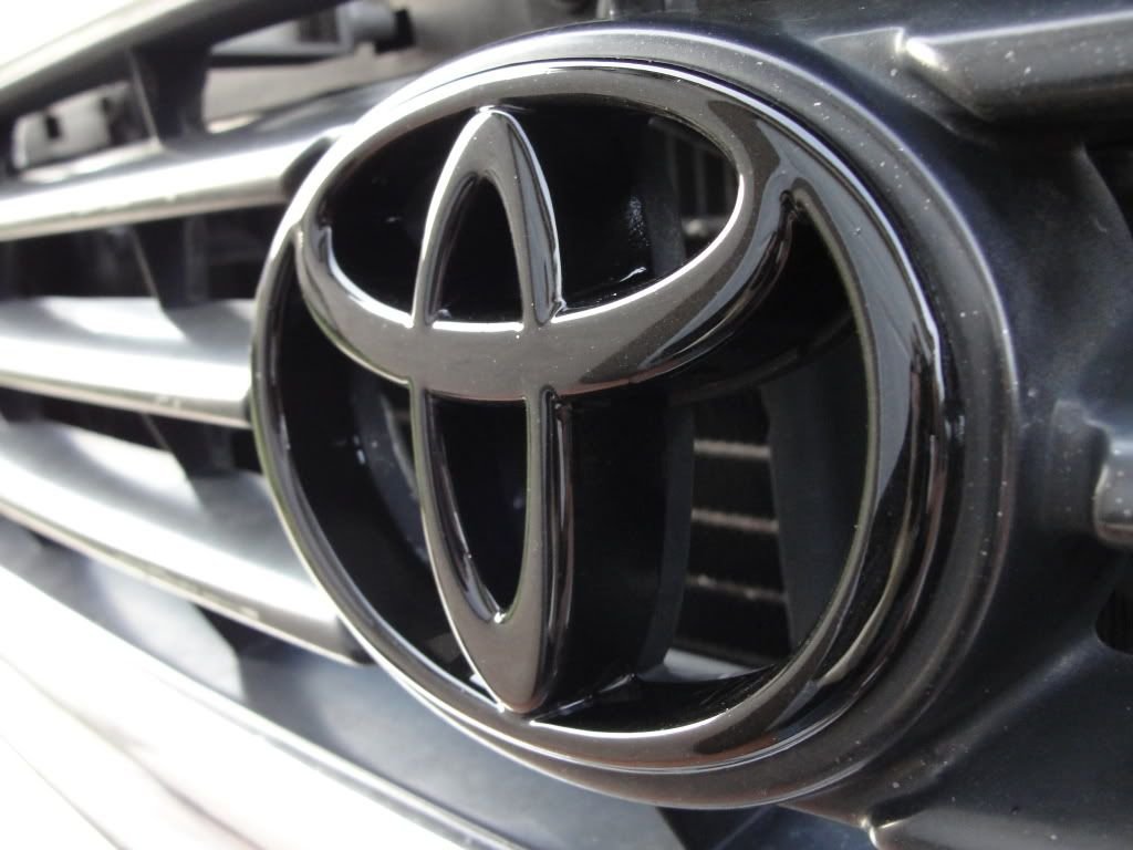

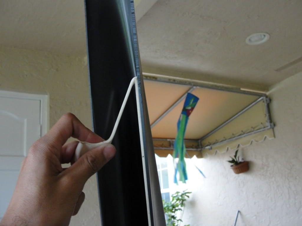

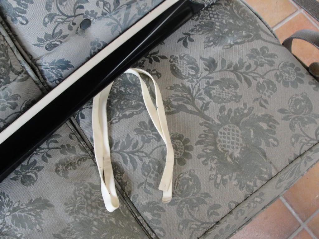

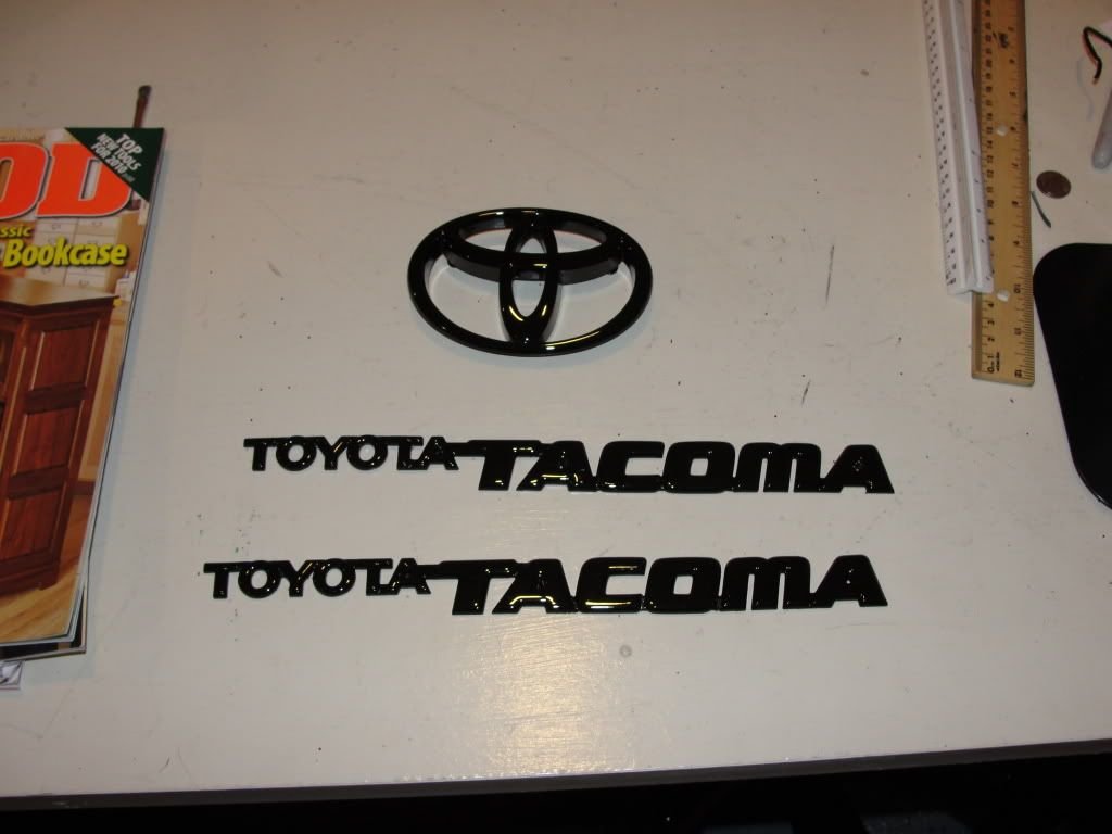

    1-23-2010 I added the blacked out emblems to the truck today. I used 3M emblem and trim adhesive and just smeared it lightly on the back of the emblems. It is much like pvc cement and it does the job pretty quickly- you just need to take an Xacto knife and clean the little bits of goop off the edges once it dries.

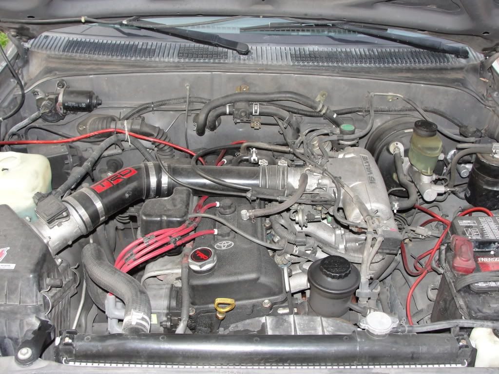

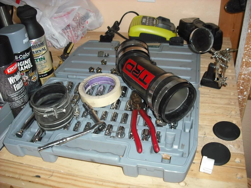

    3-09-2010 I did the elbow mod. I didn't take any pictures but basically the stock air box connects to the inner fender and you would assume the air comes from there. However, it is connected to a 90 degree elbow that in turn connects to a plastic tube between the inner and outer fender. This tube runs all the way back to the door area and breathes through there. If you decide to add a snorkel to your truck just drill a hole in the fender and add a pipe to that end and you're done! I simply took out the airbox and the piece bolted to the wall out. This piece is the one with the elbow and I cut the bend off on a bandsaw. I then replaced everything.I found it helpful to remove bolts on the outer side of the wheel well lining and pull the lining out such that I could access the gap between the inner and outer fender from below. From here I was able to see that the truck could now breathe air from the gap between the front bumper and the body as well as the whole area in front of the wheel.
    What the elbow mod basically does is that it allows your truck to breathe unrestricted as you rise in the power band. It does not turn your truck into a rocket, it is not a substitute for turbocharging and serious power mods, but it is a good way to let loose the potential of the stock setup. One thing alot of people don't understand about going fast is that you need to know the vehicles power band and how to make best use of it. The stock 2RZ-FE Tacoma's power band is between 3 and 5 thousand rpm. The truck starts pulling hard at 3k, it makes it's maximum torque at 4k, and it makes it's maximum horsepower at 5k. It is fastest if you make use of the power band in 2nd and 3rd gears. I did a pull after doing this mod and discovered that it basically opened up the "stuffed nose" if you will. When I would run to 5k rpm in 2nd and then pop in 3rd before, the truck would choke in 3rd and the nice acceleration you felt in 2nd would not continue. With the elbow mod, the fun continues all the way through 4th gear. I still have to try a few more runs before I can say definitively what the main differences are but this is the most immediate and obvious result.

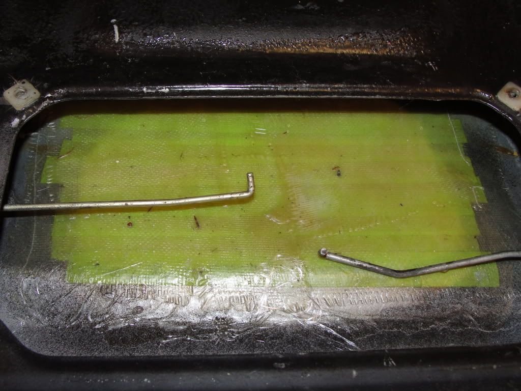

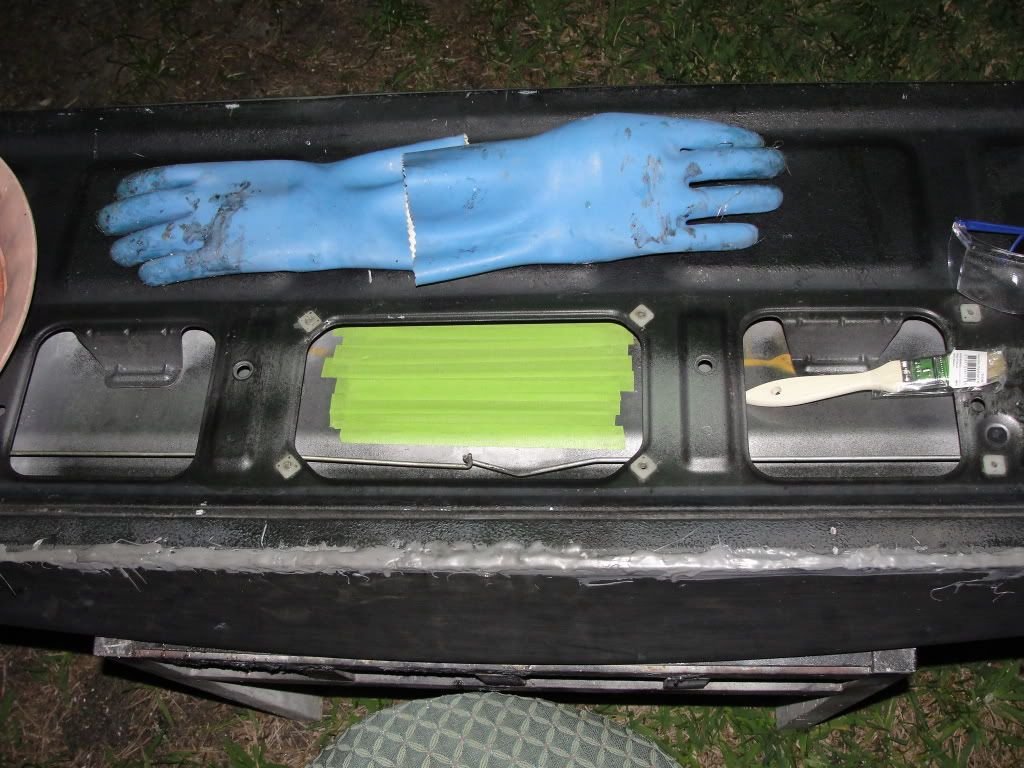

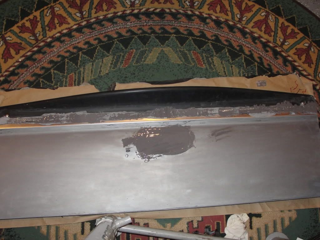

    5-02-2010 Just a few updates on the tailgate. I decided to shave my tailgate handle and invert the handle so that it is on the other side. Here are a few pictures of the progress
    Here is the hole taped off for fiberglassing from the inside.
    After fiberglass.
    Everything JB welded, I like it so much better than bondo!

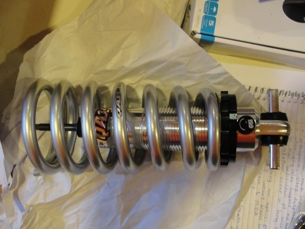

    Here's a preview of the QA1s I got from Luis. The box on the right of my tailgate on the above photo is the box they came in.

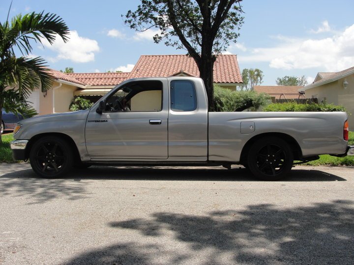

    5-26-2010 Dropped the back yesterday, pictures coming soon. I already bottomed out today and let me tell you it sucks, time for stiffer rear shocks lol! I may just install the QA1s, leave them high and remove the blocks in the back because my brother will be driving it over the summer. Funniest thing is when I was taking the truck off the jackstands; I had one out but the tire on that side still wasn't touching the floor, funny and scary all at once.

    6-11-2010 Here it is, on the QA1s . . . It was one heck of a way to start off Memorial Day weekend

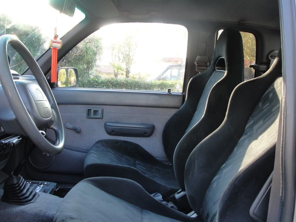

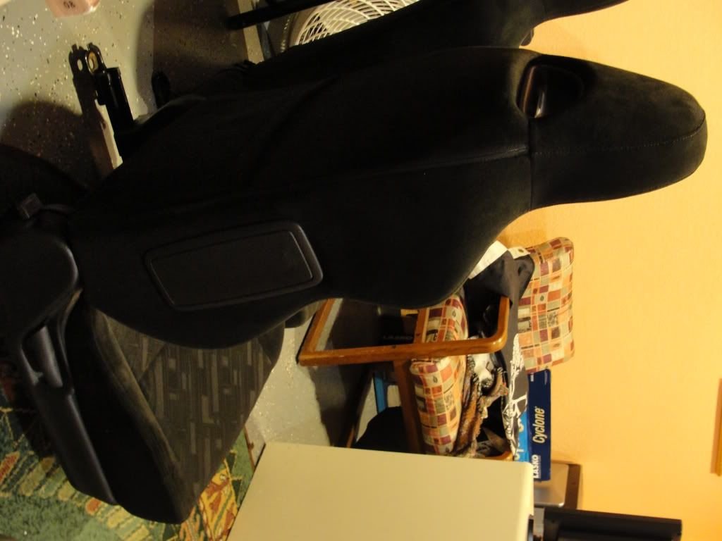

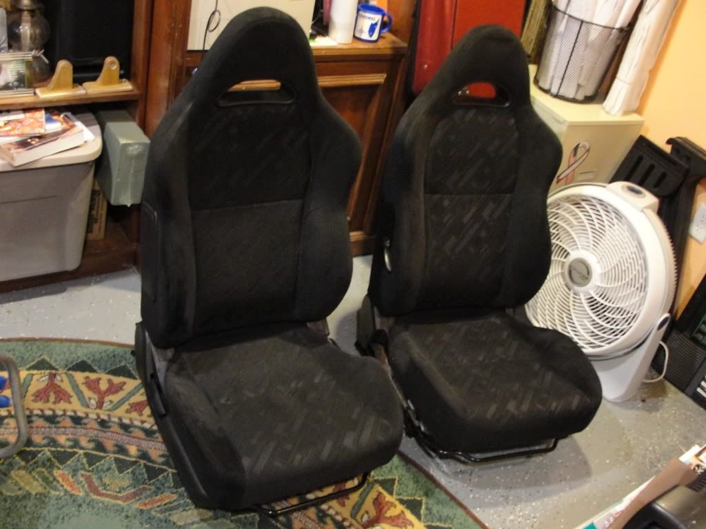

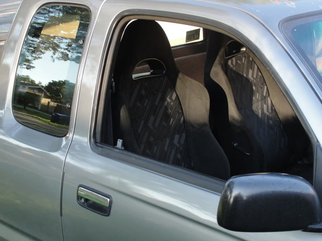

    10-04-2010 I ordered a set of black Acura RSX seats from ebay. They were $175 which is a good deal in my opinion. I'll have pictures and install information up soon.

    10-7-2010 Here is another little teaser. This is one thing I love about working on these little trucks, you get to do alot of "firsts" - First Tacoma with Lancer Evolution wheels, first 2wd Tacoma with RSX seats, who knows which other "firsts" may come along. When was the last time someone did a "first" on a Honda Civic?

    10-08-2010 They fit quite well.
