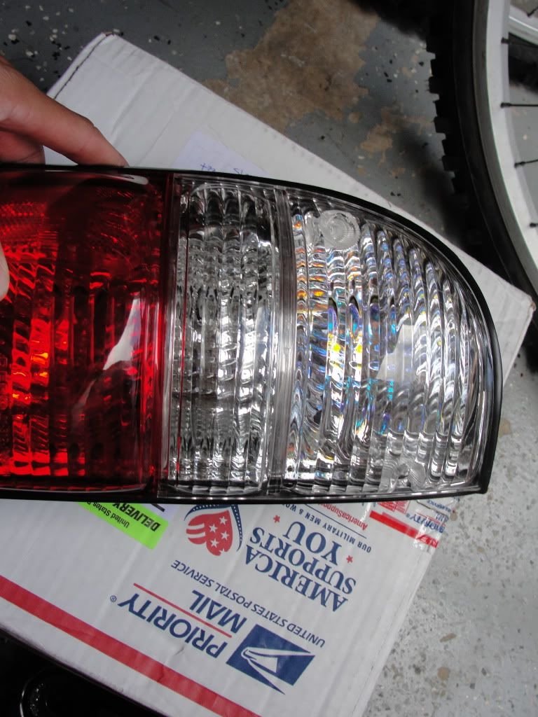

    My red and clear tails finally came this afternoon, post office "missent" them once they were already here in Miami. Big thanks to Jose/JDMHelix for the hookup:waytogo:

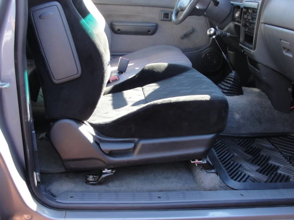

    Coilovers, sway bars, wheels, tires, extended studs, intake, head and taillights, seats, short shifter,

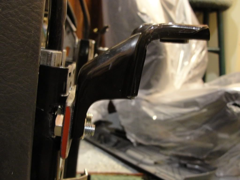

    11-06-2010 Well, I finally installed the RSX seats today. I did all the work to install one last night and then spent today doing the drivers side. I literally mean the whole day, from 11:00 am to 11:45 PM! I still need to make an extra piece for raising the outboard side of the driver's seat, I added a half inch thick spacer and it was not enough, the seat is leaned outward. Why couldn't Toyota just use a flat bar where the front of the seat mounts like everyone else? No! They just had to do some stupid slanted bar. I did take the truck for a spin and I have to say I hate how high the seats sit, it feels as if I never dropped my truck! I may end up making my own brackets from scratch in order to lower them some. It was a huge PITA to install these seats and I simply can't believe that there is still work left to do!

    11-07-2010 Didn't do anything with the seats today. I blocked up the outboard driver's side brackets 1/2 inch as I saw that was what VRacer (Customtacos member that pioneered the Celica seat swap into Tacomas) did but the seat leans outward. I will have to do 1" soon, it's killing me how high the seats are. I mean, the visibility is great and I still have good head room, not bad considering I'm 6'2." Besides this, the seats are awesome. They are exponentially more comfortable than the stock seats and they really hold you in place. You feel way more connected to the truck and it really shows in the corners. Another beautiful thing is that the bolt from the seatbelt buckle matches the thread for the buckle on the RSX seat so I was able to add my stock seat belt buckle without buying more hardware.

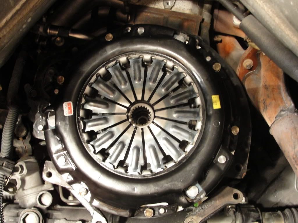

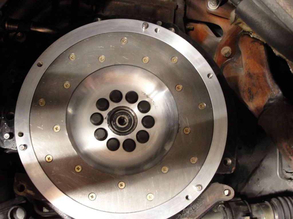

    12-17-2010 Finished getting my clutch and flywheel in a couple hours ago , pictures coming soon.
    12-19-2010 Going to have to redo the clutch installation, tomorrow's going to be a long day lol.
    12-21-2010 Well, my friend Javier came over yesterday and we took the transmission down again and re did the clutch installation. The pressure plate was warped just as Gadget (owner of Underdog Racing Development) said. I cleaned the holes for the dowels and we reinstalled the pressure plate, using quarter turn increments in order to tighten the pressure plate down. It was not possible to do half turns as there was not enough room under there, however quarter turns work the same- they just take twice as long to do.
    Big thanks to Gadget for his awesome customer service and his willingness to help. I would have never figured it out without him. Who else do you know that will take your phone call at 8:30 PM on a Sunday night? I can't thank you enough Gadget! The truck is running great, no shaking or clutch chatter whatsoever. The new clutch is rougher at engagement than the stock, but that's to be expected.

    The old stuff
    New Flywheel installed
    New clutch installed (this was taken the first time I installed it)

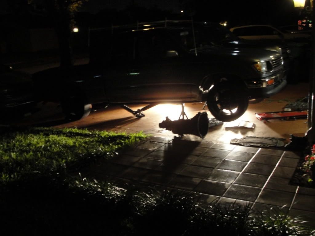

  7. Mar 12, 2021 at 10:02 AM
    #27
    MatosTaco
    MatosTaco [OP] Well-Known Member
    Feb 17, 2021
    #356462
    544
    96 Toyota Tacoma

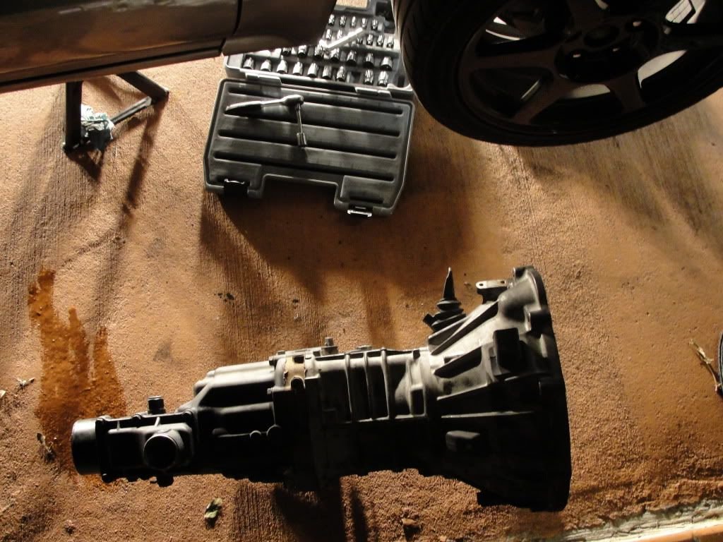

    Trans out of the truck
    Closeup

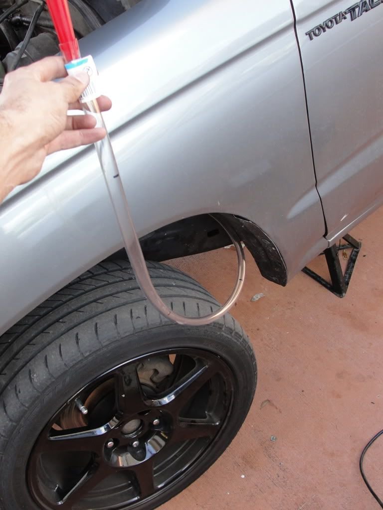

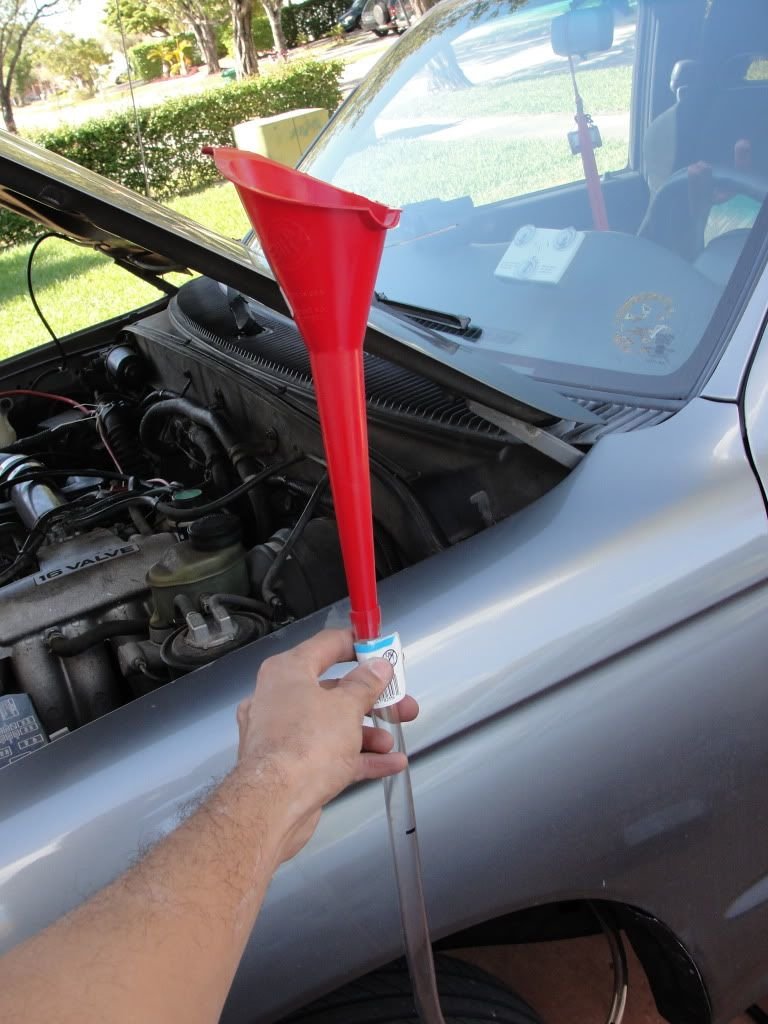

    Method of adding transmission fluid
    Caught the lunar eclipse
    Biscuits likes this.

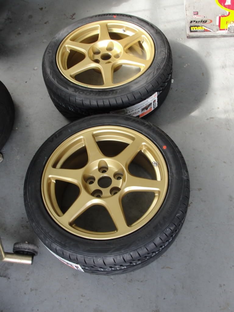

  9. Mar 12, 2021 at 10:03 AM
    #29
    MatosTaco
    Feb 17, 2021
    #356462
    544
    96 Toyota Tacoma

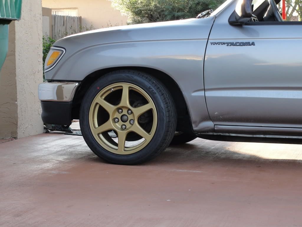

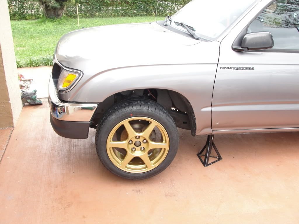

    1-24-2011 Gold/Bronze powder coated wheels. Pictures coming tomorrow.
    1-26-2011 Here they are, the powder color is "bronze" but it is the color of fresh bronze, the more copper like color that comes to mind when people hear the word is aged bronze if I am not mistaken.

    1-26-2011 Finally Mounting them after having the truck on stands for two weeks, ouch.
    A shot later on in the day, it was gloomy out so the color of the wheels didn't look as bright
    Time to drop the truck some more, the front is ready to go, the rear will need more mods.

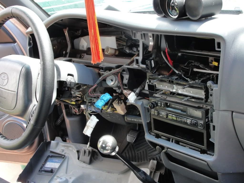

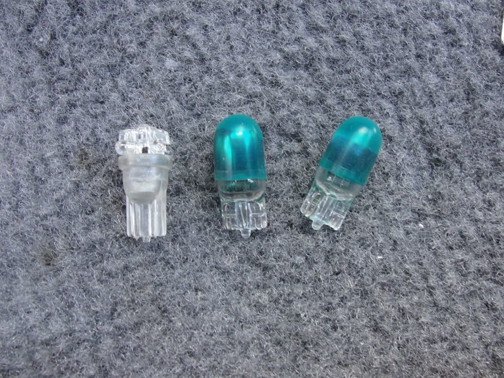

    1-30-2011 Took advantage of my day off and brought the front down another half inch. Once I get the four link (I know you'll get it done Beefy!) and some rear coilovers, I'll bring the front down the last half inch that the QA1s will allow. I'm loving how it looks now.
  12. Mar 12, 2021 at 10:05 AM
    #32
    MatosTaco
    Feb 17, 2021
    #356462
    544
    96 Toyota Tacoma

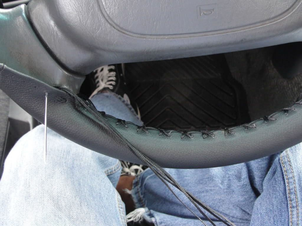

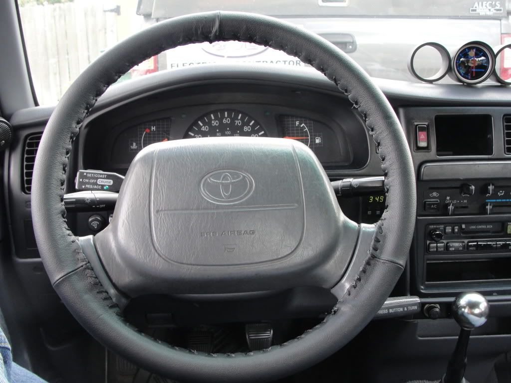

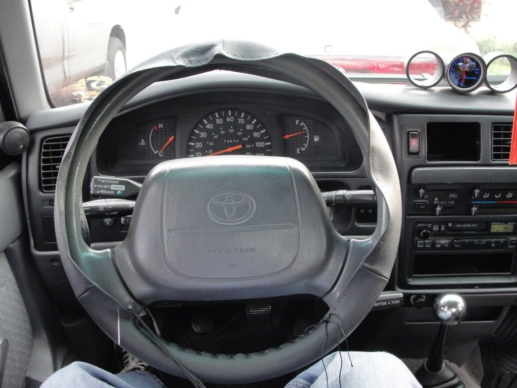

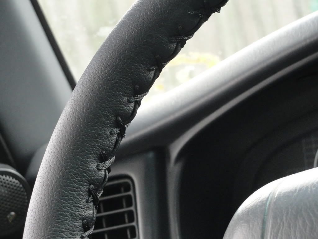

    2-18-2011 I wrapped my steering wheel in leather. I'm loving the new look and feel of my steering wheel, no more ugly cracked surface. It took a while to do and I got stabbed in the fingers by the huge sewing needles that came with the wrap, but it was well worth it.
  13. Mar 12, 2021 at 10:06 AM
    #33
    MatosTaco
    Feb 17, 2021
    #356462
    544
    96 Toyota Tacoma

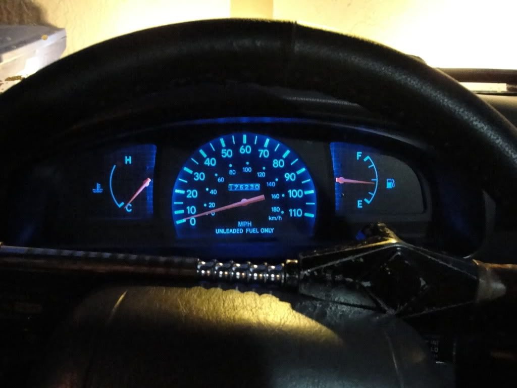

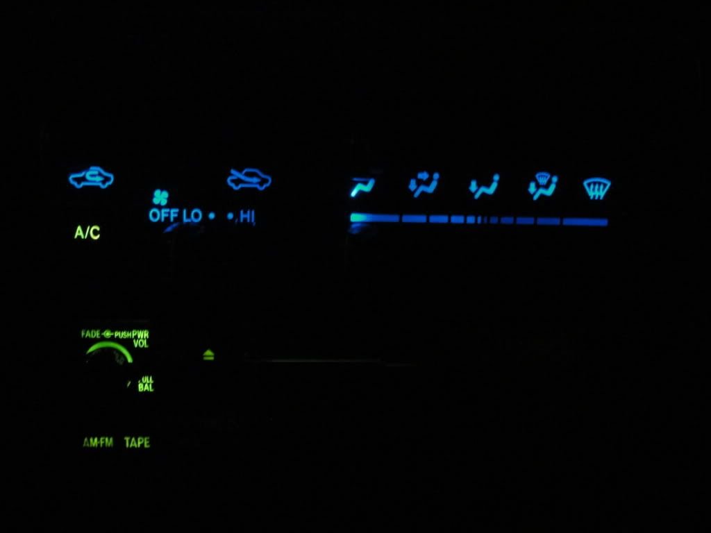

    3-21-2011 Got a few mods coming up this weekend. The SRunner rear sway bar is hopefully coming on (the brackets are back- ordered) along with full interior LEDs, blue for the dash and bright white for the dome light.

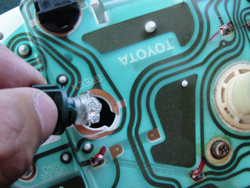

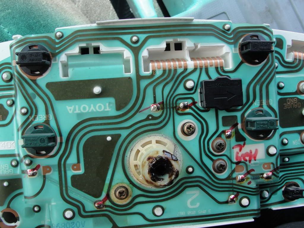

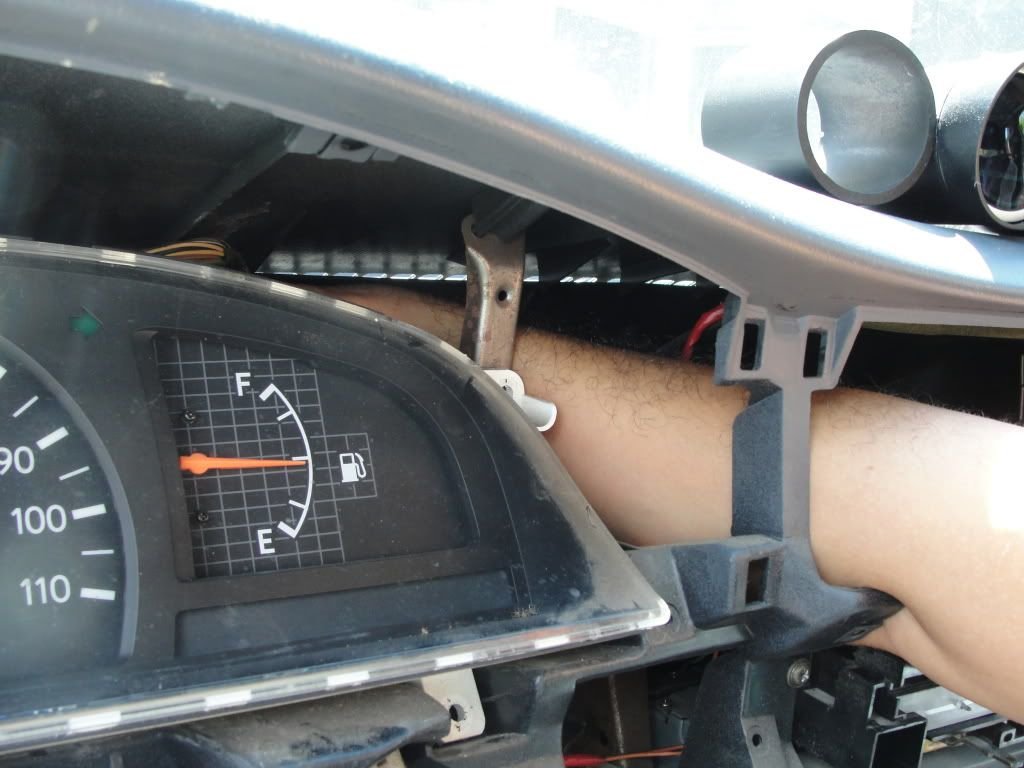

    4-01-2011 Alright here it goes . . . I took the center console out and then removed the panel around the ignition. I then followed the dash take apart instructions in the tech section(of customtacos.com). It isn't mentioned there, but I highly recommend you take out the plastic cover around the steering column in order to make it easier to take the panel around the gauge cluster out. The left side A/C vent has a 90 degree elbow which makes removal of that part a pain if you don't remove the column cover.
    With that done, just remove the cluster. If you have an older Tacoma like mine, it will have a mechanical speedometer so you will feel a pop as you pull the cluster out, don't despair. This is just the mechanical connection popping out.
    Take out the stock lights according to the instructions in the tech and put in the new LEDs. The ones for the cluster are two #194 wedge base bulbs. On my dash, there is only one LED in the A/C panel, a #74 wedge base bulb.
    I plugged in the gauge cluster harnesses and the dimmer harness in order to test out the bulbs, mine were not polarized so this step was more out of curiosity/ double checking just to make sure- it would have sucked to put that dash back together and find out the bulbs were in wrong. From here, everything comes back together the same way it went in. However, in order to reconnect the speedometer you need to stick your right arm through the center opening and push the end inside the dash into the back of the cluster- it is pretty much impossible to do otherwise.
    Now simply enjoy the new dash. The 5- LED bulbs I chose are a nice blue, blue and orange are complementary colors so the lights really make the orange needles pop. Pictures do not do it justice, it is way nicer in person. I now need a new radio as the green from it detracts from the overall effect.
    This took all of 20 min to complete, followed by hours of waiting for night to come so I could see the effect.

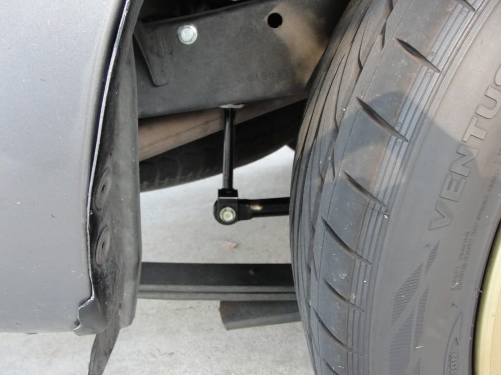

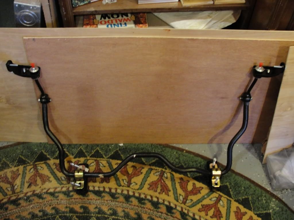

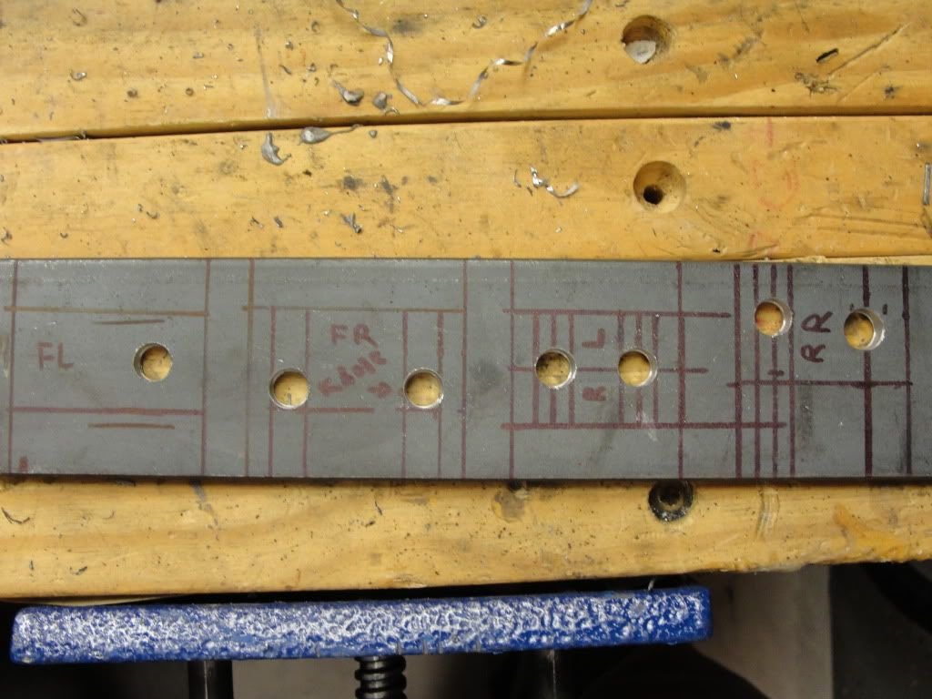

    4-02-2011 The SR rear sway bar went in yesterday. Hellwig only sent me the shackles, guess they didn't understand I also needed the U bolts lol, so I got some from Home Depot. They are temporary until I upgrade or weld the shackles to the axle but they get the job done. I took the truck for a spin and found that the rear end definitely comes out more and the truck has more bite when it turns in. However, My front tires are now rubbing the fender liner and the fender itself when I corner hard. Time for some good old fashioned fender rolling.

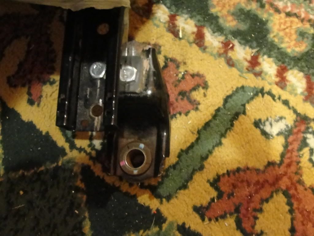

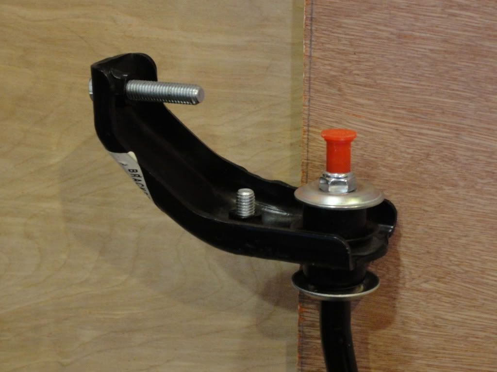

    4-08-2011 This is what the Toyota brackets for the SRunner sway bar look like
    This is the sway bar with all the necessary bolts and brackets assembled to it

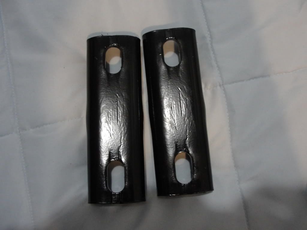

    These are the Hellwig shackles for the axle, had I known how they looked I would have saved time and money by making my own from some square tube.
    Here it is under my truck
    Here is a side view

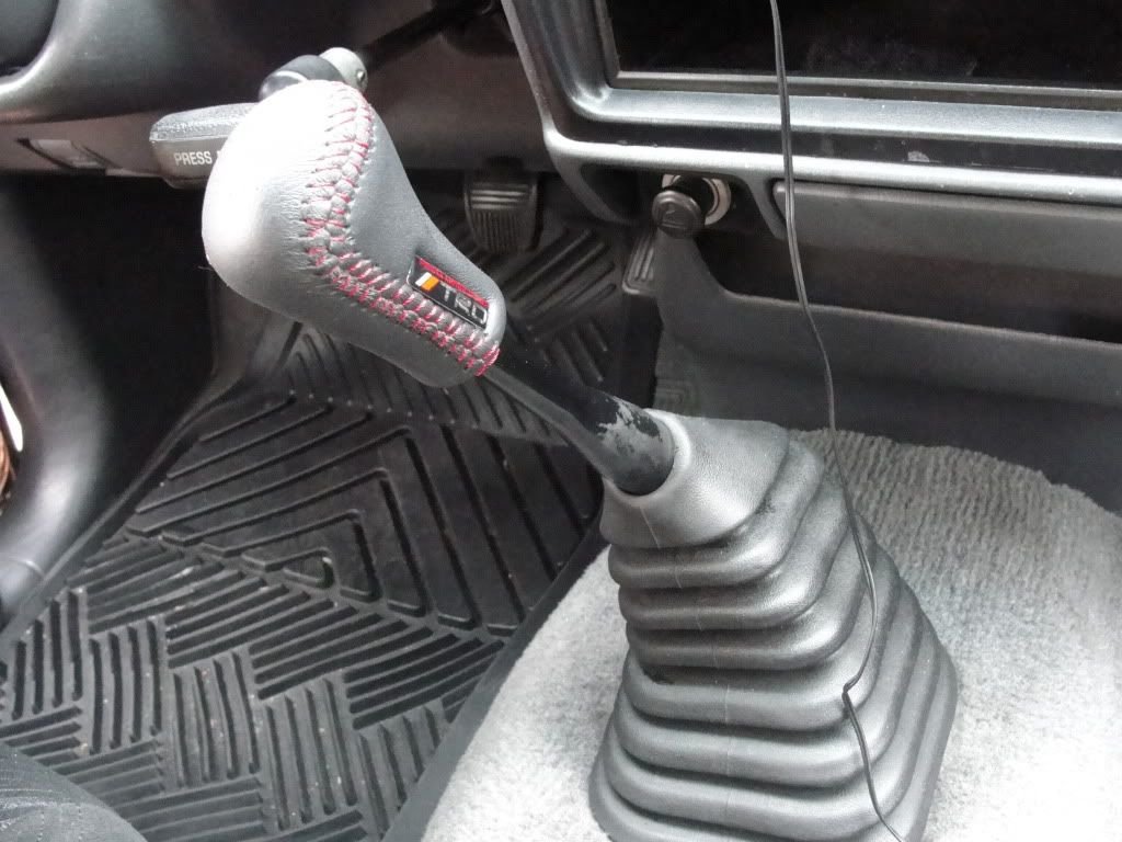

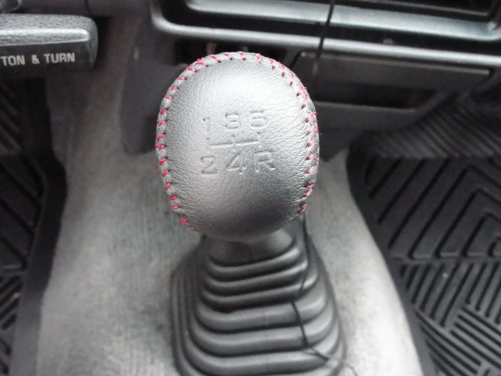

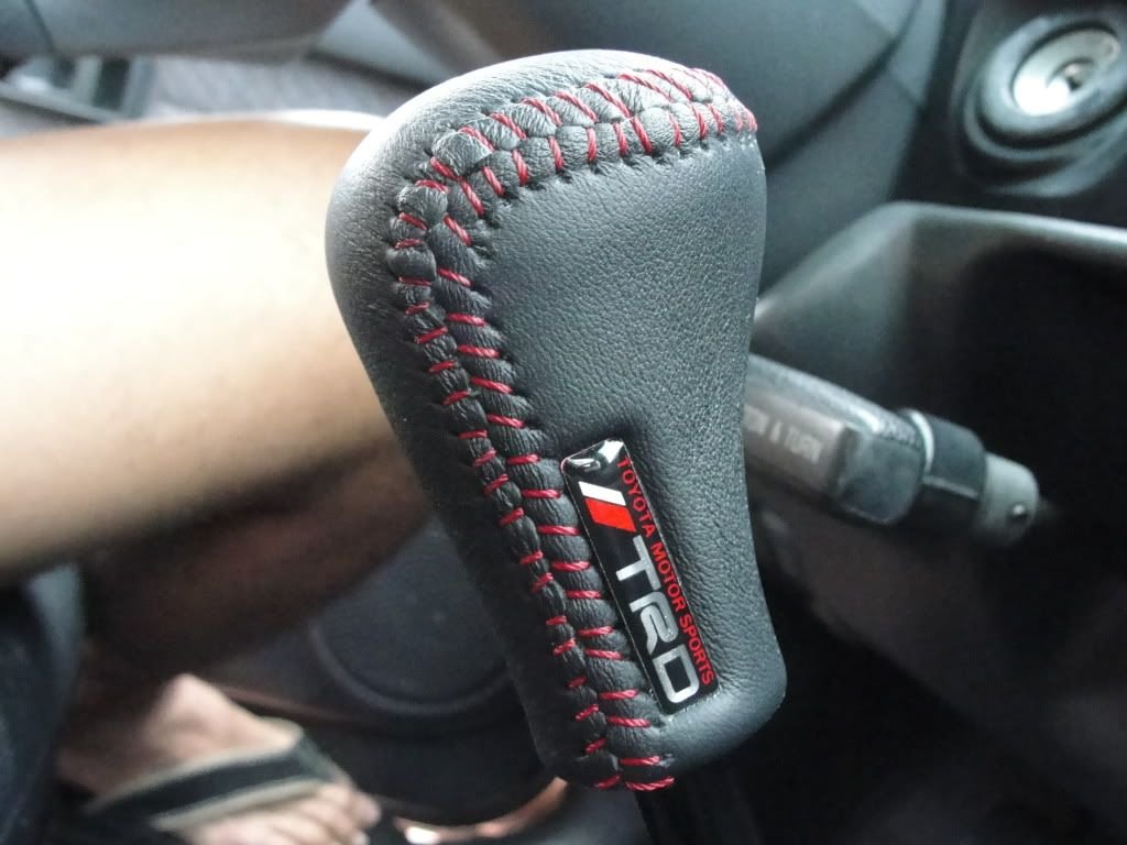

    8-19-2011 I came back (from an internship) and found my brother got me a TRD shift knob for my birthday! Score! Unfortunately, the internal seals on my brake master cylinder were out. I initially thought I just had air in the lines so my friend Javi came over and we bled the lines, only to find that nothing improved. Upon removing the cylinder, I found that one of the seals for the rear brakes was blown so I picked up another master cylinder at the auto parts(no one seems to sell rebuild kits) for $77 and put the internals from that into the Toyota one. Unfortunately, I did not notice the inside walls were roughed up. So upon bleeding the brakes, they were good for awhile when suddenly, the pedal dropped. We took the thing apart, realized the walls were the problem and had blown the seal in the same position. So we swapped some good seals from the Toyota internals and put them into the new cylinder and installed that. Bled the brakes AGAIN, and the problem was solved. The truck brakes better than ever. Should have just installed the new cylinder to begin with. A warning to you guys, the factory brake master cylinder costs $295 at Toyota, this is insane- don't even bother with them. The $77 A1 Cardone from the autoparts works perfectly.

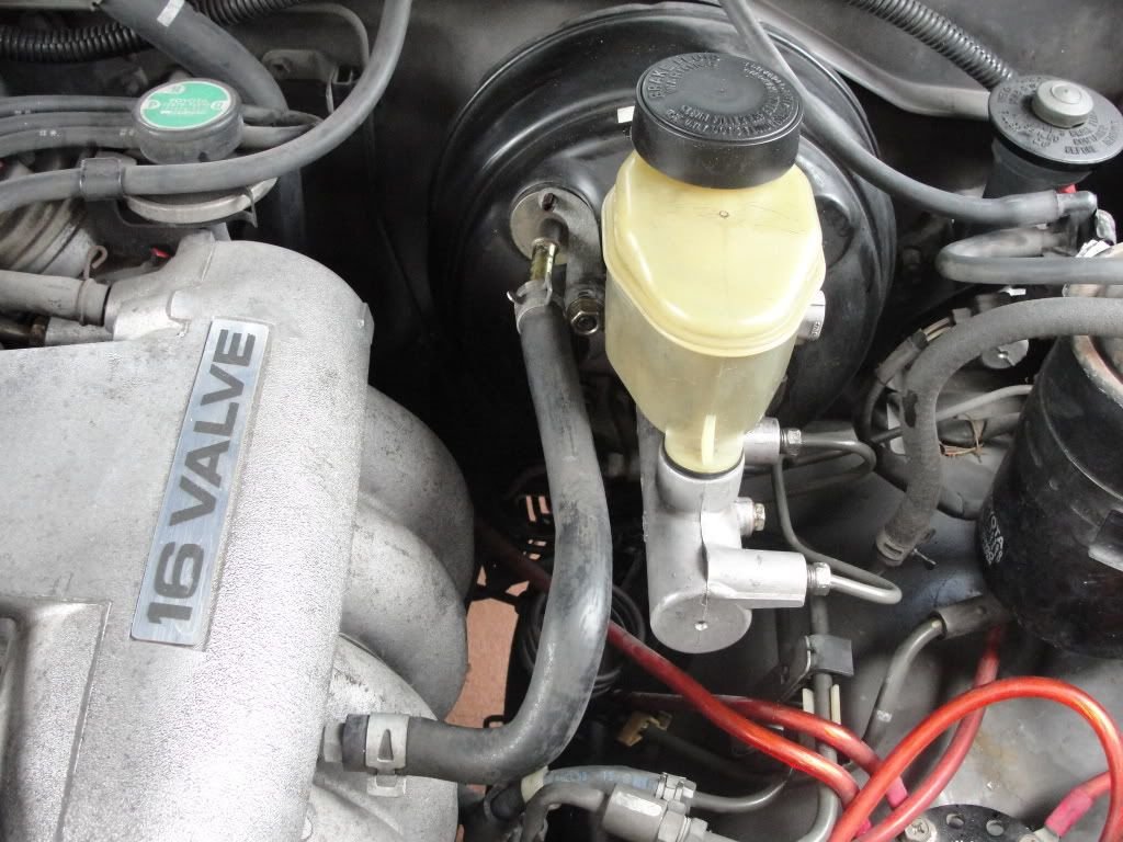

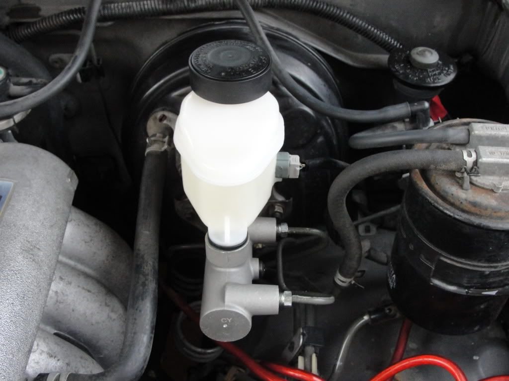

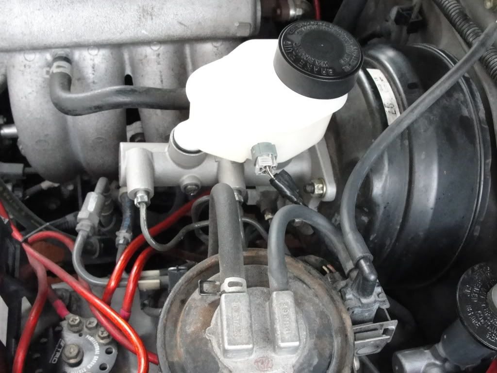

    Gross looking reservoir, the fluid was disgusting too, it had clearly broken down and absorbed water
    Here is the new cylinder and reservoir in place

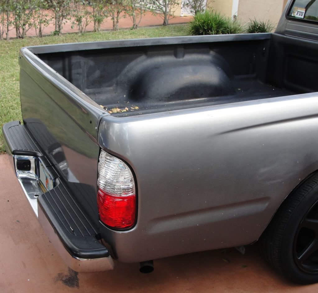

    Yet another gratuitous shot of the Taco, I was hoping to come back to the Sunshine State, only to find nonstop rain!

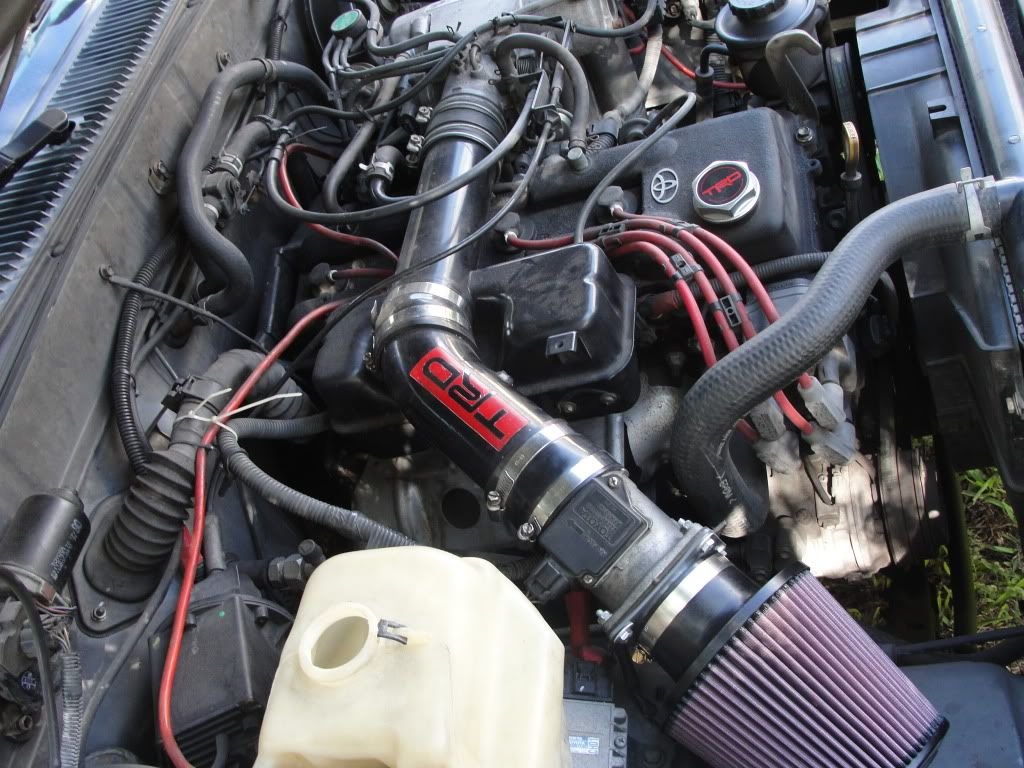

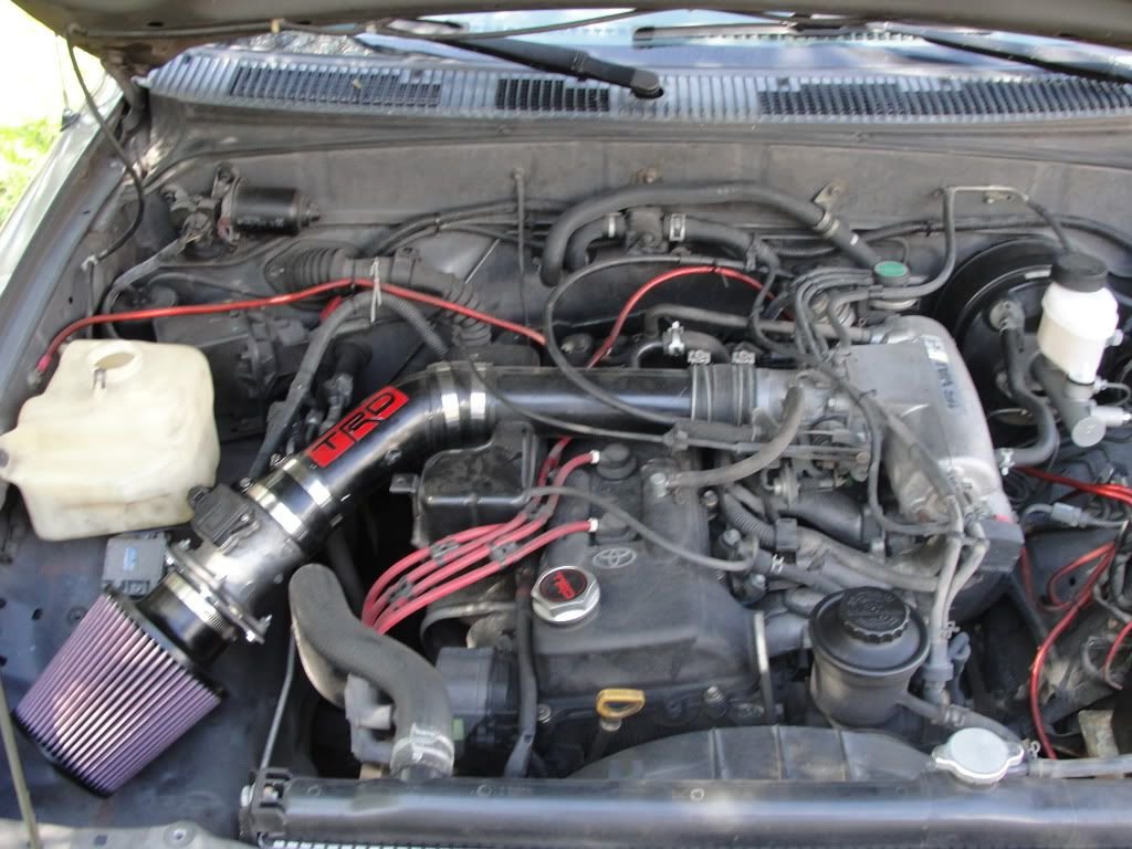

    9-19-2011 I replaced my airbox with a K&N cone filter this weekend. So far I have put over 80 miles on it and I notice that the engine warms up to operating temperature much faster than before which makes sense since it is now drinking warm air from the engine bay. I cannot comment on gas mileage just yet because I have not finished a tank. I would love to get a scangauge and monitor fuel consumption more properly. I have the IAT sensor sitting below the filter so it reads the intake temp decently.
    Yes, I know I have no cap on the washer fluid lol. Anyone care to donate one?
