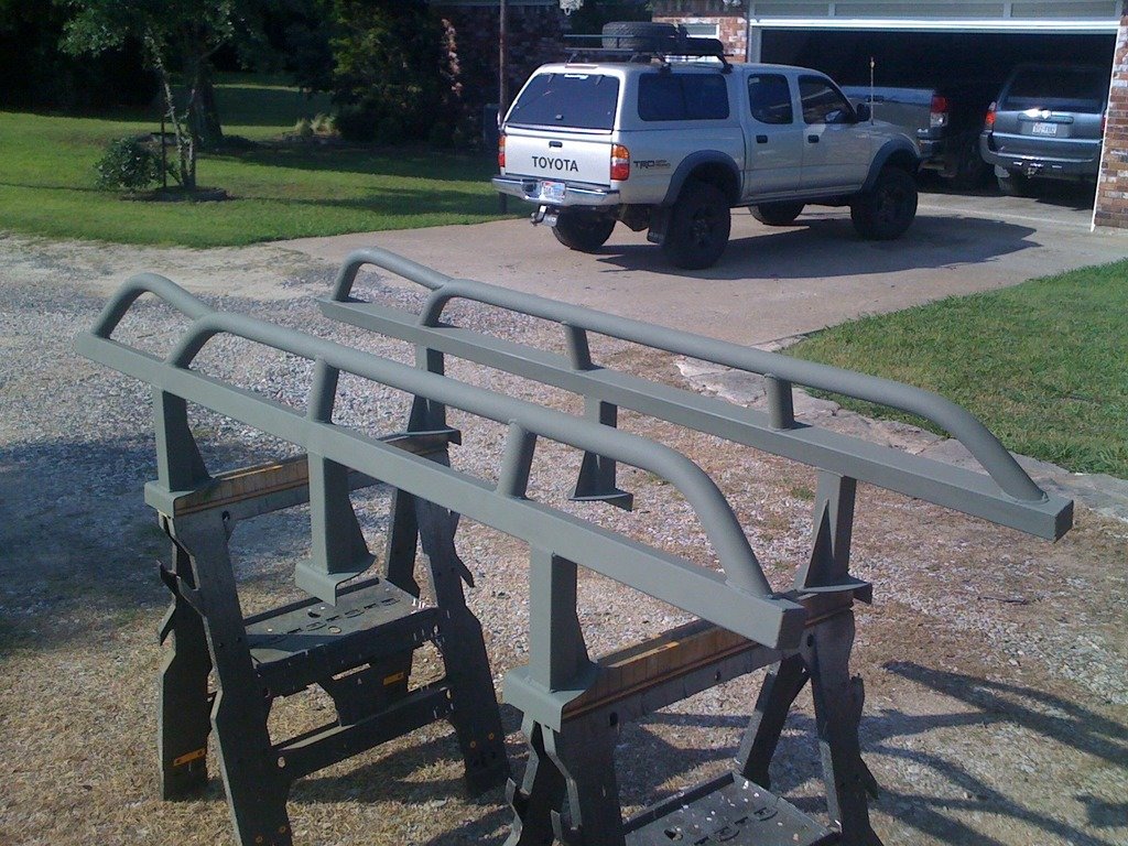

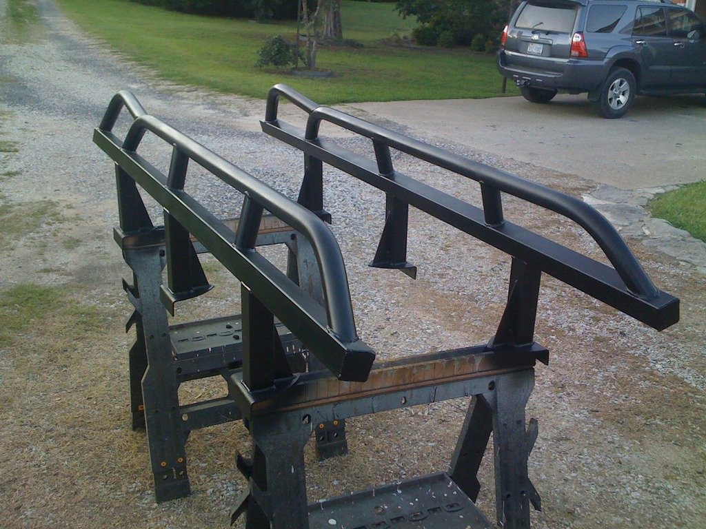

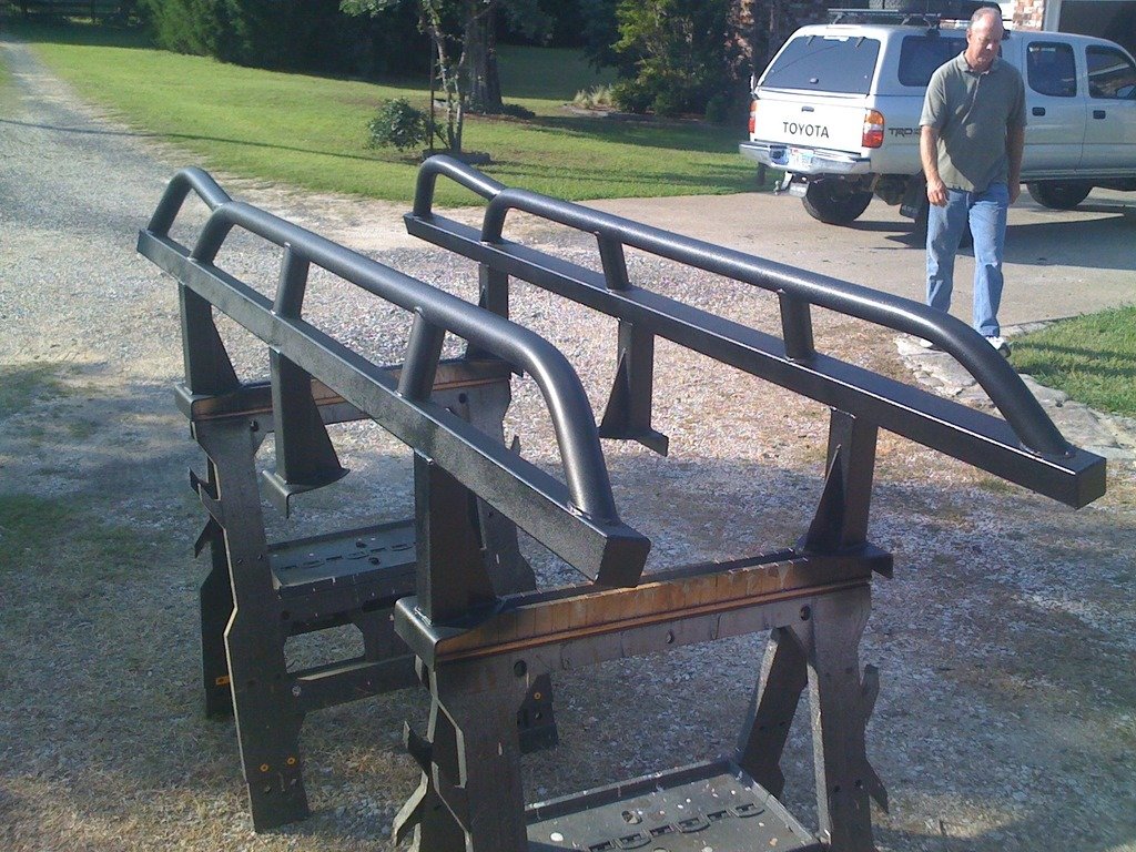

    I love these SOS sliders. I like how the kickout isn't too giant, but still adds some character to them. Big thanks to Eddy and Phoenix for helping me be able to finally get some sliders on the truck!
    About to scuff them with a wire wheel and wipe them with acetone.
    Painted the sliders with self etching primer
    Rustoleum bed liner
    Satin black
    Tada!

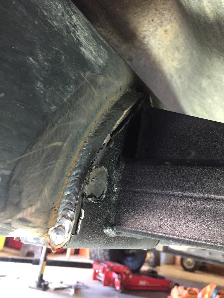

    In the process of welding them, I caught myself on fire twice, ruining two shirts! Then I started laying under the welding blanket.
    Here's my best weld on them. Not too bad for my second welding project! (Just don't look at the other welds;))

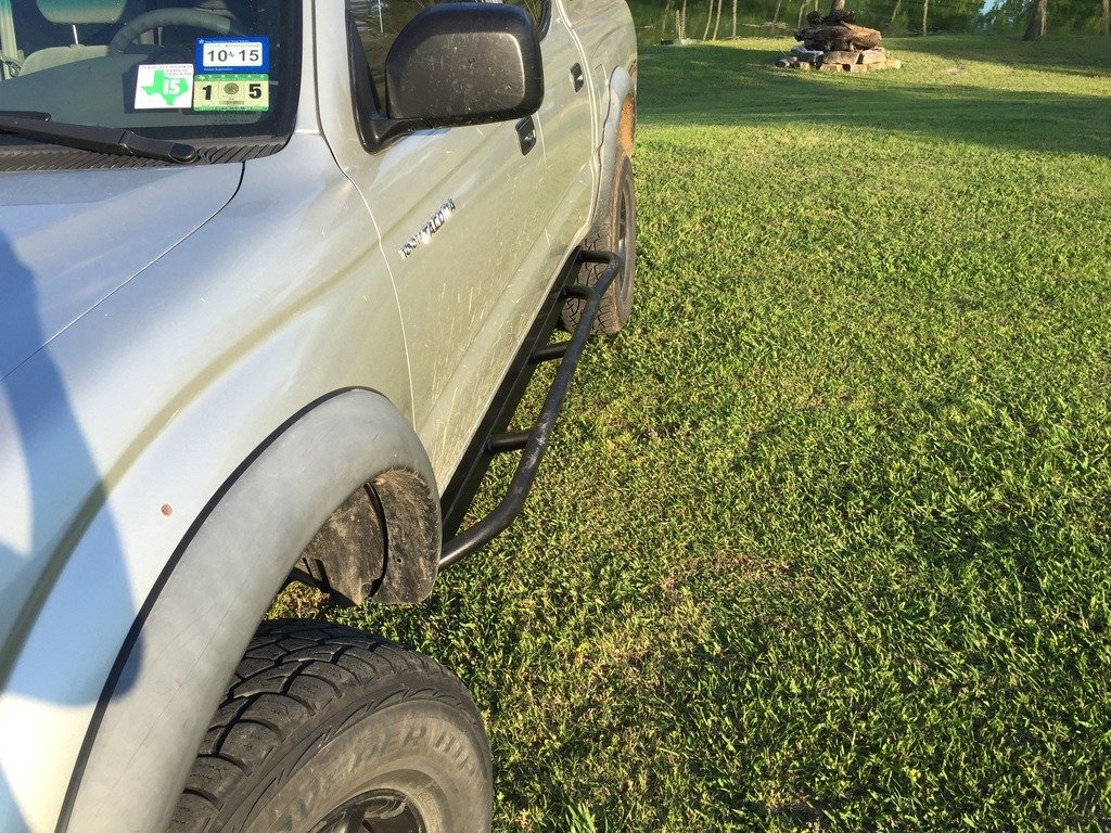

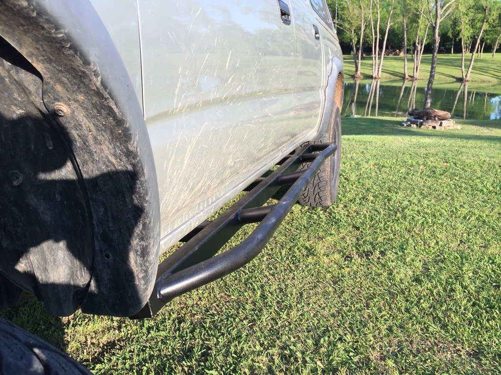

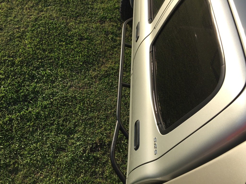

    Much more difficult. They WILL rub the back of your calf, so you better make sure they are clean before you try to wear a suit or nice pants. I took that picture looking straight down in order to show how far they stick out.

    Yeah, thats what I thought. When I mocked up mine I ran into the same thing.
  9. May 3, 2015 at 7:11 PM
    #369
    MatthewMay1
    MatthewMay1 [OP] I'm an amateur professional.
    Nov 21, 2011
    #67486
    11,091
    Matthew
    Lone Star Republic
    Supercharged '01 TRD
    Can't really use them as steps either, since they are angled up, you end up stepping higher than you need to to get in the truck.

    Hmm, I'm confused. The sliders are still lower than the floor of the truck, otherwise you wouldn't be able to open your doors. I use mine as steps all the time because it's easier than stepping 3" higher onto the floor. Plus that keeps me from ever getting mud or dirt on me from the sliders :notsure:

    Depends how tall you are I think. For me stepping on them would get me to high and then i'd have to bend way down in order to get in the truck, easier just to step over those

    Exactly. If I step on them, I have to bend way down to get in the seat. It's more difficult than just stepping over them
