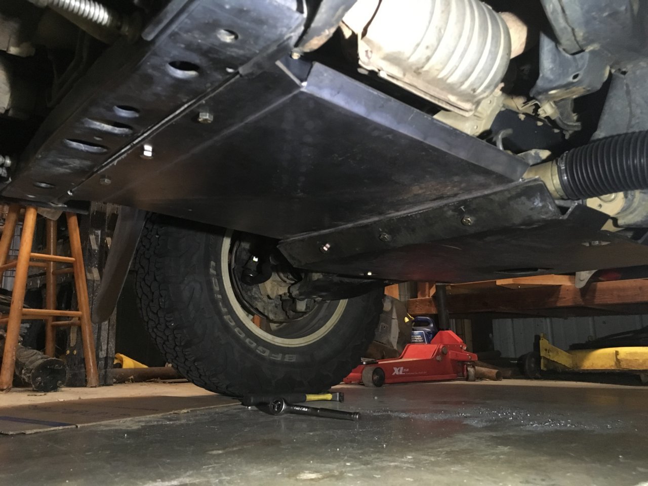

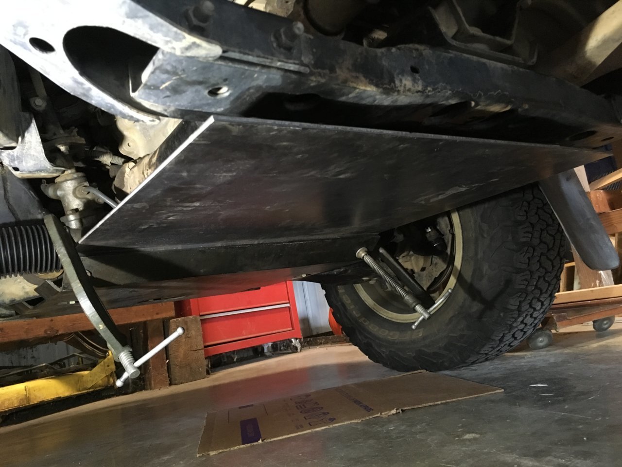

    Transmission skid is complete and painted. I welded angle iron in an X on the top side as a reinforcement. Snagged one pic before paint...

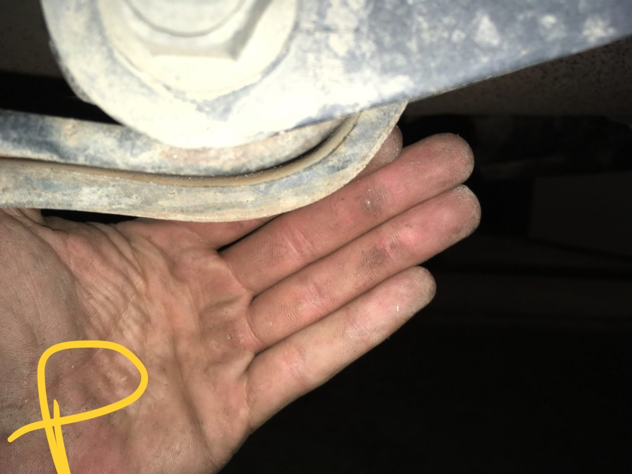

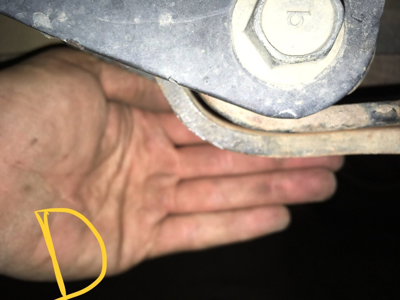

    I had a late night in the shop tonight wrestling with my leaf springs. Hours and many strings of profanity later, I have it all back together and closed the gap that we spotted while coming back from Colorado on my driver side between the main leaf and the second leaf that wraps around. I don’t have a before photo, but on the driver side, the 2nd leaf (and I presume all leafs below it) was shifted forward a bit and we suspected that was the reason for my steering to be slightly off and my truck driving crooked down the highway. I managed to get it pretty dang close and I’ll be replacing these worn out leaf packs eventually anyway.
    63D21797-B576-43DC-9F65-D9E964C11545.jpg CDA1062A-3A66-41F2-BC3D-69524C2124D5.jpg
    Hopefully, this will make the truck drive straighter. Can’t test it until I get a new fan clutch in of course.
