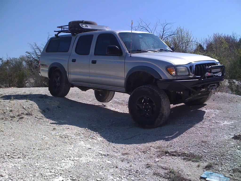

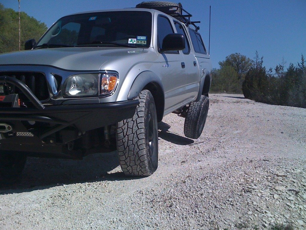

    Found another place to wheel my truck. I think my shocks may be limiting my travel. I'll post pics later when I get back from my flight. Got my truck to teeter on 2 wheels!

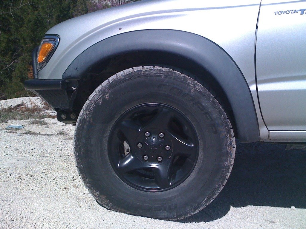

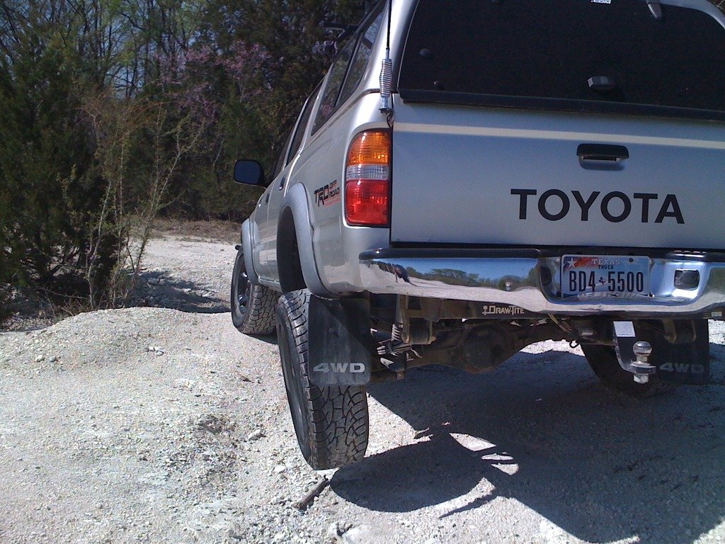

    Experimenting to see what I would need to do to fit 255/85's...
    Who says IFS can't flex?

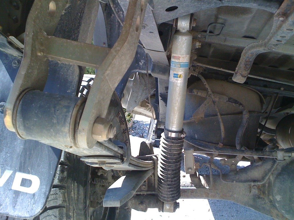

    Lifted a tire! If the axle won't flex any more without touching the bump stops, what would be ideal for me to do?
    Also tested my approach angle. Didn't hit!

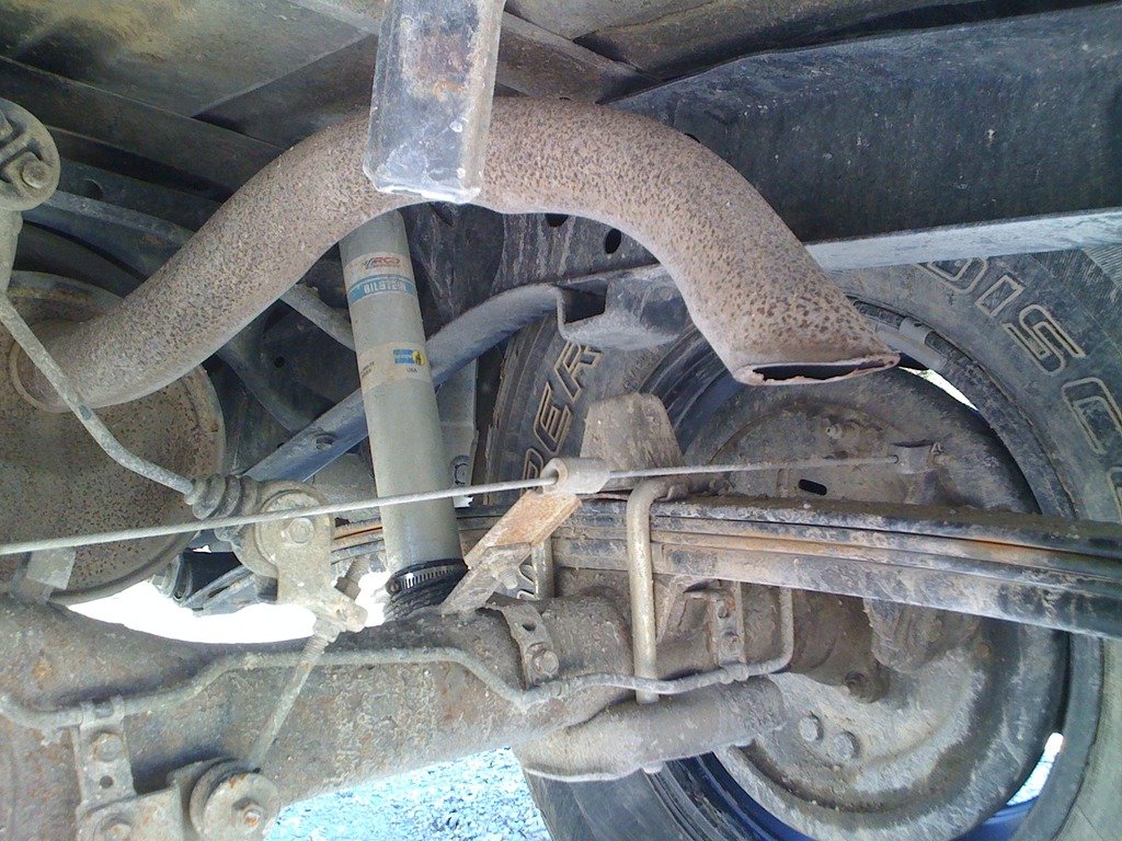

    Shock relocation time :spy:

    That would get you more travel in the rear, i think. Its what Dakota and I are doing

    Don't think so, I know for us 2nd gens we use 12" travel shocks which is like twice the length of my current ones, i'd call Jerry at BAMF and ask what shocks are best, I know he makes a first gen shock relocation

    Hell yeah ^ your shock is limited the travel. The point of the shock relocation is to move the upper mount up to account for your new longer shock.

    If your shock is limiting your travel then no the only thing to get more travel is a shock relocation.

    What he said. You can't put in the longer shock without the relocation because the new shock will bottom out early. As shock travel increases its a compromise between extension and compression. As you go up 2" in travel numbers you usually end up with a 2" longer compression number and a 4" longer extension number.
