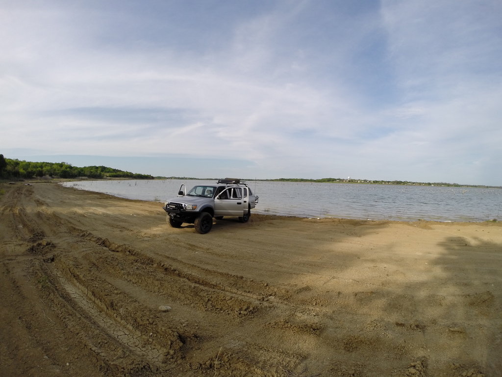

    Nothing better than spending the afternoon on the lake!

    Yur terco ers serxy
