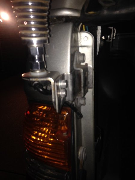

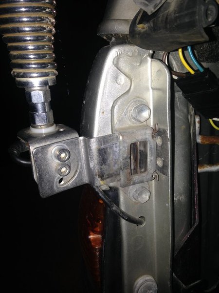

    Do you have a picture of how that CB mount is attached to the sidewall of the tailgate light area? I just want to see what kind of holes I'm gonna need to make.

    No holes needed. I bolted the tailgate latch around it. I'll get a pic here in a minute

    That'd be awesome, I wasn't sure if there would be enough clearance if it went under the latch. Looking forward to the pics! :)

    @Speedytech7 Here's some photos. It does make the gate harder to open and close, but I bet you could just grind off a little of the mount to thin it up a bit.

    Oh, that's not at all what I had pictured. Thanks for the picture, it makes more sense now. Well I am going to buy the mount now, no point in letting the CB and antenna I got just sit around unused.
