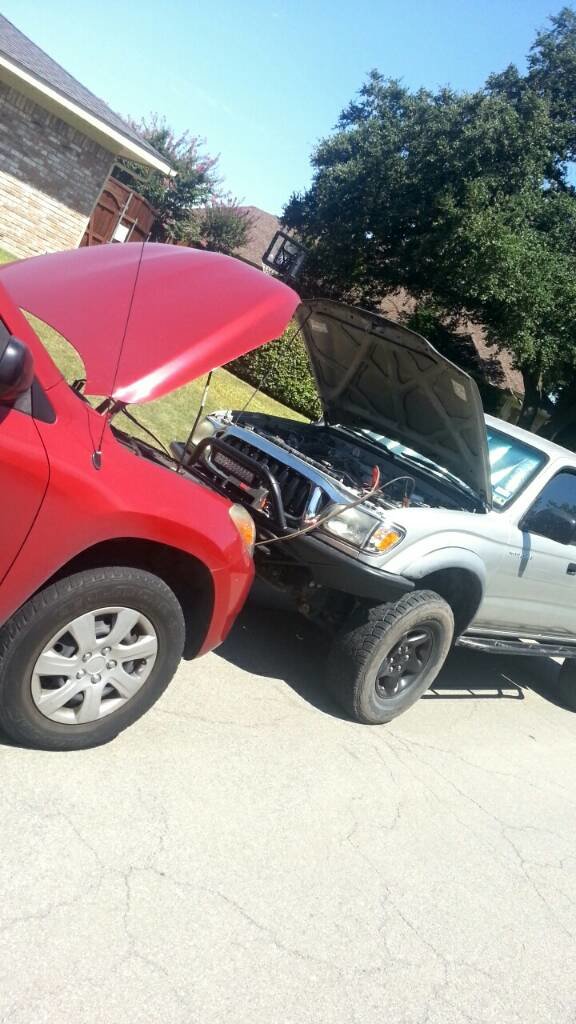

    Yayyyyy more problems

    Don't rub off on me either my battery is 5 or 6 years old...

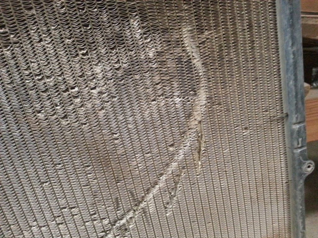

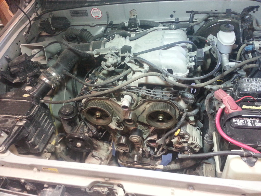

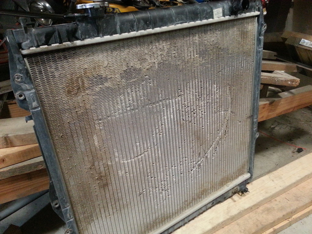

    Today I replaced my timing belt, water pump, and thermostat. The cam and crank seals showed zero signs of leaking, so I opted to not jack with those. All pulleys and belts were in good shape as well. However, it looks like my fan has made contact with my radiator on several occasions. I was fully expecting this project to take me an entire weekend and I got it done in one day. I did have a lot of trouble getting the crank bolt loose, but eventually got it out with a little help from the starter.

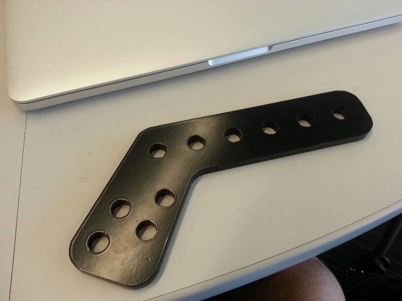

    I bought something for the truck that I've needed for a long time. :woot: Dorm life can't stop the mods!

    I'm hoping this will solve my brake issue I've been chasing

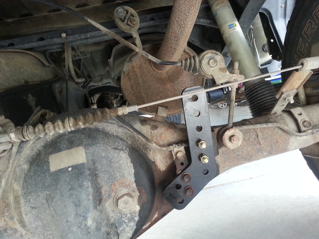

    Installed my BAMF BPV relocation bracket. Didn't make a huge difference. Maybe keeps my truck from nose diving as much, but my wobbles are still there.

    Seriously? That's unfortunate. I was hoping for your sake it would make a difference.
