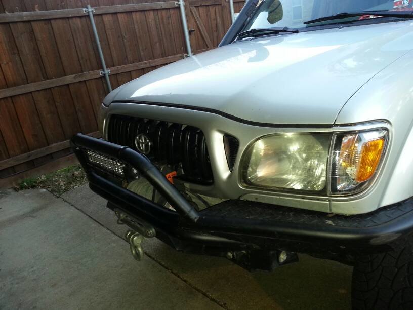

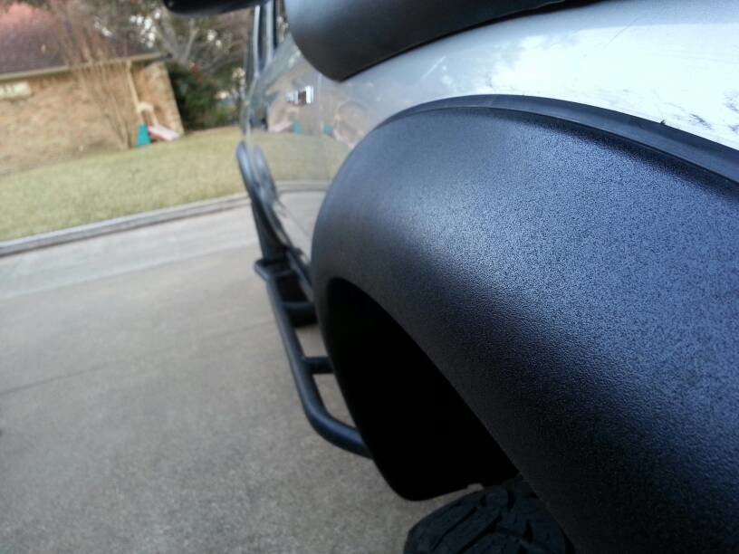

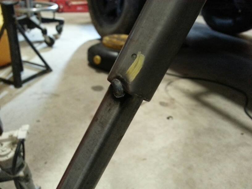

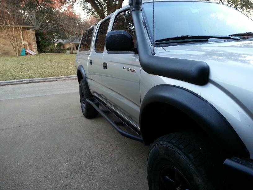

    Today I did an oil change, Castrol full synthetic. Also rotated the tires and did the tac weld mod for the steering column. It made such a difference on the highway. I highly recommend it to anyone that has loose steering!
    I also finally washed the truck today, so I snapped some quick photos of the fender flares and the grille as the sun was setting. I'll get some better ones tomorrow during the day. Still really happy with how this all turned out!

    :eek: That first pic and your steering shaft :itllbuffout: :welder:much props to you.

    Haha, thanks. It really wasn't very hard. The most difficult part was removing the springs for the steering wheel tilt. Those suckers are so strong!

    Tell me more about this tack weld mod.. First gen only?

    I think so....not positive though. There's a place on the steering column that's designed to snap off in an accident so you don't get impaled by the steering wheel. Over time it gets loose and allows the steering wheel to have some play in it. The weld eliminates all the play and also the horrible clunking sound most 1st genners know of when off road

    ugh alright. I don't have as much play now that I replaced the steering rack bushings but its still there.

    This is completely different than the bushings. People have replaced bushings and seen no difference for this particular issue on the first gens
