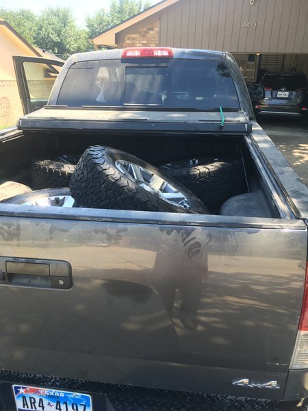

    Woo woooo got some tires to get me through the rest of college.
    265/70/17 BFG KO2s wrapped around 4Runner Trail edition wheels. The tires have 36k miles on them and look incredible. My Cooper ATPs have less than that and are toast.

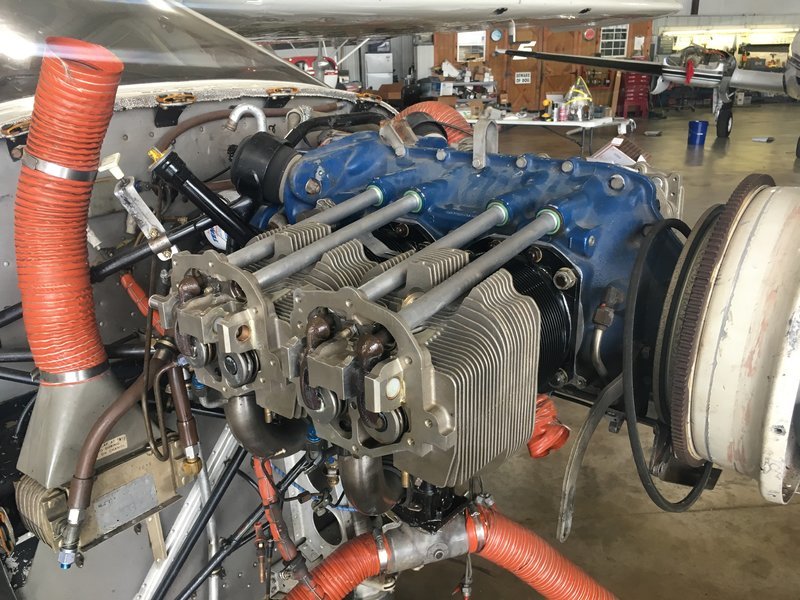

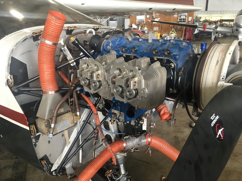

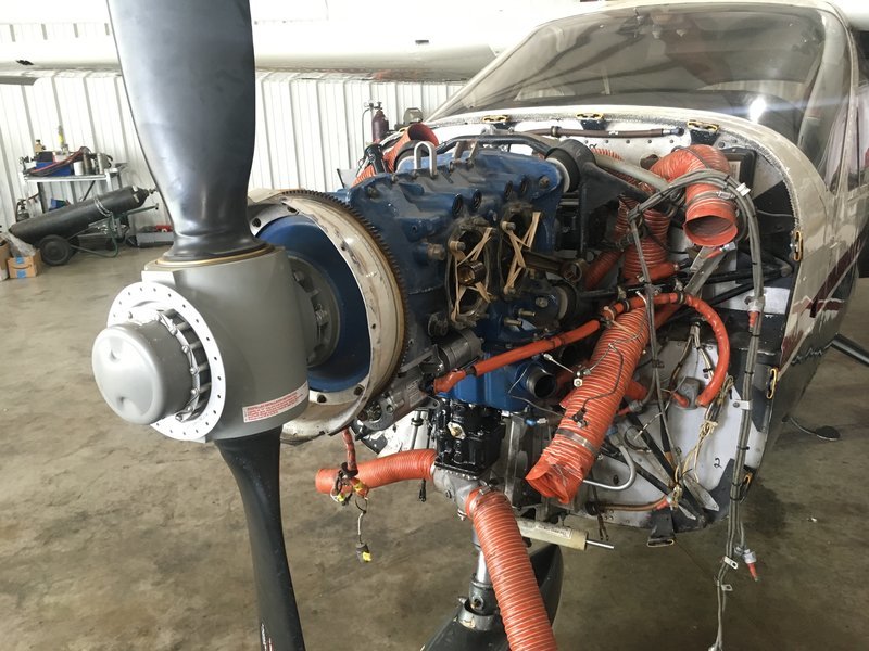

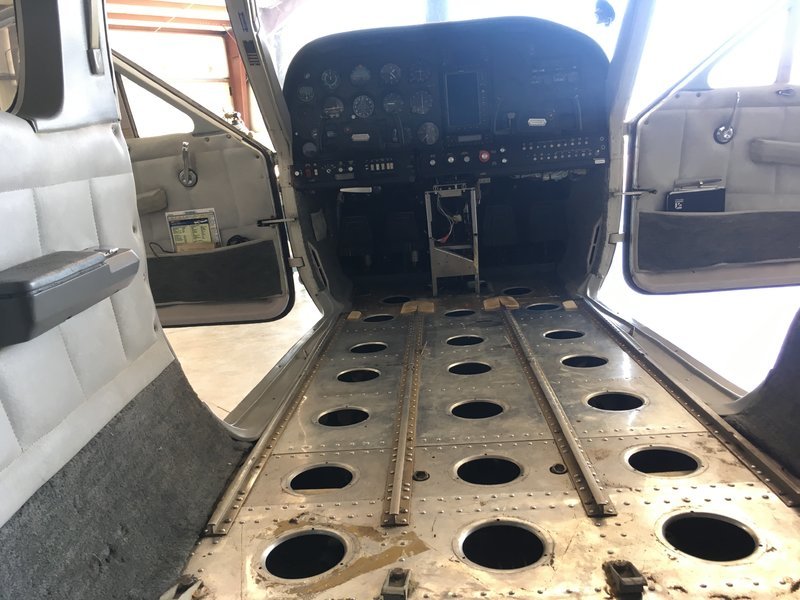

    This isn't part of the Tacoma build, but I guess it's kind of a Cessna build.
  3. May 21, 2017 at 9:07 PM
    #1083
    MatthewMay1
    MatthewMay1 [OP] I'm an amateur professional.
    Nov 21, 2011
    #67486
    11,100
    Matthew
    Lone Star Republic
    Supercharged '01 TRD

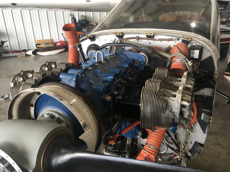

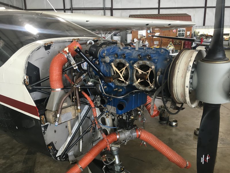

    Got the valve train, intake tubes, and oil return lines installed and am now at a stopping point until I can get a longer push rod. I guess we can actually start the annual inspection while we wait on that! This has been a super fun project. It'll be even cooler once it runs :D

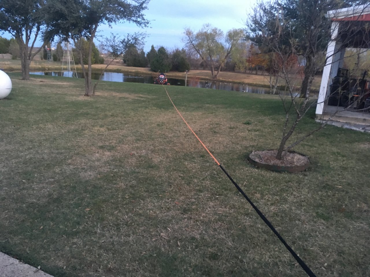

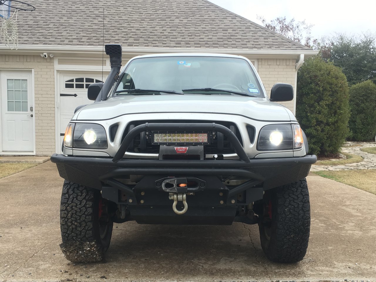

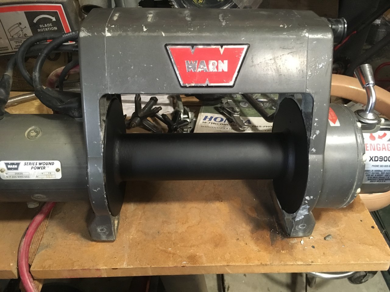

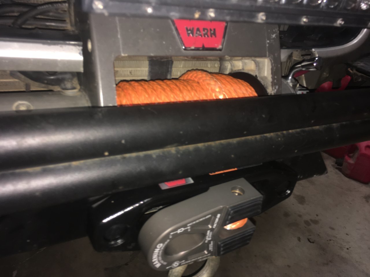

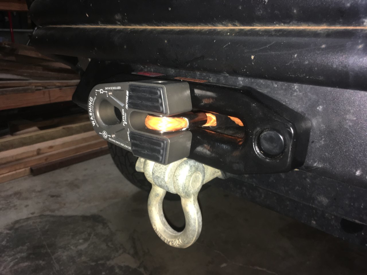

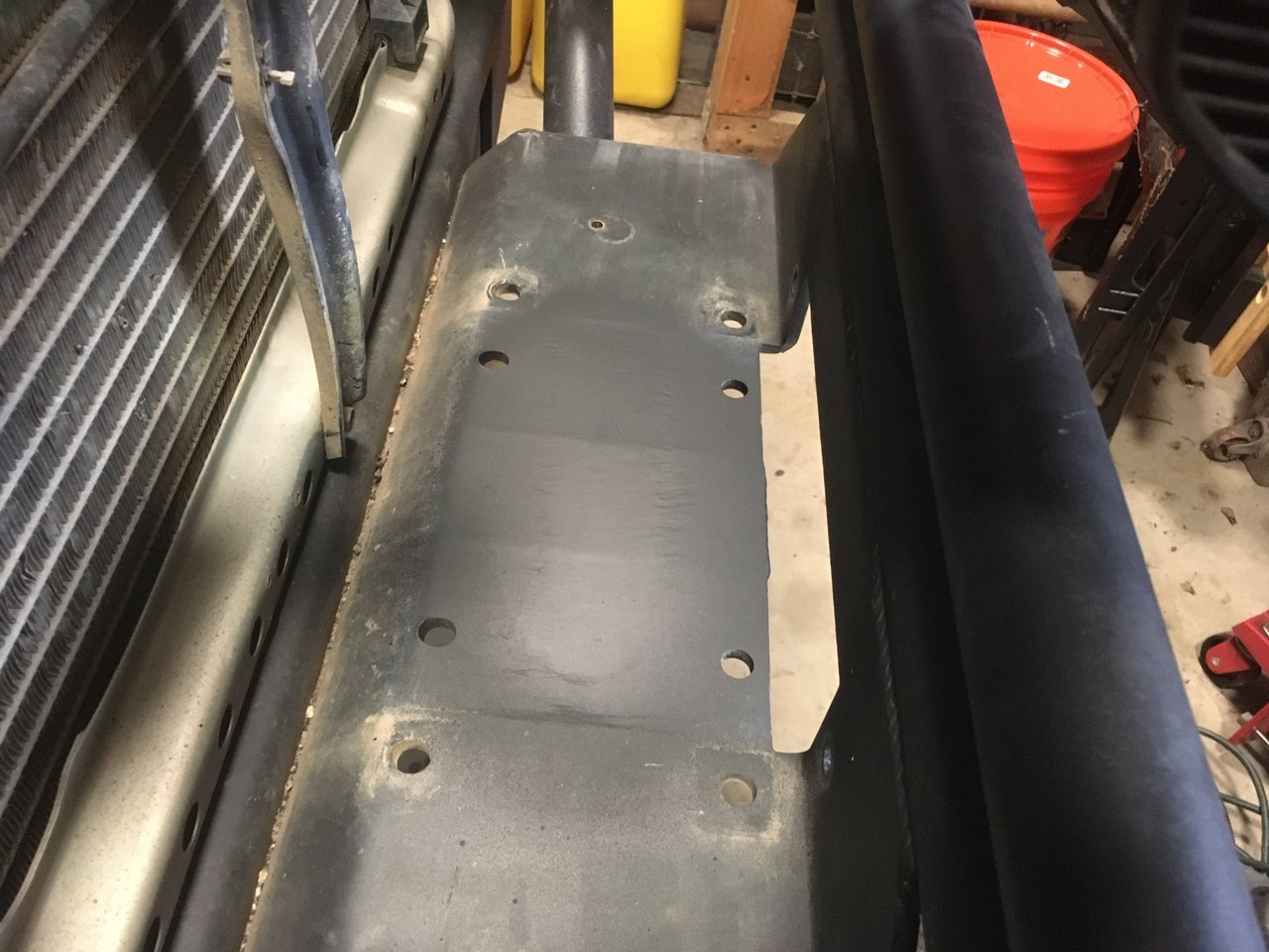

    WOW! An update to the truck!! I finally got my synthetic winch rope installed that has been sitting in my room for a year.
    I grinded and repainted the bumper where the steel cable had scored it up when spooling around the drum. I wanted it as smooth as possible to prevent snagging of my nice new rope.
    Then I removed some light surface rust from the drum and painted it so it was also nice and smooth to not snag the rope. The tape I used to mask off the rest of the winch was so sticky that it removed the finish in some places.
    I also removed my pair of 6" LED fog lights because they were useless with the HID headlights. I could see no difference at all on the road, so I figured I could stick them on a tractor or something else later.
    Spooling on the new rope with a little tractor to apply tension. 100' 3/8" 10,000lb breaking strength.
    Finished! Now I want a black shackle to go with the blackness of the fairlead and FlatLink. I also intend to get some type of cover to go over the winch drum to protect the rope. Not sure when I'll get around to that, but I'm not too worried about it at this moment. I saved 40 pounds off my front end by doing this, so that's a win for sure!

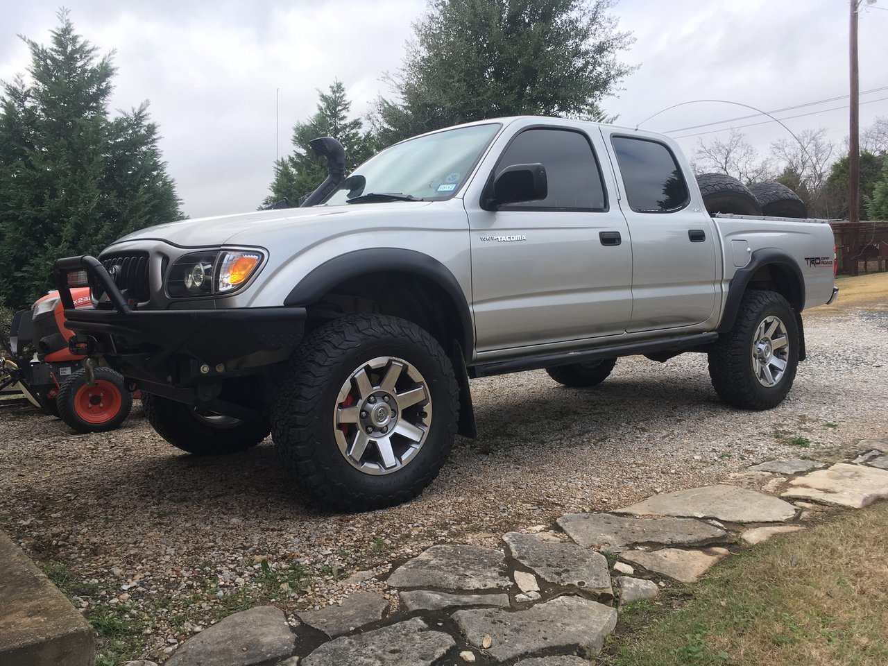

    Holy moly! Another update? What? Who would have thought I had things for my truck sitting in my garage so long without being installed!

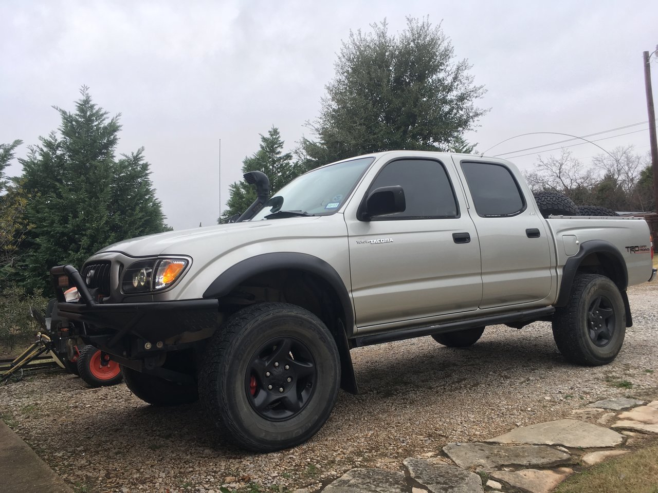

    Today I threw on some new-to-me 4R Trail edition wheels and 265/70/17 BFG KO2s. Tires have about half life left and should last me until I graduate next December. Then when these wear out, I’ll get some 33s!
    Before
    After
    41FC78FA-C6CD-4F47-B920-BB520522230F.jpg C8FD2E40-F723-4C16-97B5-EE866CAA3B01.jpg

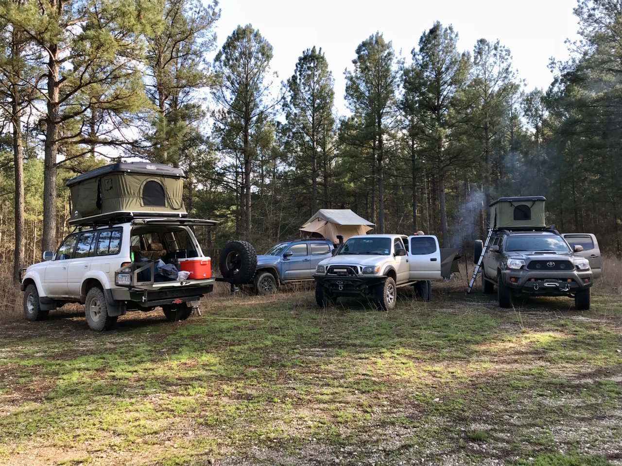

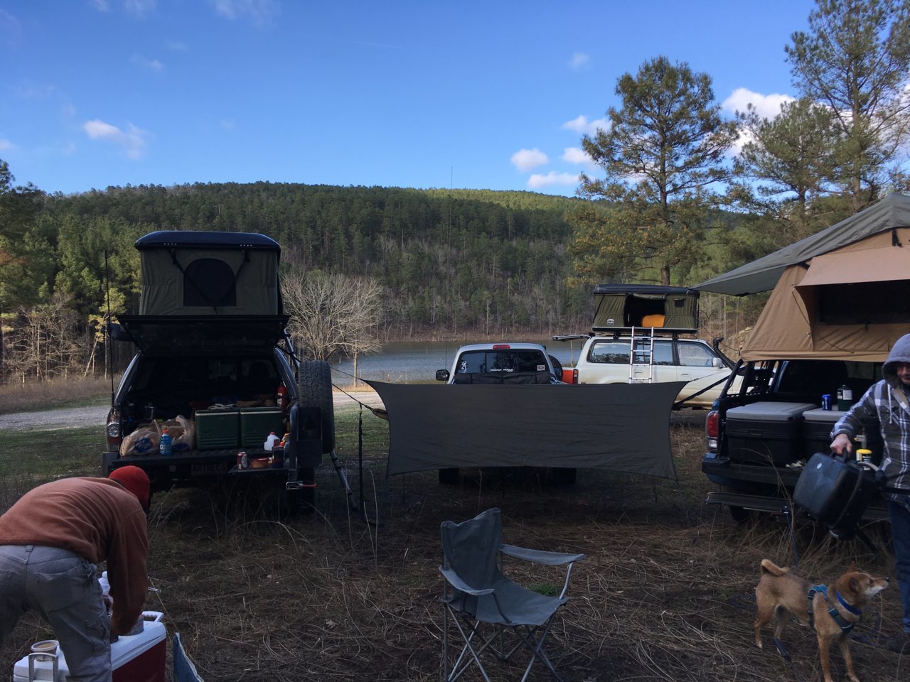

    Note: 28(ish?) degrees is too cold to sleep in a hammock. Long story short, after freezing until 3AM, I moved my sleeping bags to the truck. Still had a great time this past weekend in the Ouachita National Forest with @TenBeers @TerraNerva @PinnaclePete @Dave_M. Thanks everyone for coming out despite the weather and getting pictures!
