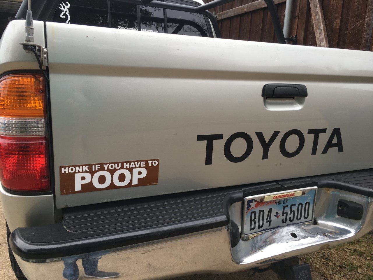

    To the person that did this while I was having breakfast today, I love it. Thank you

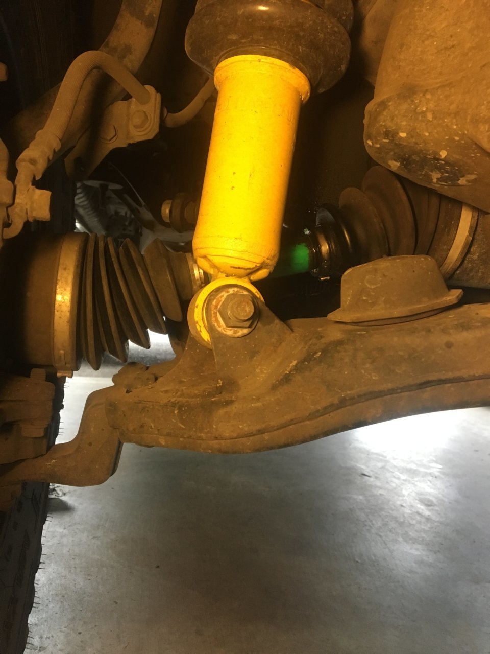

    CV angles look better than mine, we're both rockin 883s. I'm hoping mine even out a little bit once I get a bumper on there. Have you had any issues with your boots?

    Man that picture was taken years ago. I'm still on the same suspension with zero CV issues!

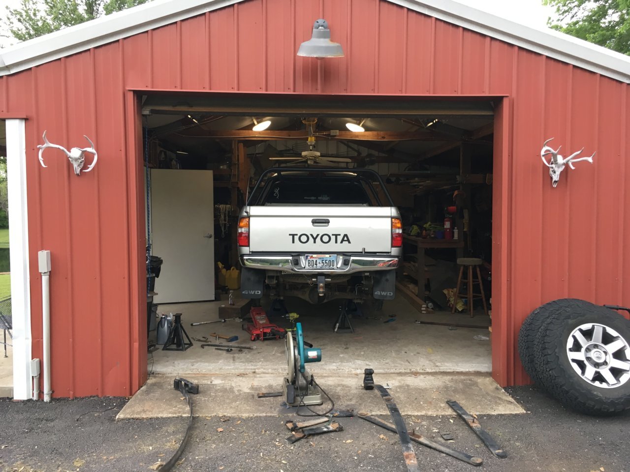

    Finally got around to refreshing my rear springs. Used one of the Chevy leafs as an AAL and kept my stock overload. That lifted me wayyy too high so I then removed the lift shackles and reinstalled my factory ones. Love the ride height now, and the ride quality is so much better. No more axle wrap either!

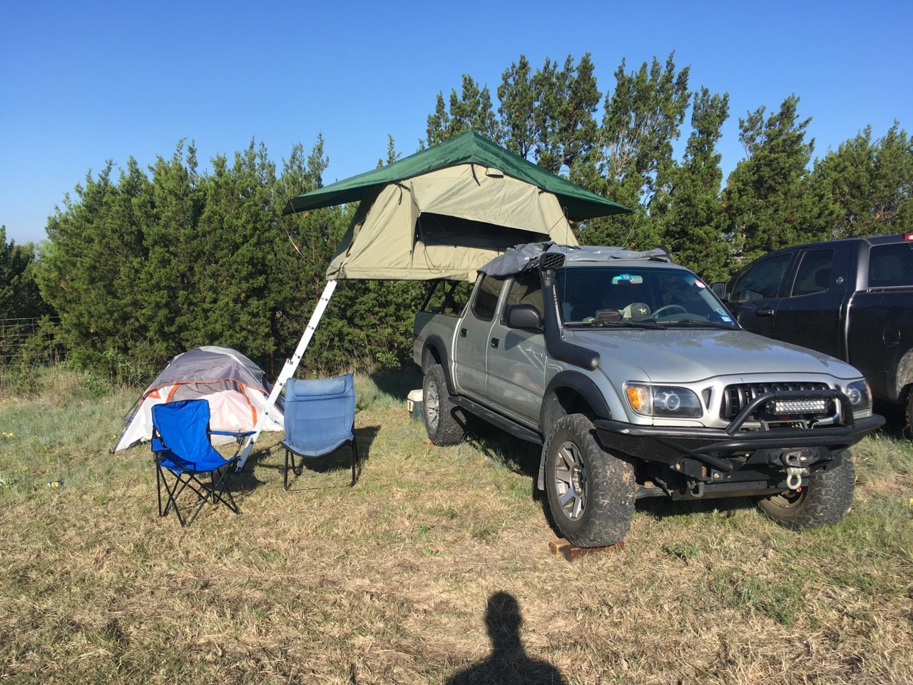

    Got the RTT on the truck this evening in preparation for the weekend. It dropped my rear half an inch, but I still have 1” of rake so I’m happy with my bastard leaf packs. Going to see if it settles much and then maybe reassess later on. The RTT clears my garage door by about an inch, sothat’s killer. Pretty happy right now and curious to see how it drives tomorrow.

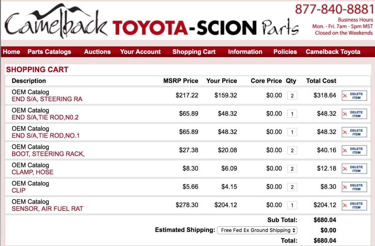

    Things I need just posting here to keep track of:
    inner tie rod (2) - 45503-39075 $212.22
    outer tie rod (L) - 45047-39175 $65.89
    outer tie rod (R) - 45046-39295 $65.89
    boots (2) - 45535-35030 $27.38
    inner boot clamp (2) - 90460-62006 $8.30
    outer boot clamp (2) - 90467-33005 $5.66
    upstream O2 sensor - 89467-35060 $278.30 (I think this is the correct part number)
    upgraded alternator
    "big three upgrade" - Doesn't someone here sell a kit for this?
    If I do that then I should add a busman box and circuit breaker too
    :rain:
    Edit: Camelback Toyota's online pricing is much better, and free shipping! Maybe I'll be able to continue to eat this month after all.
