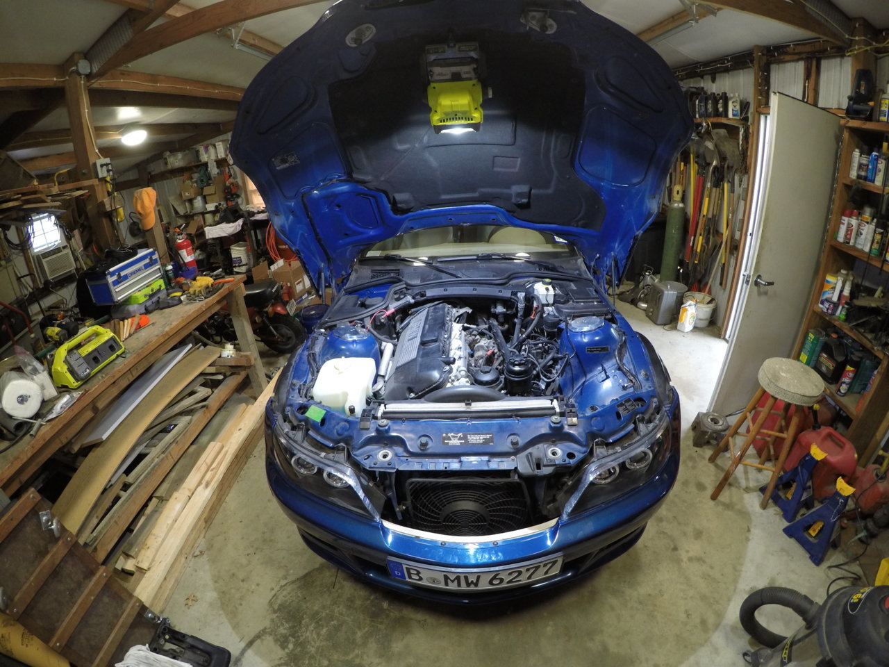

    I did the fun car mod a few weeks ago... 2001 BMW Z3 3.0i 5-speed with 58,xxx miles. One level below the Z3M and with that comes fewer maintenance gotchas, still plenty of power to have a fun drive to work, and a more attractive rear end design (to me).
    Details include:
    Aftermarket halo & HID headlights
    European dash swap
    Upgraded radiator and water pump (cooling system is one of the main issues with these models)
    Sport seats
    New rear window
    XM radio with hands-free phone and USB/Aux inputs that is remote mounted behind the glovebox and integrates with the stock radio (I have no clue how to operate that yet).
    Fancier OEM BMW wheels
    Things I did today:
    Replaced burnt out light bulbs for HVAC panel
    Repaired A/C temperature control knob to prevent it from binding up

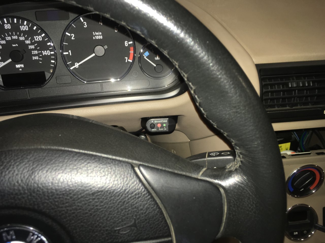

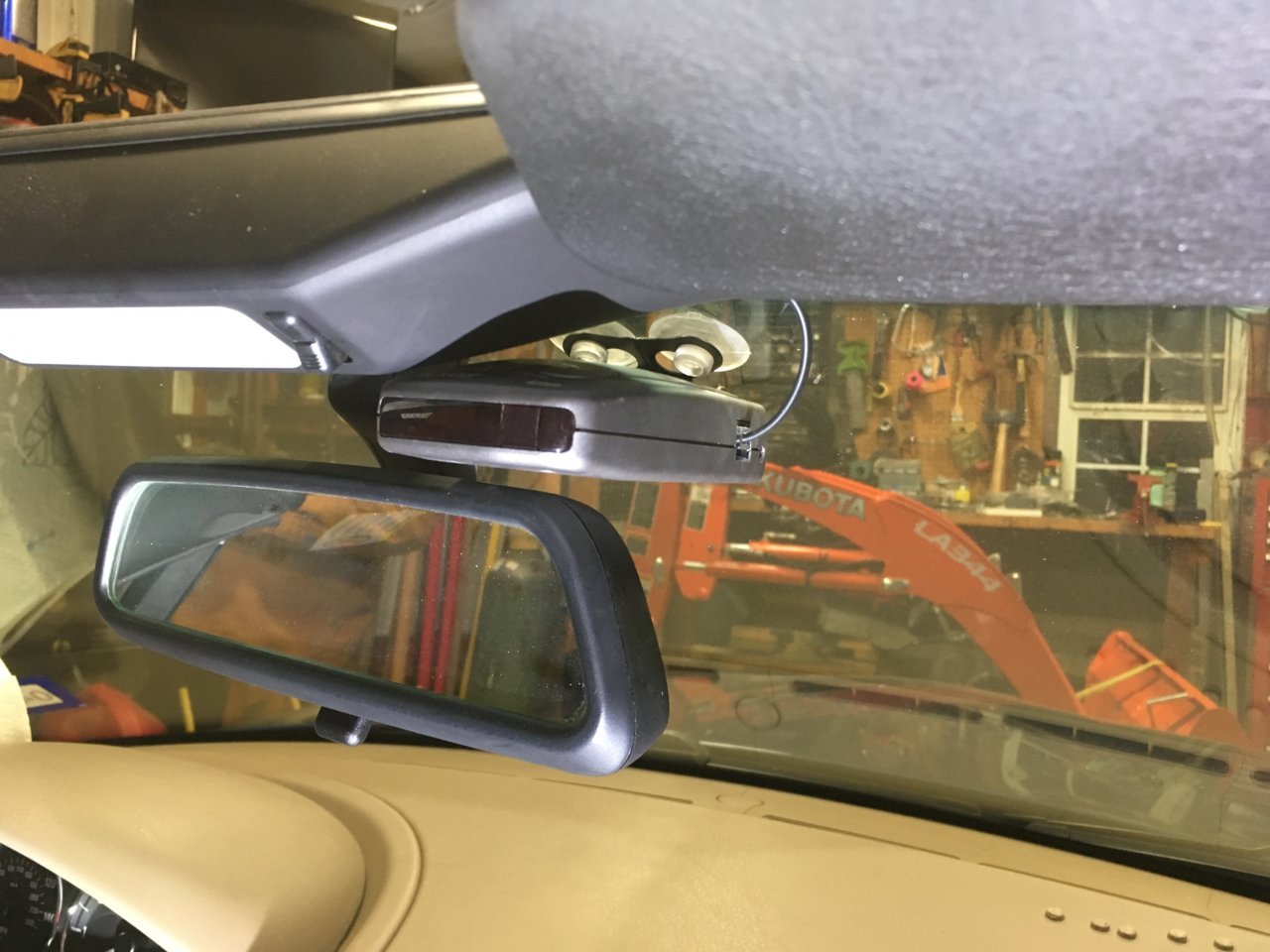

    Hardwire kit with remote mute button for my radar detector

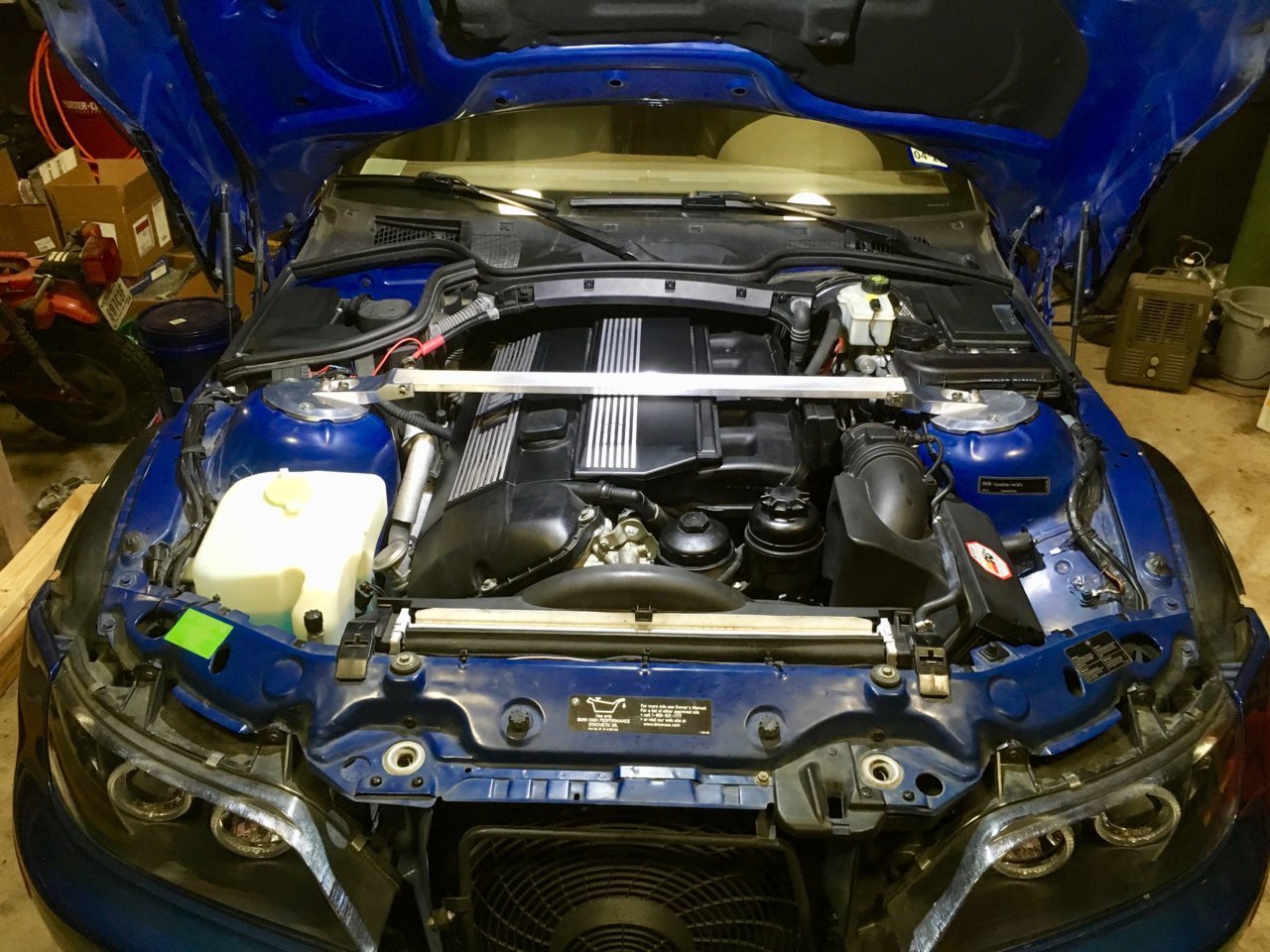

    Strut tower brace. I hear this helps a lot with the handling, especially since the car has no roof. Report to come soon.
    I'm going to try to keep this car mostly stock because I want it to be as reliable as possible. I'm getting ready to do the 60,000 mile service and have discovered some funky things. According to my service manual, BMW states that the transmission and diff fluids are "lifetime" and do not require scheduled changes. That goes against most of what I know as a self-proclaimed professional gearhead. I'll probably change it all anyway, on account of the fluid being nearly 20 years old. After reading on the Bimmer forums about different engine oil, transmission oil, and gear oil, I am now sufficiently confused and will most likely just run by the dealer and get all OEM BMW fluids to use. I figure I can't go wrong with that. It'll probably be expensive but it's not like I'm changing all these fluids every year.
    Since this car is so close to the service interval, I am going to take care of it before I start the supercharger instal on the Tacoma. I figure I'll get this in tip top shape so I can down the Tacoma for a while.

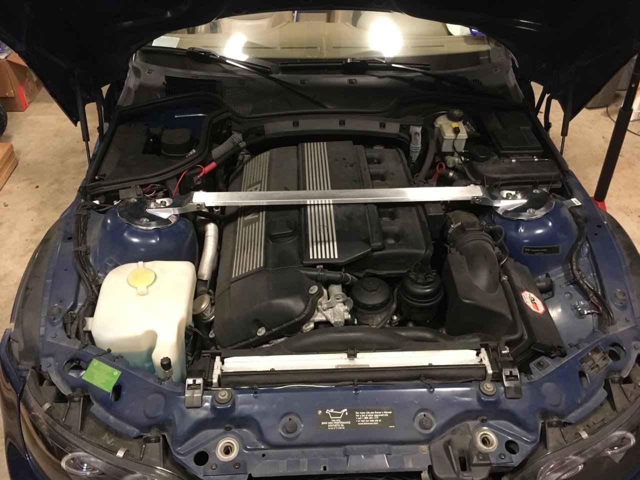

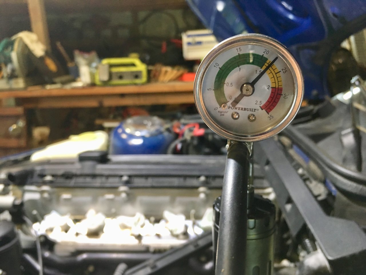

    Wishing I hadn't looked inside the intake manifold on the Z...It's coated with oil! Now I've got a slew of parts I'm going to replace on it. Some out of necessity, some preventatively. Guess I'll be getting familiar with that engine soon.

    One reason why I haven’t touched my Supra. I can handle everything else besides engine right now. Basically kicking the can down the road......

    It runs good right now and doesn't smoke. That's why I was surprised to see what I found. I can't bring myself to continue driving it like it is though, so it's gotta get fixed up before I can DD it to work on the Tacoma

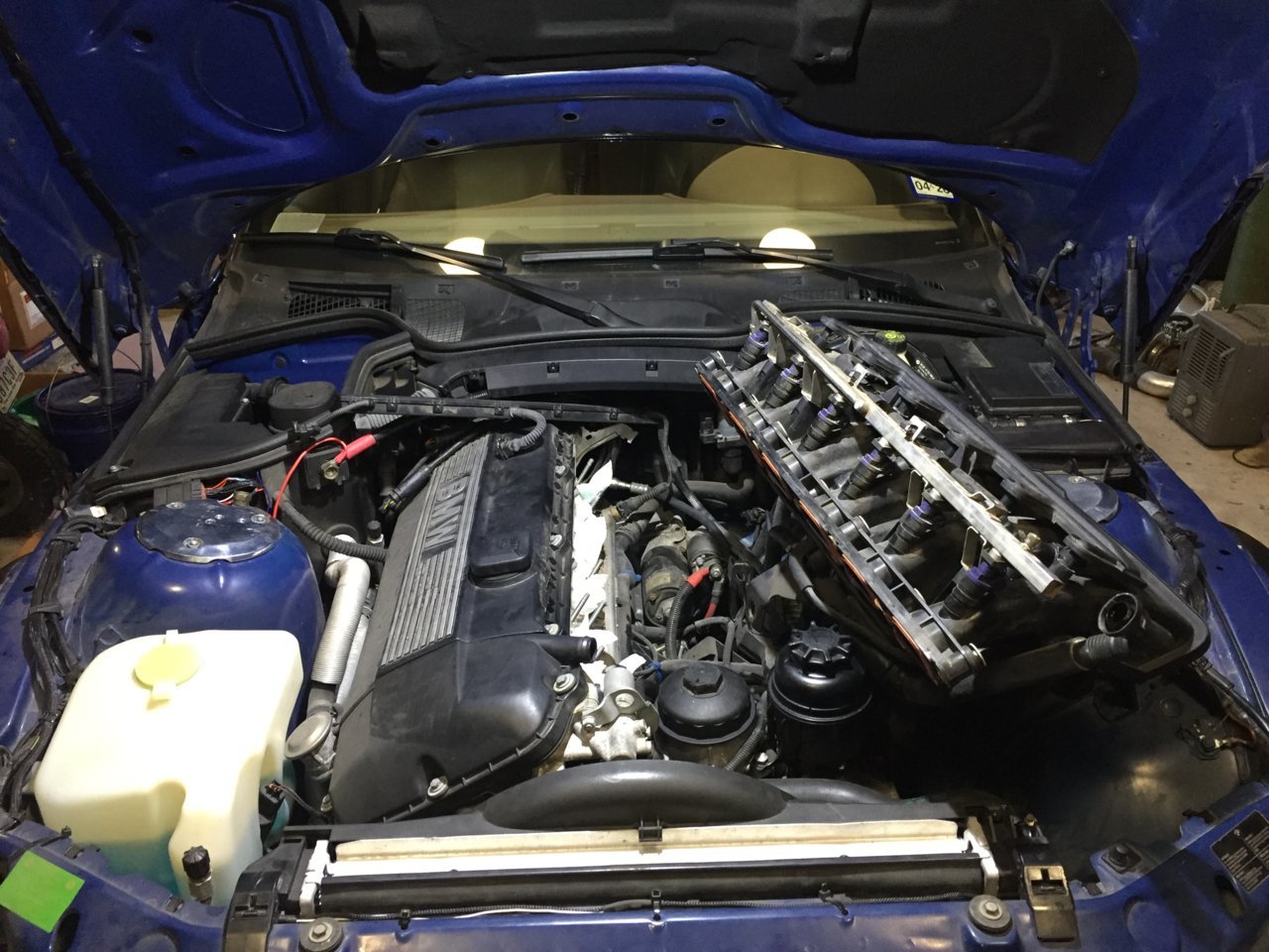

    Tore apart the fun car today. Doing a slew of of those “might as well do this while I’m in there” types of items.
    BYJOSHCOOK likes this.
  18. Mar 5, 2020 at 1:36 PM
    #1238
    MatthewMay1
    MatthewMay1 [OP] I'm an amateur professional.
    Nov 21, 2011
    #67486
    11,102
    Matthew
    Lone Star Republic
    Supercharged '01 TRD
    Supposedly when this car was built, the hood was the largest single molded piece of metal fitted to any production car yet. Doesn’t surprise me. This hood is freakin huge!
    I replaced the two hard plastic coolant lines that run underneath the intake manifold. They are known failure points in the coolant system and I’m glad I replaced them because one was brittle enough to break off in the engine. (That was fun to extract). Now I’m pressure testing the system and all seems to be holding well. I’m going to let it sit for a couple hours to be sure.

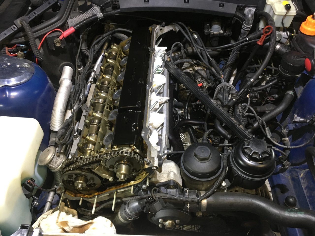

    I just finished my engine refresh today on the Bimmer. Under the hood I did:
    CCV kit and associated hoses from Bimmerbum
    Vacuum lines
    DISA rebuild from German Auto Solutions
    VANOS rebuild from German Auto Solutions
    VANOS oil line (mine had developed a leak and was the main driver of this whole project)
    Valve cover gasket & gromets
    Intake manifold gasket
    The two hard heater lines under the manifold
    Coolant line from top of expansion tank to top of radiator
    Spark plugs
    Oil & filter change
    Outside the hood:
    Brake pads all around
    In the coming days:
    Coolant flush
    Brake Fluid Flush
    Diff oil
    Fuel Filter
    I was very relieved when it cranked right up with no alarming sounds!
