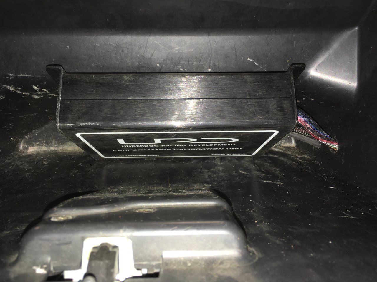

    Got the majority of the URD 7th injector kit installed today.
    I was an idiot and forgot to wait to start this project with an almost empty tank of gas so I ended up wasting hours siphoning fuel out of my nearly full tank so that I could drop the tank to replace the fuel pump. Finally got the tank dropped, new fuel pump installed and tank back under the truck.
    I then set out to replace my fuel filter but realized I didn’t have the correct size line wrench to get the fuel lines off the filter. They’re very tight and I was afraid of rounding them off with a combination wrench, so I’ve ordered some metric line wrenches from Amazon and I’ll get the filter changed when they arrive.
    I then moved to the engine bay to continue with the 7th injector kit. I cut my high pressure fuel line and installed the T connector and new fuel line to go to the 7th injector. I got that all installed and then moved on to the interior of the vehicle to find a place to mount the control module.
    After racking my brain for hours and removing interior panels, I came to the conclusion that I had no real good place to put the module. I ended up riveting it into the inside top of the glovebox and drilling holes in the side of the glovebox for the wiring. I’m not thrilled to be losing the storage space in my already-tiny glovebox, but it’ll be worth it when I hear that supercharger whine! Tonight I learned that my soldering skills are terrible, but I think I got solid connections on the ECU wire taps/splices for the 7th injector kit. That was nerve racking at first, but after I cut the first wire the others were easy peasy.

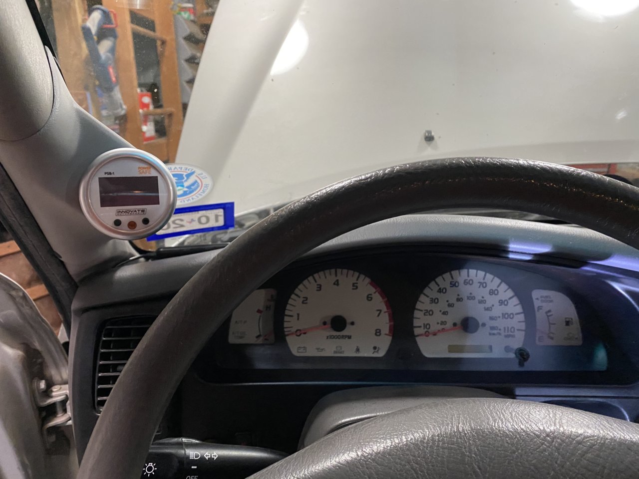

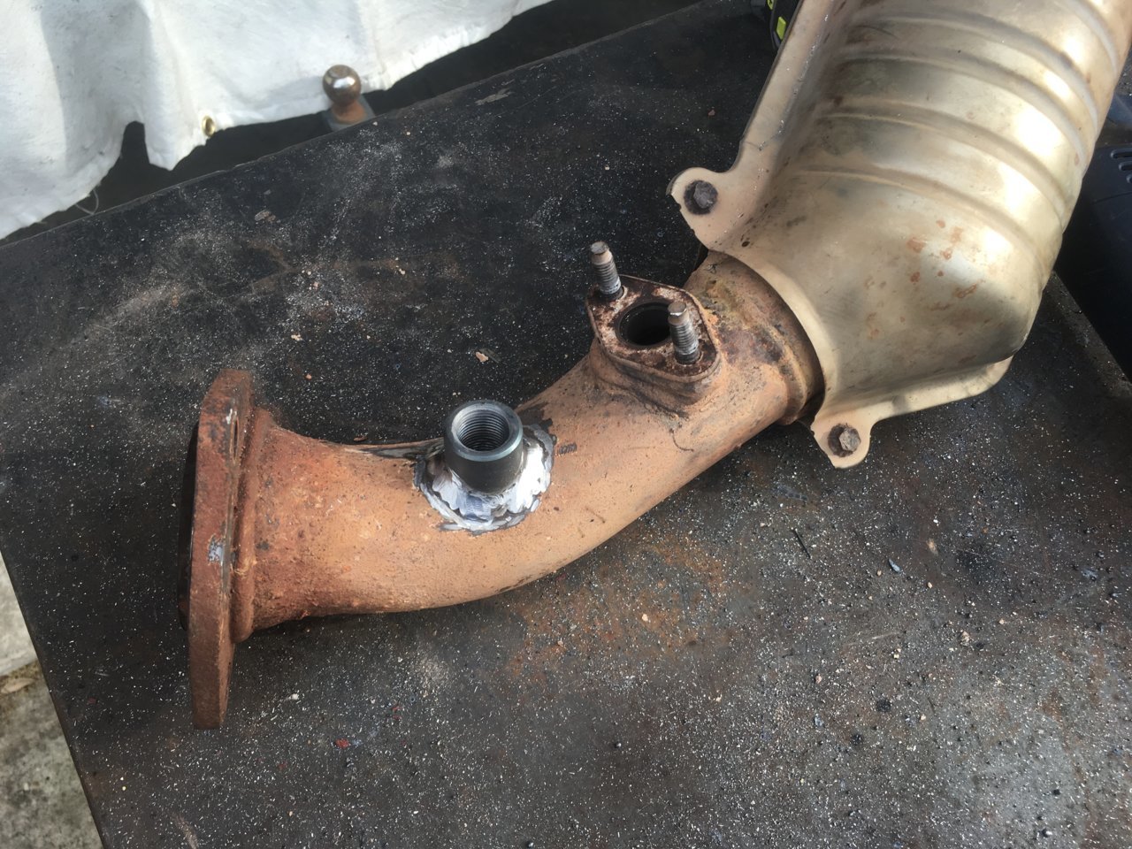

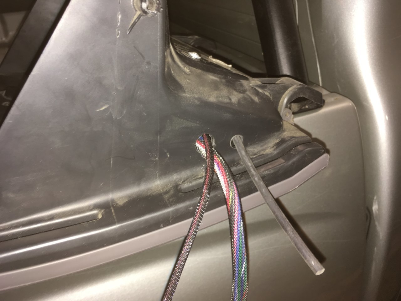

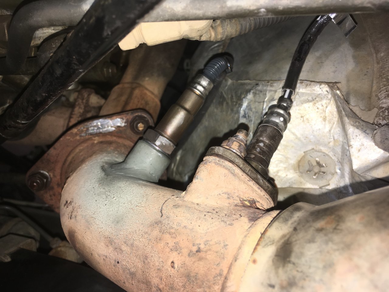

    Today I completely finished the 7th injector installation and began setting up my PSB-1 gauge. I got the new O2 sensor bung welded on the exhaust and the wires for it ran into the cab. I got the MAP sensor mounted on the firewall for the boost pressure and ran that wire in to the cab as well. When I took the exhaust apart to weld the O2 bung, the catalytic converter gasket crumbled to pieces in my hand so I’m going to have to find a new one of those before I can put the exhaust back together.
    I pulled a dumb move and wired in the boost gauge without putting the wires through the pillar pod first. Oops. At least I know the gauge works though. I am going to need to paint my pillar pod gray to match the interior of the truck. Does anyone have any idea what paint I need to use to match?

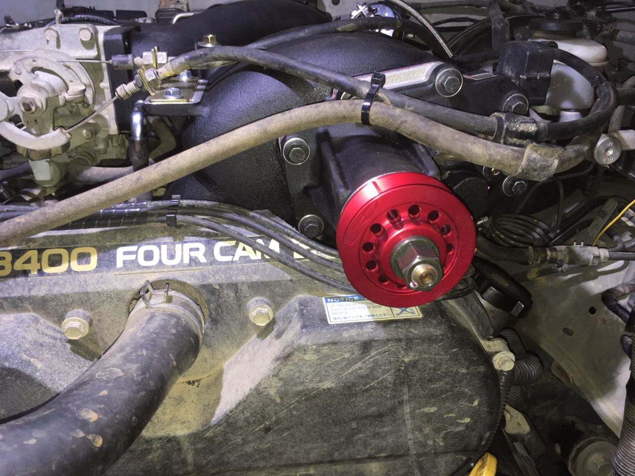

    Today I got my exhaust reinstalled and zip-tied all the wiring in the engine bay for the O2 sensor. I also installed the 2.2 pulley. I was surprised with how heavy the stock pulley was in comparison to the new aluminum one. I still need to paint my pillar pod, but am trying to avoid going into stores due to the virus....so finding paint is becoming difficult.

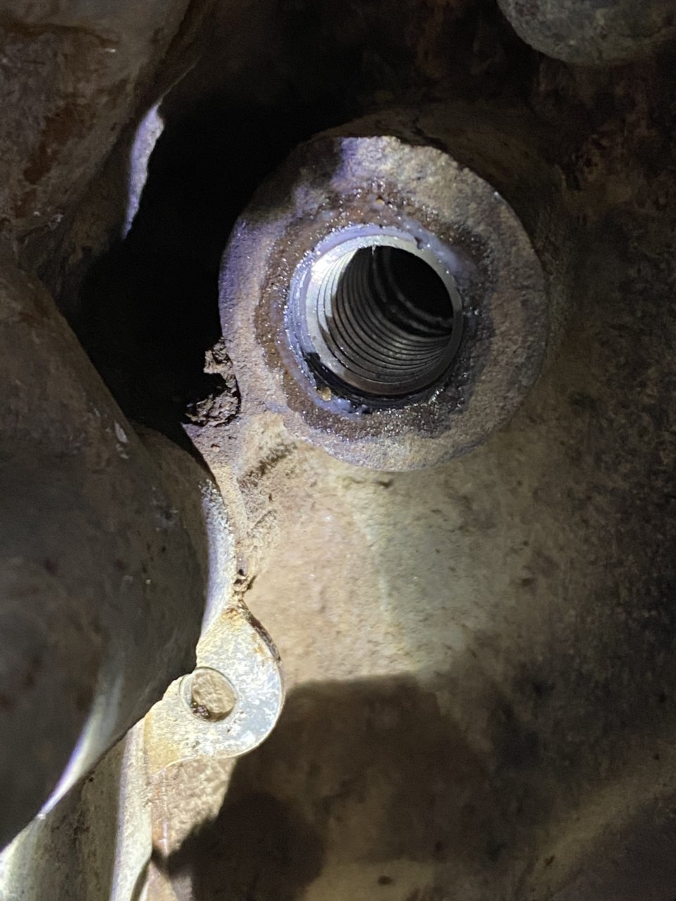

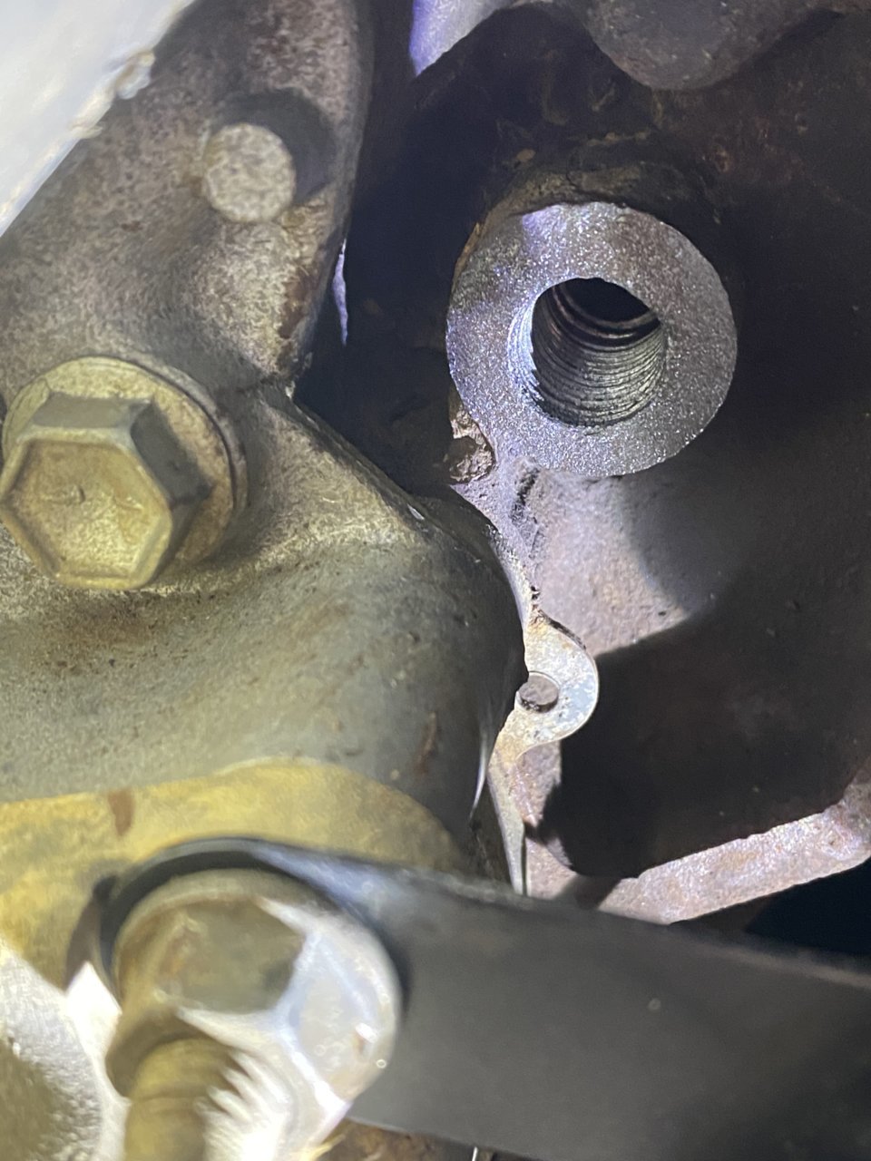

    Alight, now I’m pretty mad. I got 2 new tensioner bolts (one to have as a spare just in case) and as I was installing the tensioner with my new gates belt, the new bolt stripped out in the exact same place the old bolt did. I’m starting to think the hole on the block must have rusted out or something. Now I’m not sure what I can do aside from helicoil the block. I’m using grade 8 bolts and am nowhere near the torque spec of 40 ft-lbs. it’s stripping at about 10 lbs, and that’s after threading it in all the way til it stops by hand.

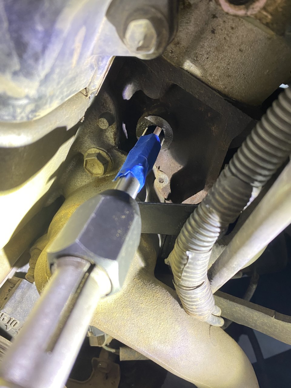

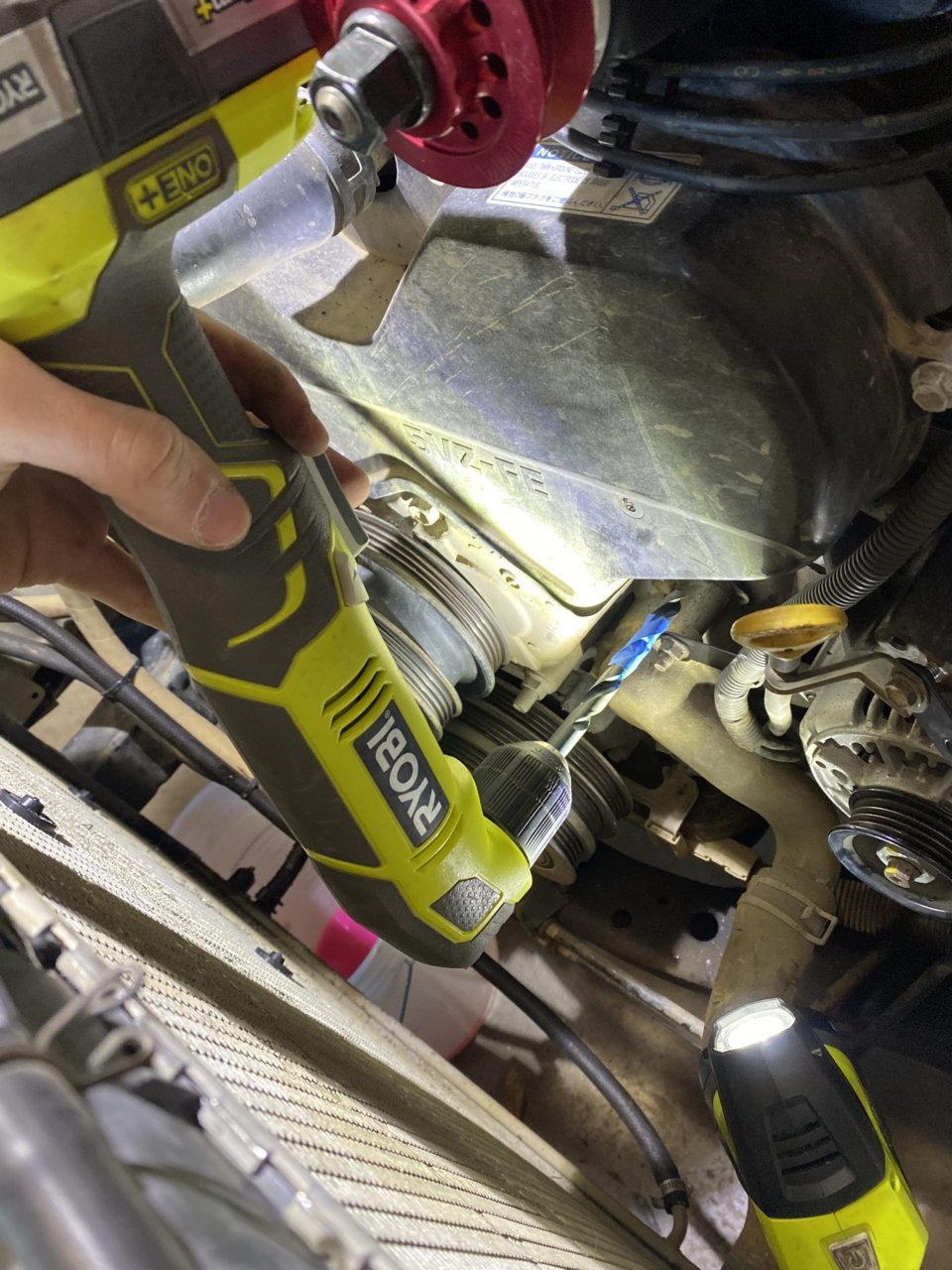

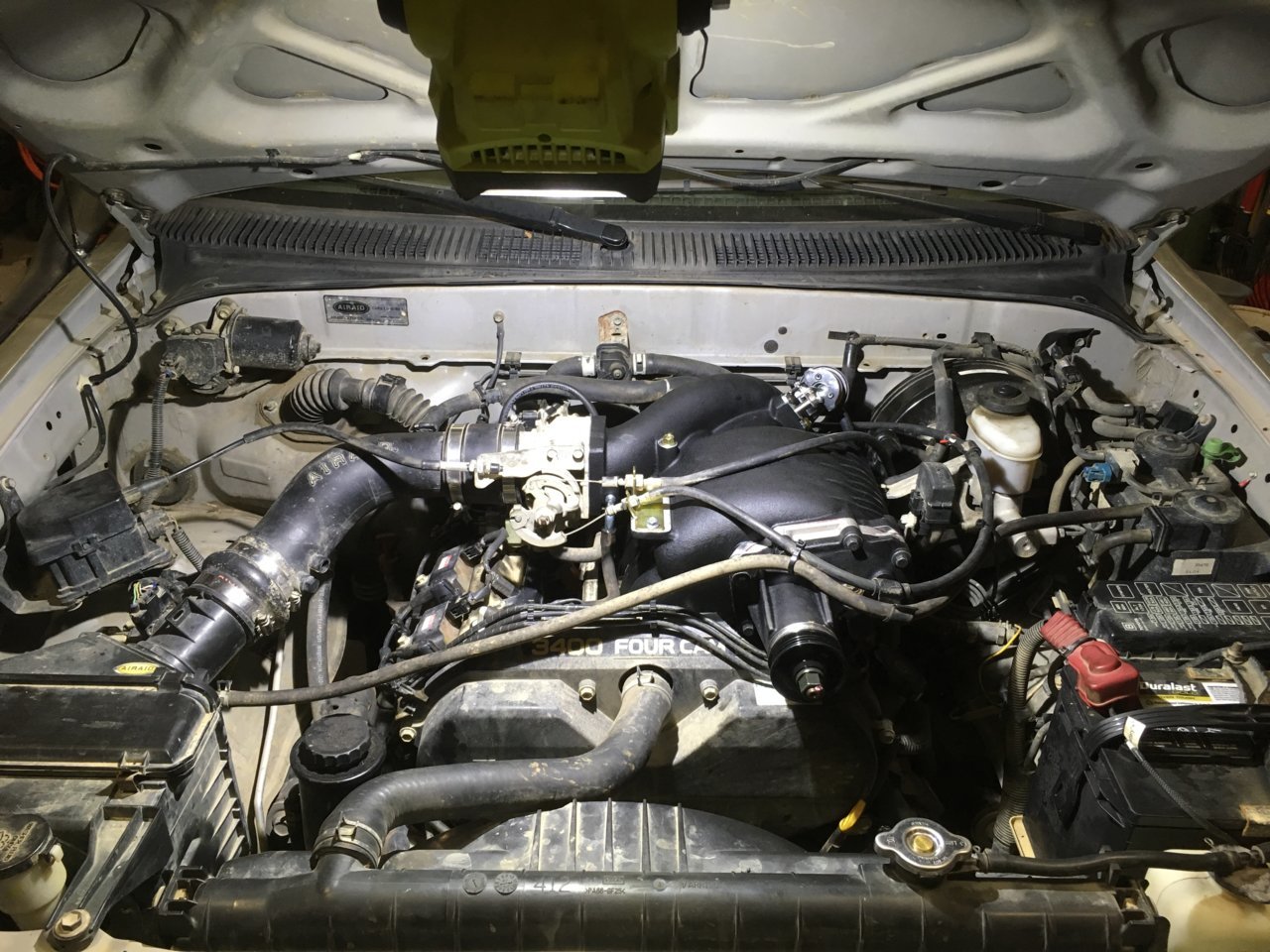

    Back to the supercharger install...
    Today I drilled the block and used a helicoil to fix the threads for my dynamic tensioner. Lucky for me, I was able to get it done without removing the radiator. That was a little intimidating at first, but this evening I got everything finished under the hood and took it for a spin around the block. I limited myself to half throttle to help break in the supercharger itself, and to protect the transmission since I haven’t installed the TransGo kit yet.
    Now I have to button up the interior and figure out how to work the boost gauge and tackle the transmission kit.
    Drilling out the old threads being careful to not go too far
    Tapping the hole
    New threads cut
    Helicoil inserted
    It was so nice to hear this thing start up and run!!

    Finished up the boost gauge. Now everything is fully installed and tidied up. Only thing left to do is the transmission kit!

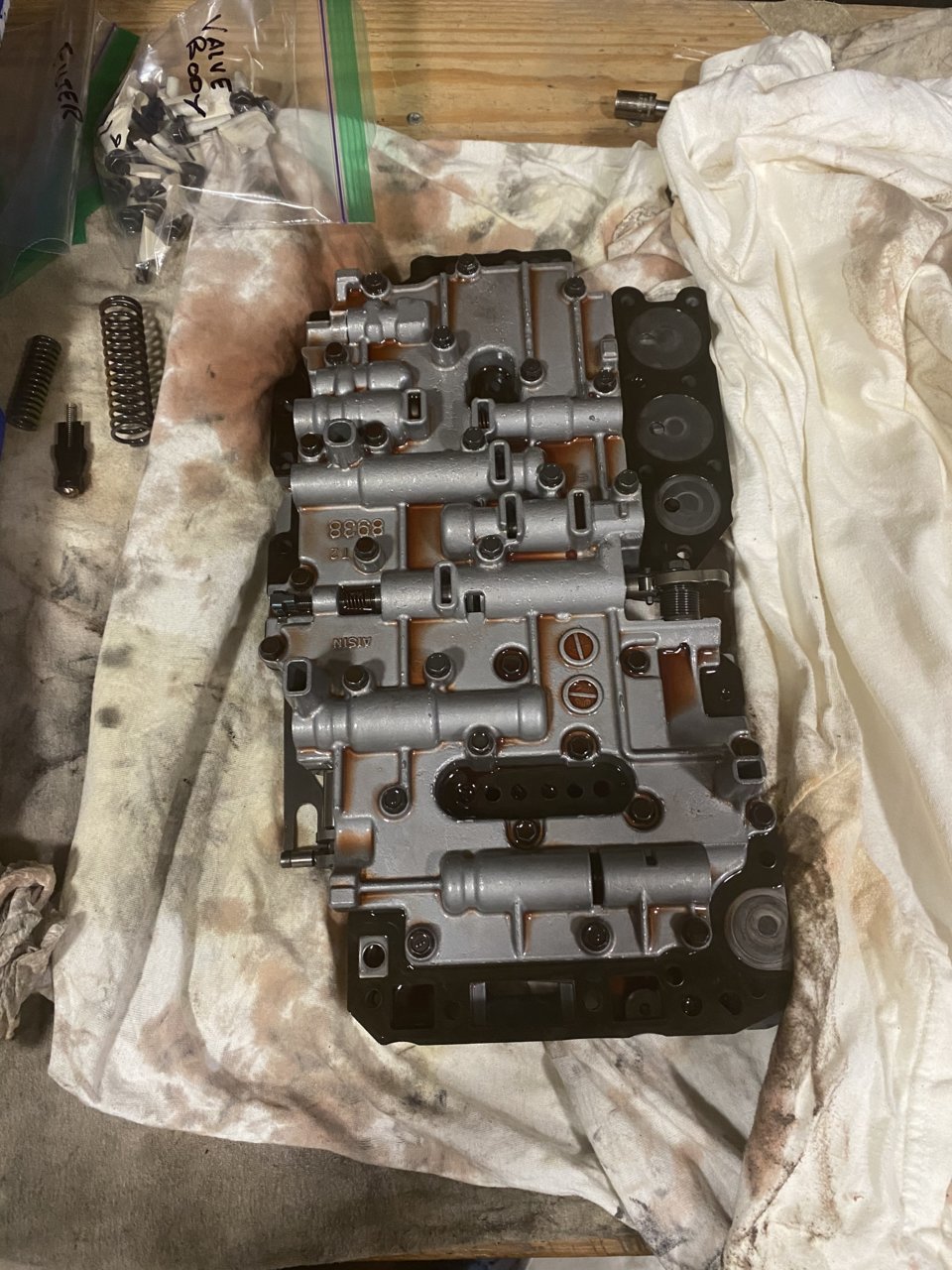

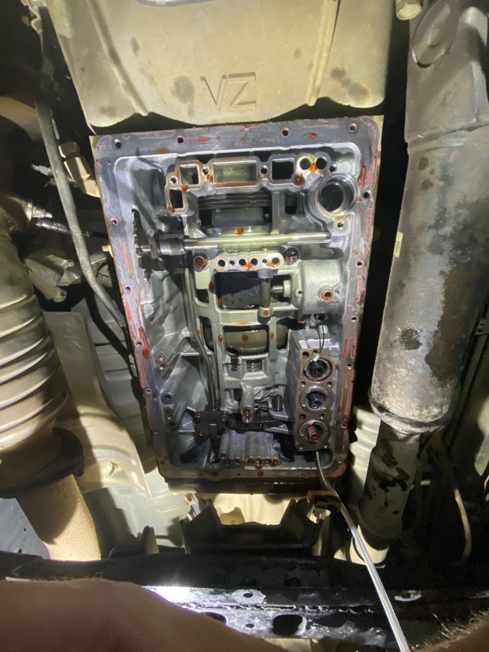

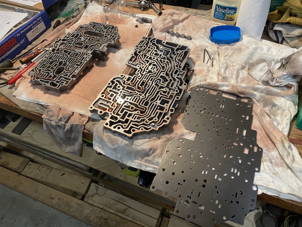

    Started the transmission kit and removed the valve body. The new valve body gaskets are back ordered until May 16.....that sucks.
    4158BD82-716E-494C-AAF2-CF0242016378.jpg 2DD5092F-EE74-4912-8428-2B3685B1862A.jpg

    I finally got my valve body gaskets the other day so I tackled the TransGo kit this evening. It was a bit stressful and having more parts in the box than I needed only added to my confusion and second-guesses.
    After thinking I lost a bolt and searching for it for an hour, I found it under the towels on my work bench. It somehow escaped my bolt bag. I finally got the valve body and new filter screen installed. The holes in gasket I have for the trans pan do not line up with the bolt holes in the pan so that seemed like a good place to stop. Tomorrow I will get the pan bolted up and ATF refilled. Then it’s time for some driving!
