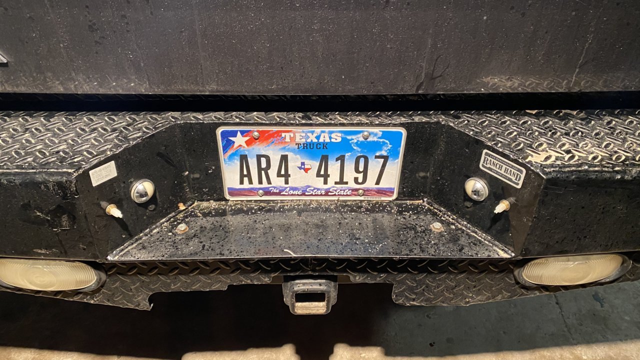

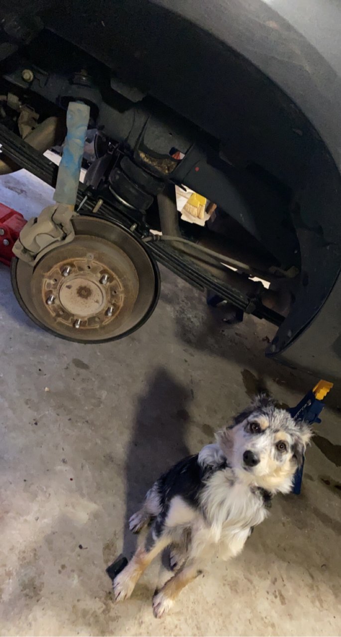

    Well nothing new to report on the Tacoma, but I did start it up and move it out of the shop so that I could put my Tundra in there. I installed some Firestone Ride Rite airbags on that thing. It’s much better now. I routed the air chucks to the rear bumper next to the license plate lights.

    ... nice dog too!

    Thanks! She's not quite as good as my last helper, but she's young and still learning ;) It's hard to get work done in a timely fashion with a canine face in my face. Haha

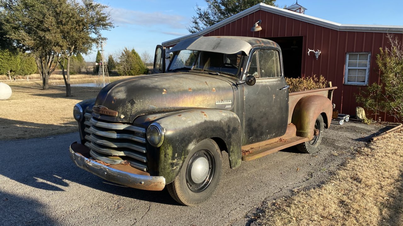

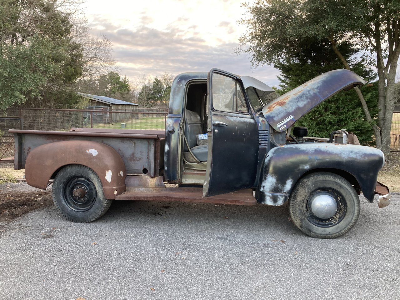

    As if I needed another project....I picked up a 1951 Chevy 3600 Pickup today

    That's a cool ass project though. Always wanted one.

    That thing is super cool.
    It has some really nice patina on it and that visor is amazing!

    I'm excited to play with it. I'd been eyeing this particular truck for years
    I think the visor is kick ass! It will make it real tough to see traffic lights though, haha

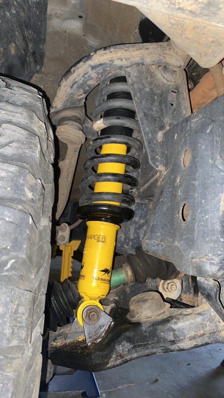

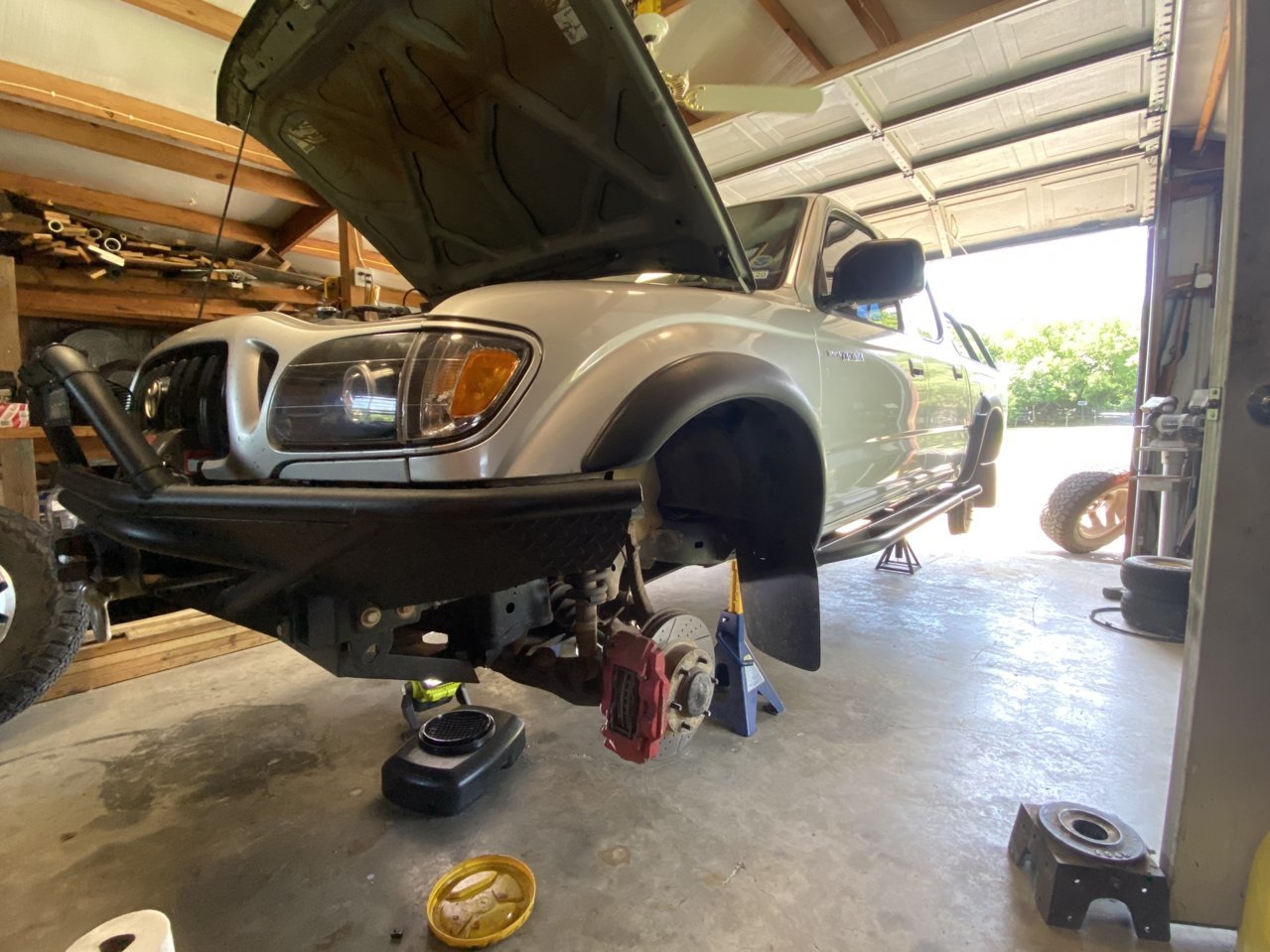

    Today I paid some attention to my Tacoma and swapped all four of the 5100s for OME shocks. Maybe tomorrow I’ll get to an alignment shop and see how the ride differs.

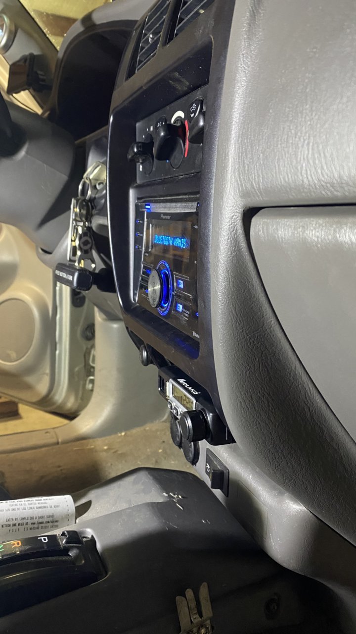

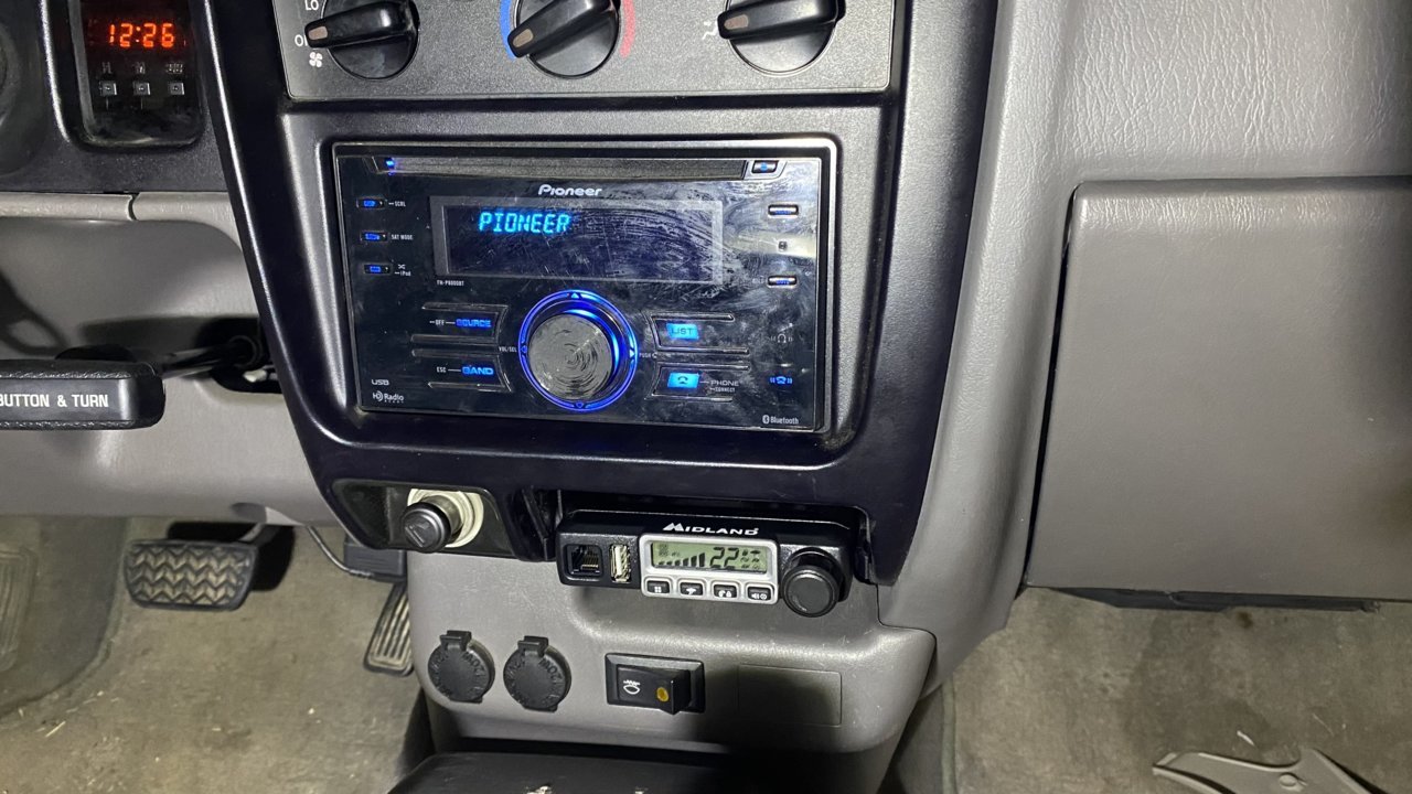

    Ditching the CB radio for GMRS. I got the radio mounted tonight, hopefully get the antenna tomorrow. I’ve got a question about the NMO mount and whether or not I should use the Midland NMO or get a Larson. I’m very happy with how the radio fits in the dash.

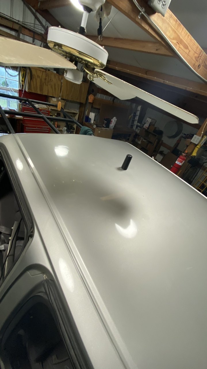

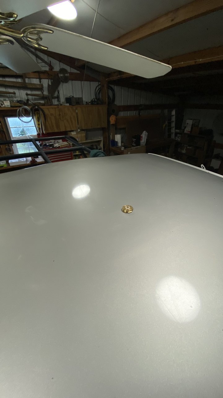

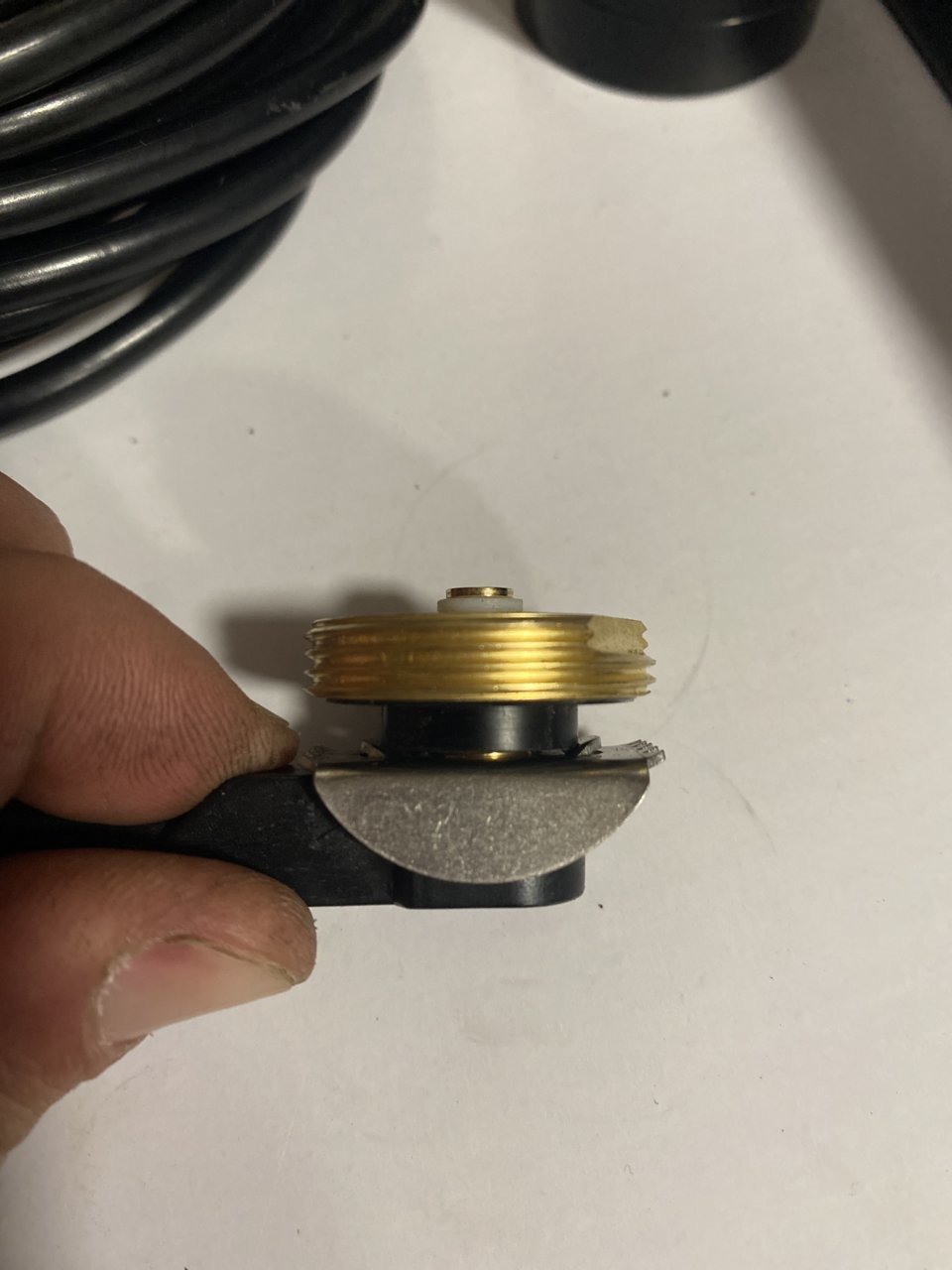

    Today I put a hole in my roof for an NMO mount for the antenna. I’m very happy with it, providing it doesn’t leak!
    B3157E2A-675C-4D74-93EB-35CAADD31BCC.jpg 0AEE349A-281C-4E56-AECC-F0CC48367CE2.jpg

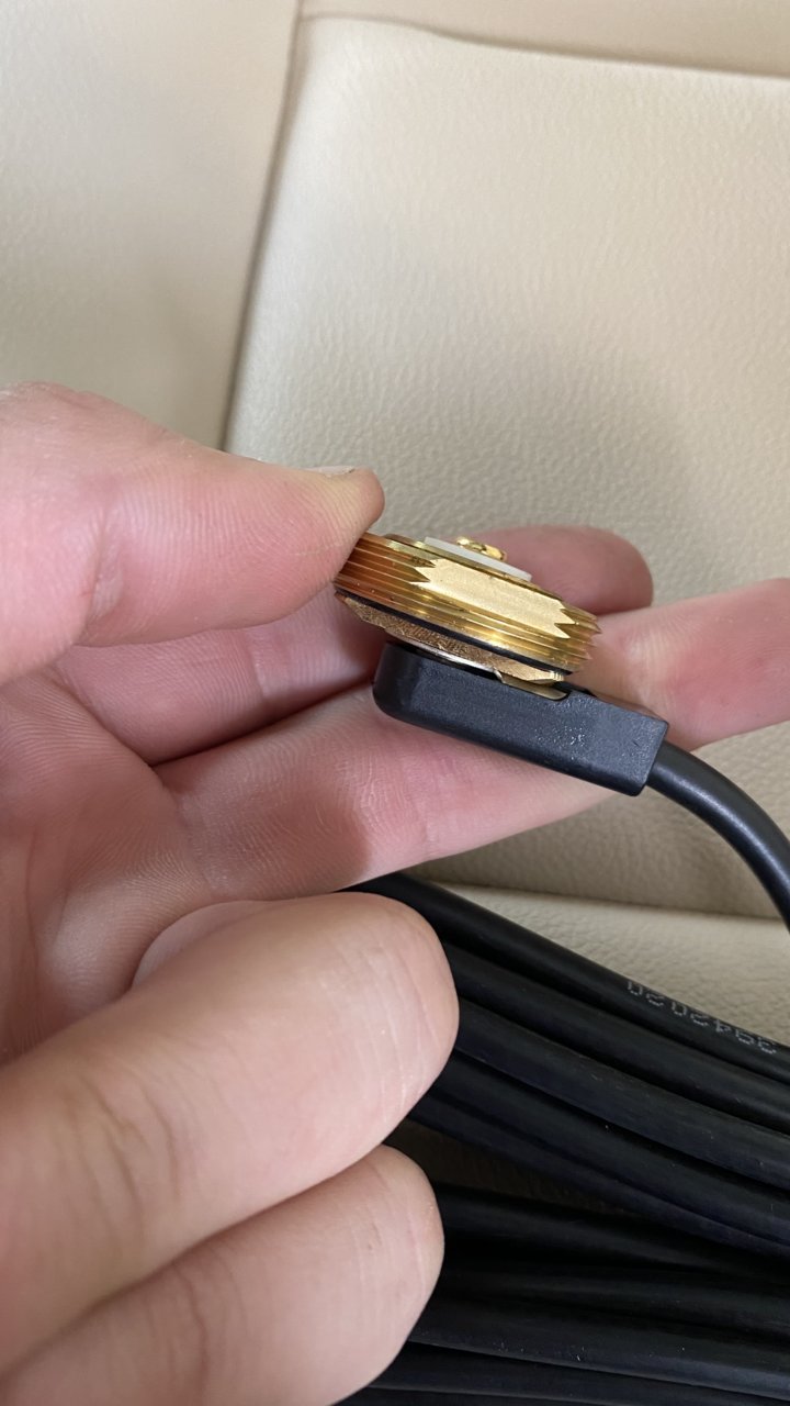

    It turns out that the NMO mount I got from Midland was not going to work in my roof and once I made some phone calls this morning, all my confusion was set straight. When I ordered the “Farm Tractor Bundle” kit from Midland, they included a thick mount NMO that is designed to mount to a 1/4” thick bracket. I had intended to use the supplied NMO and antenna on my truck and forget about the mount that came with the bundle. If anyone is reading this...DON’T DO THIS if you plan to drill the roof and use the NMO. You’ll have to do what I did and run all across town trying to find a normal NMO mount. Below are two photos comparing the thick mount NMO to the standard NMO. You need the standard to mount in a vehicle roof. Nowhere on the Midland website did I see that I was getting a thick mount NMO.

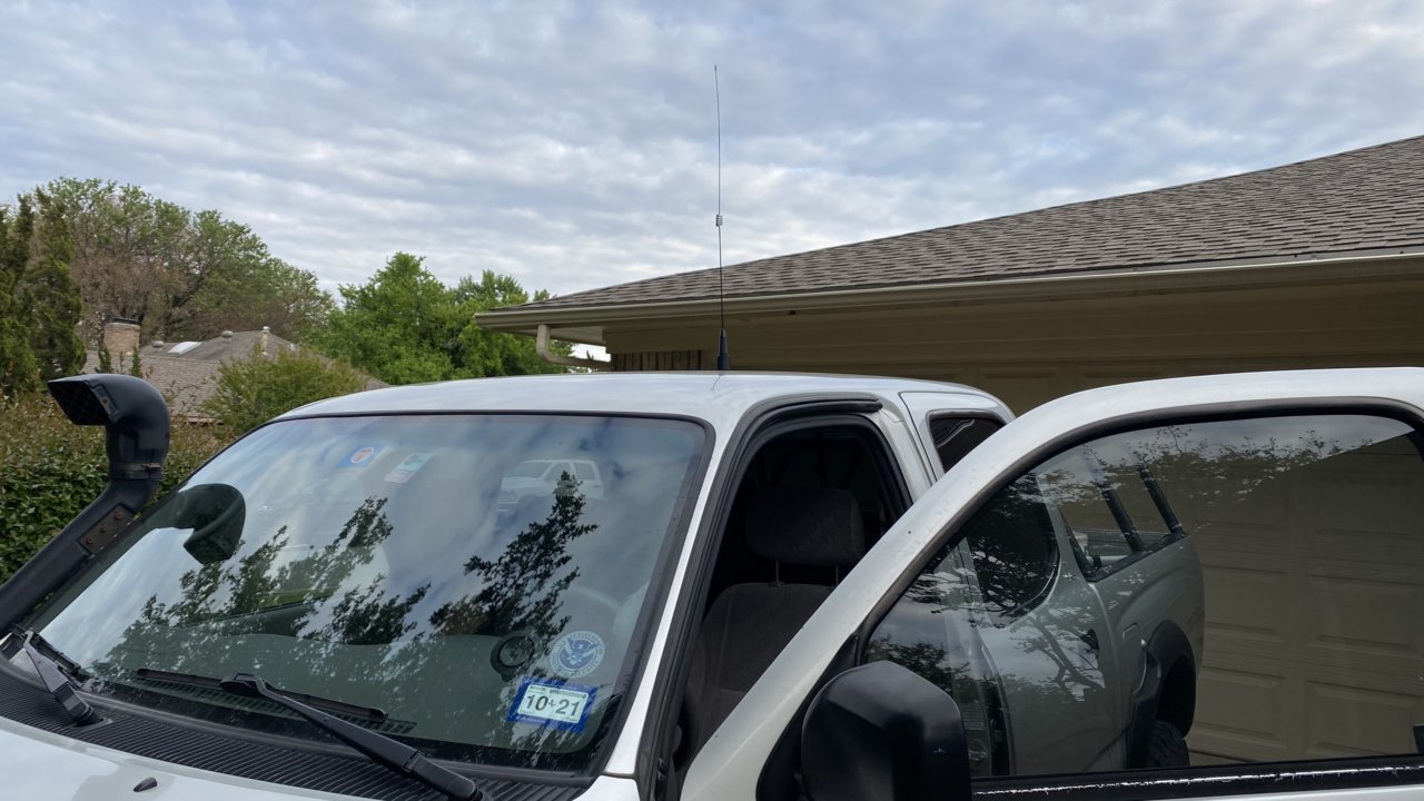

    larger antenna arrived today and I’m interested in playing around to see how much of a difference it makes compared to the stubby antenna.
