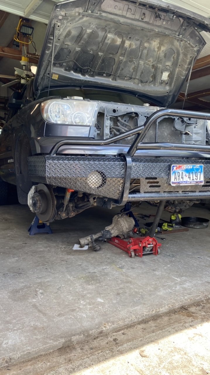

    New steering rack for the Tundra arrived today. Big box!

    Wrenching on the Tundra...

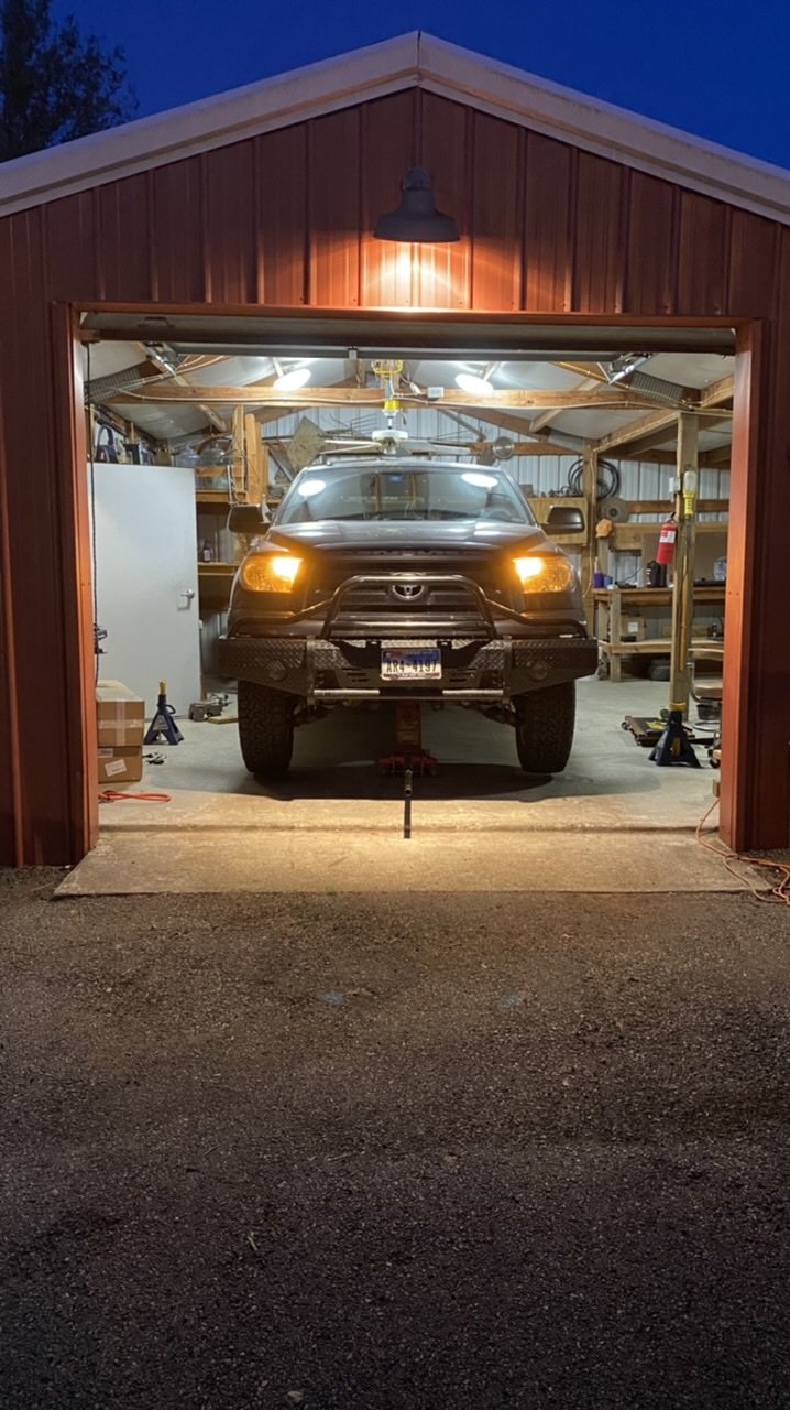

    Today I got the diff reinstalled with the help of a couple friends and finished my steering rack swap. Boy did that job suck. Off to the alignment shop in the morning, then if only I can get my 4wd working on the Tundra I’d be in good shape!
    Every time I jack up the Tundra I think how mean it would look if it was always that tall...then I remember that I’d probably go broke buying tires and gas, not to mention other suspension and steering components that would probably break/need replacing.

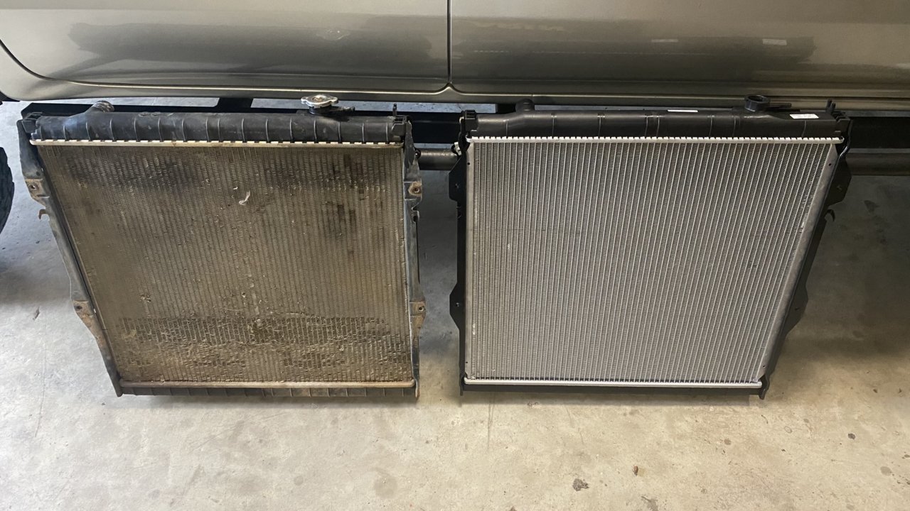

    Then, this evening I installed the Corolla thermostat and a new Denso radiator on the Tacoma. Then I broke off one of the mounts for the front skid plate....going to try to get that welded up after work tomorrow. The truck is running on average 10° cooler. I drove 30 minutes down the highway and it stayed right at 174.2° with occasional minutes at 176.0°. :woot: I’m excited to monitor it as the summer rolls around. Before, my engine was running around 186-190 so I think this is a great improvement...so far

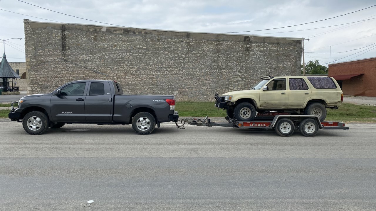

    I went and got my old 4Runner from the ranch today. In the past year and a half that it’s been down there I never had a mouse problem....since the last time I drove it, they moved in to the engine compartment and chewed the main ignition wire going to the distributor along with some other small gauge wires that I think will be easy to repair. Luckily it has a winch on the bumper and I was able to use that to pull it up onto the trailer. I filled the airbags to 35PSI to level the truck and cruised home. I even got out my tape measure since this is the first time I’ve towed with the bags. The truck is dead level even though it looks slightly nose-high. Those airbags are sweet! The Tundra rode so much nicer than the last time I towed something heavy with it. It towed beautifully at 65-70mph, for a gasser

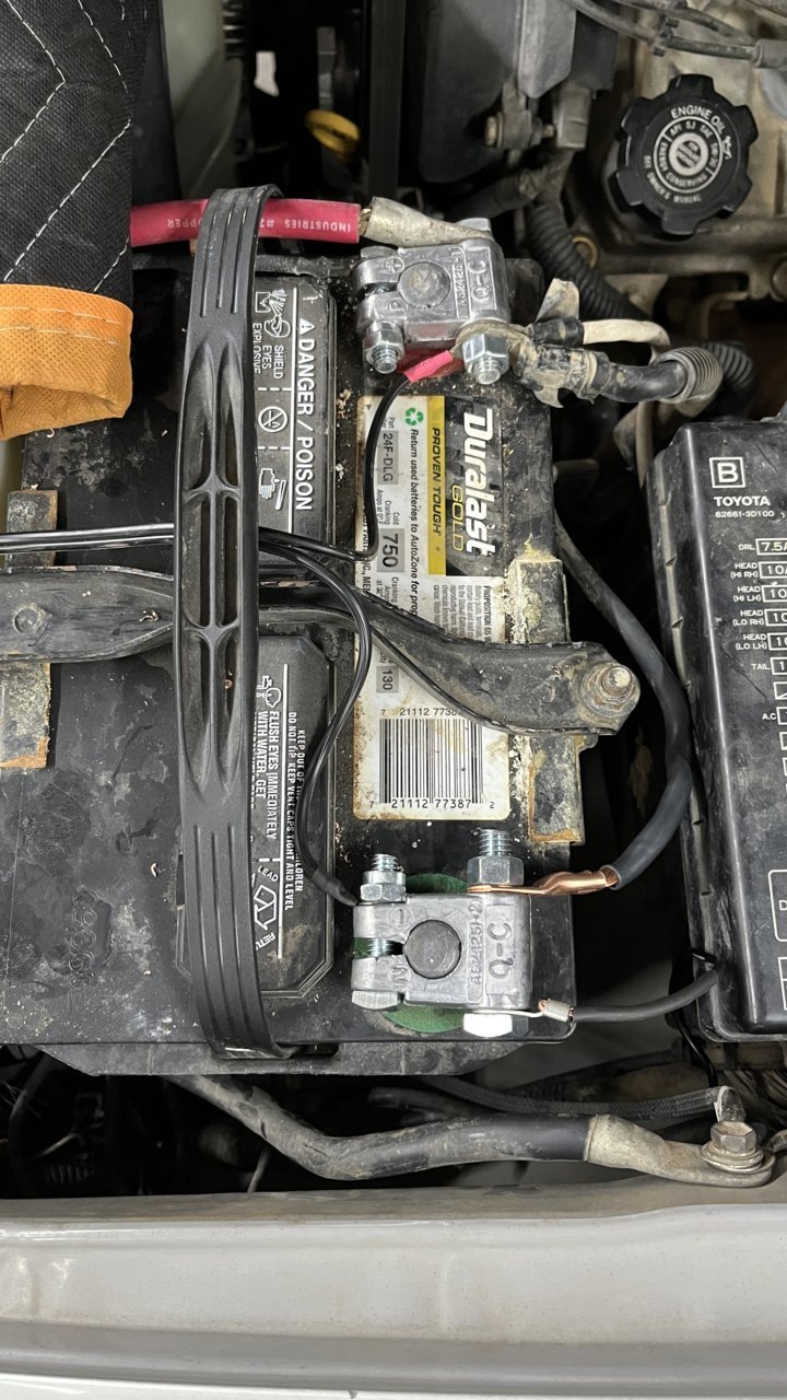

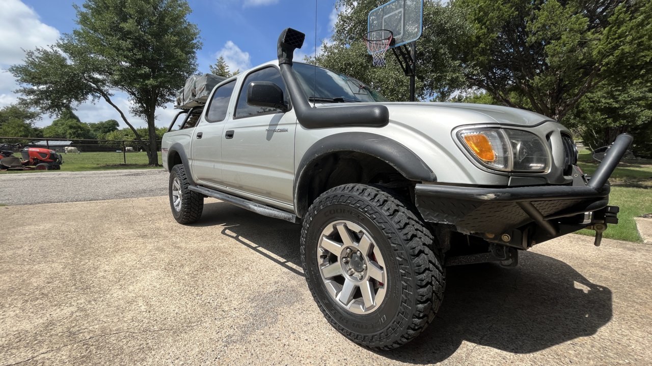

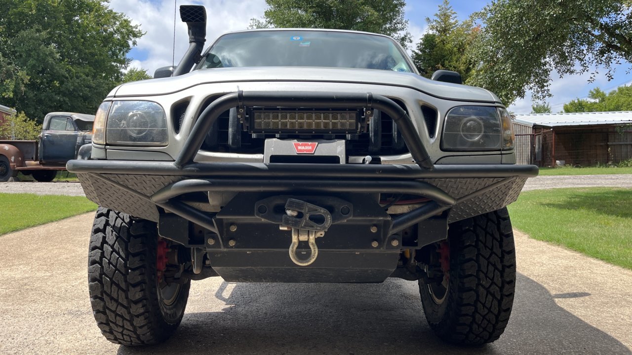

    Installed some 255/80/17 Cooper ST MAXX tires and some military style battery terminals today in preparation of a Colorado trip coming up.

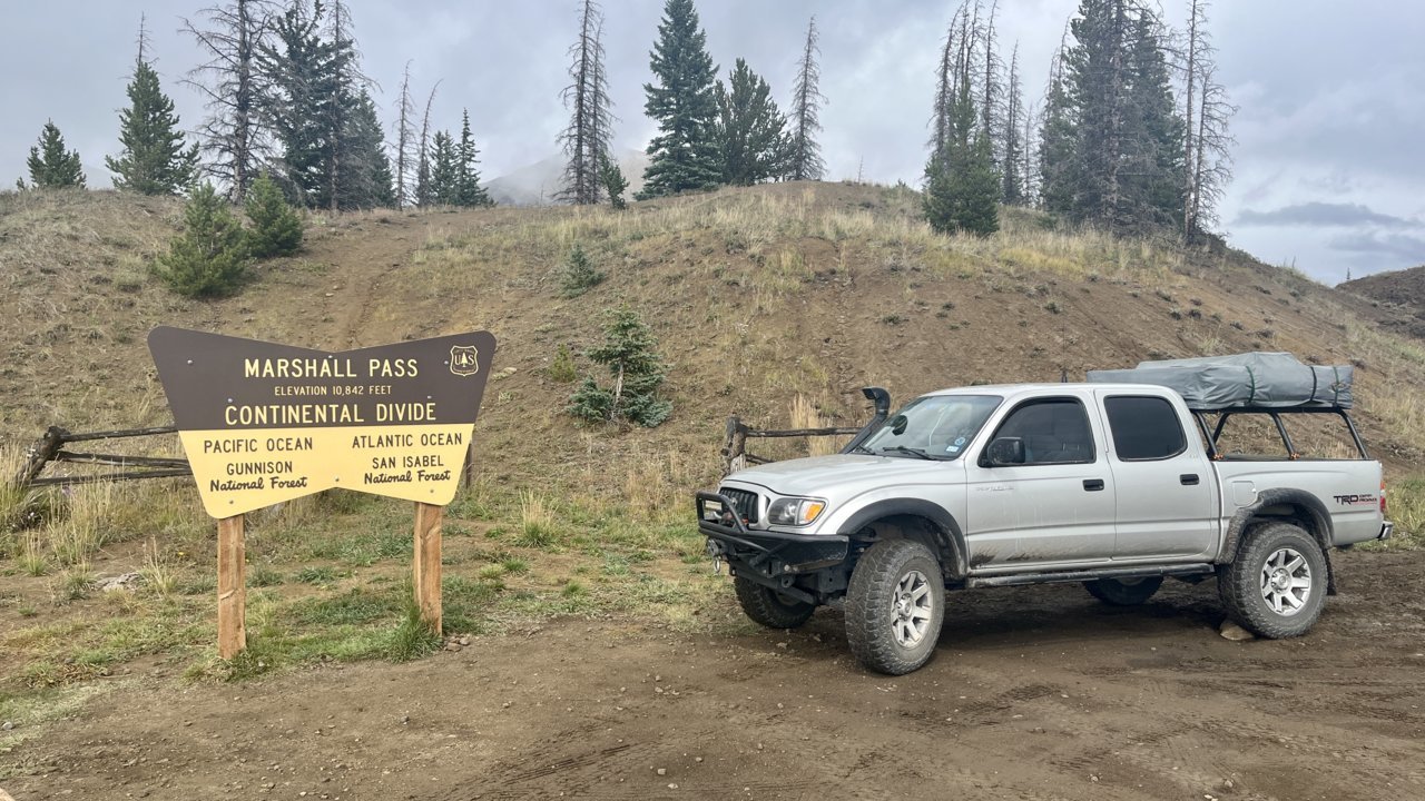

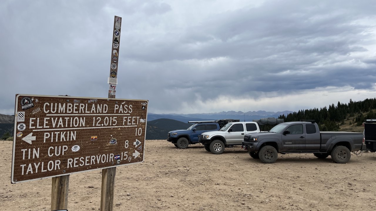

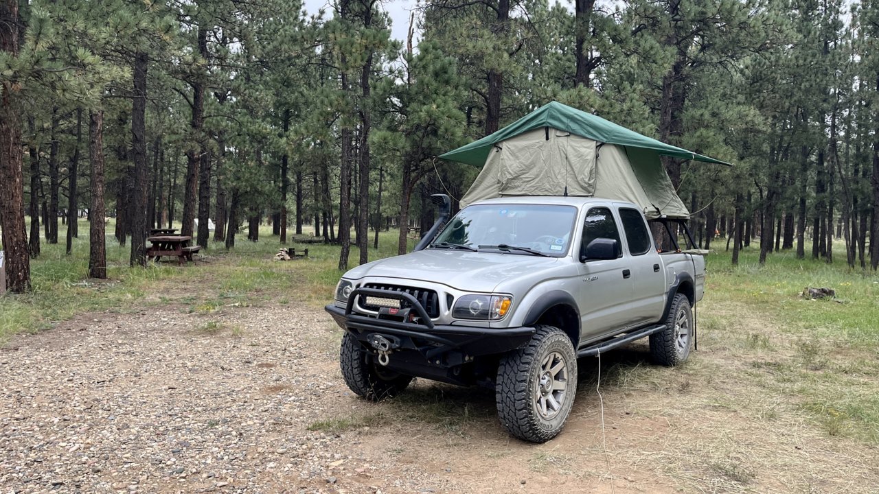

    Some pictures from the Colorado trip past week
