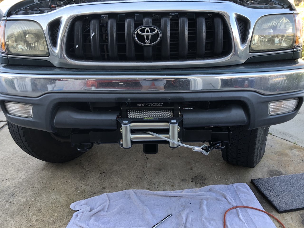

    A little work done the last few months. I am planning to switch out my front Tundra brake lines to solid lines but no time.
    In the meantime. A hidden hitch has been added.
    Build thread here. https://www.tacomaworld.com/threads/hiden-winch-well-sort-of.645807/

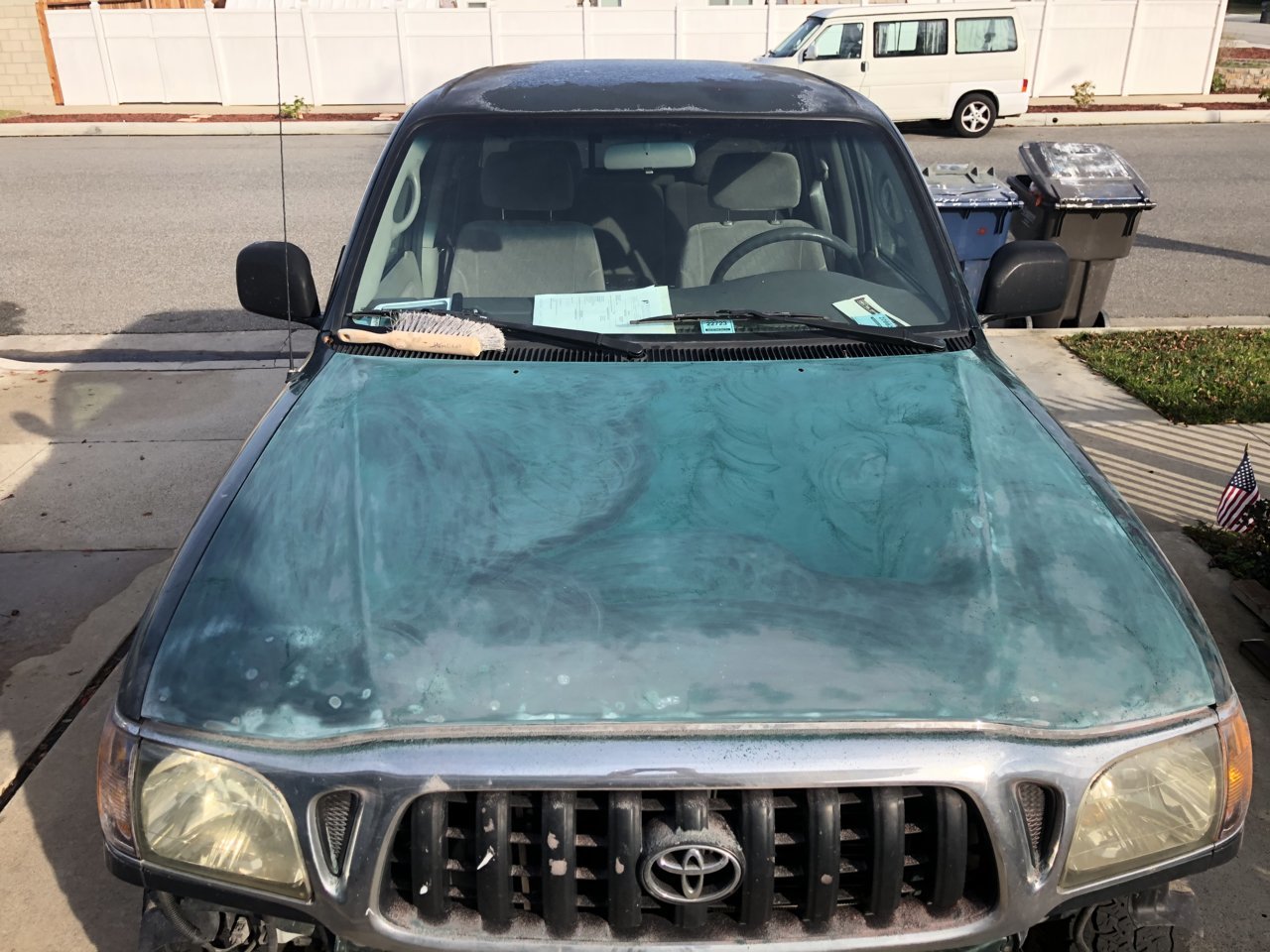

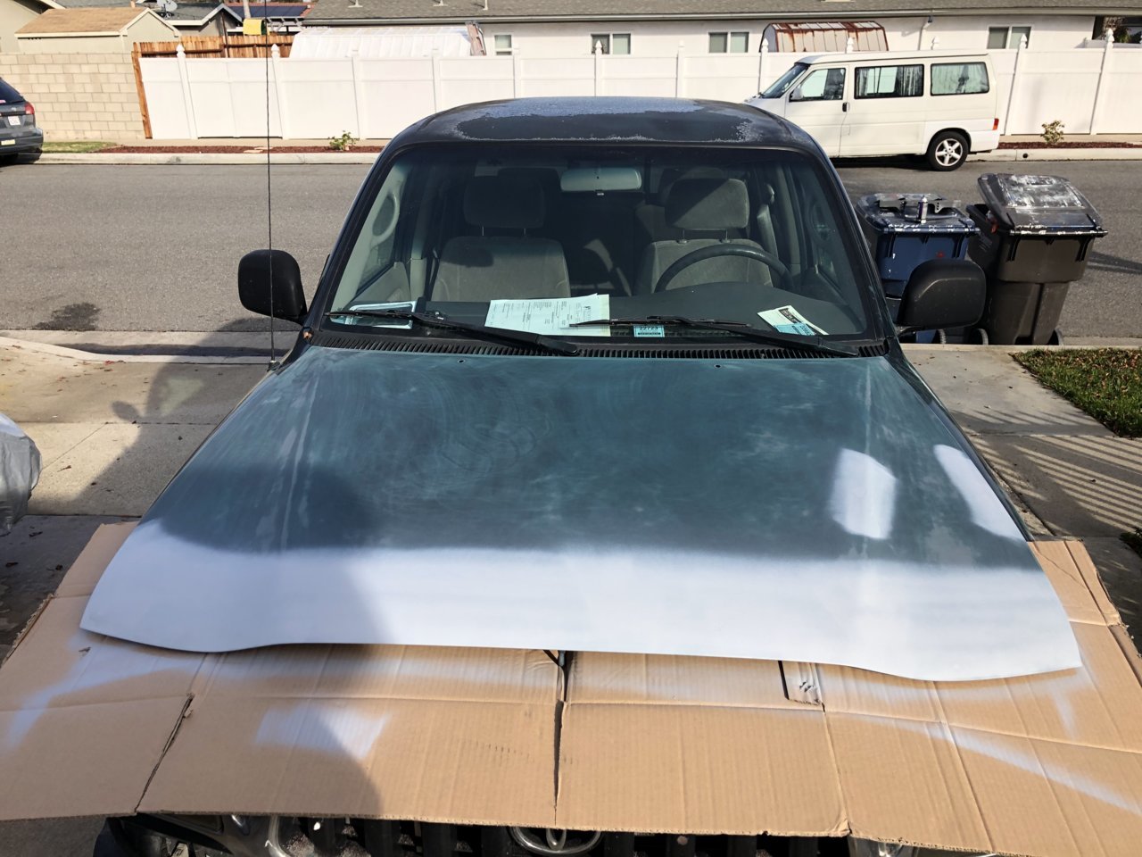

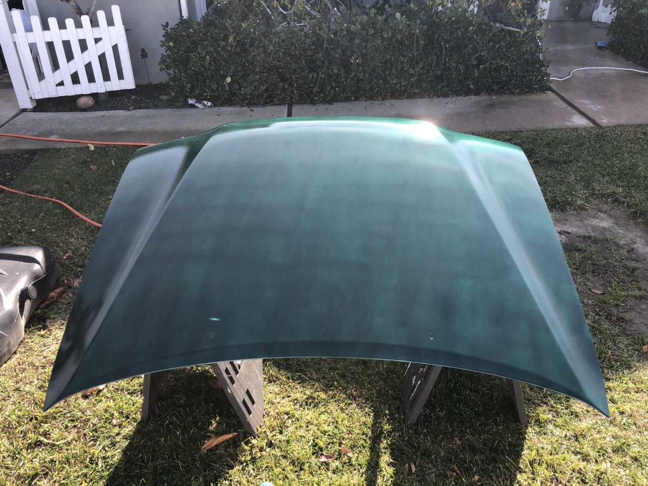

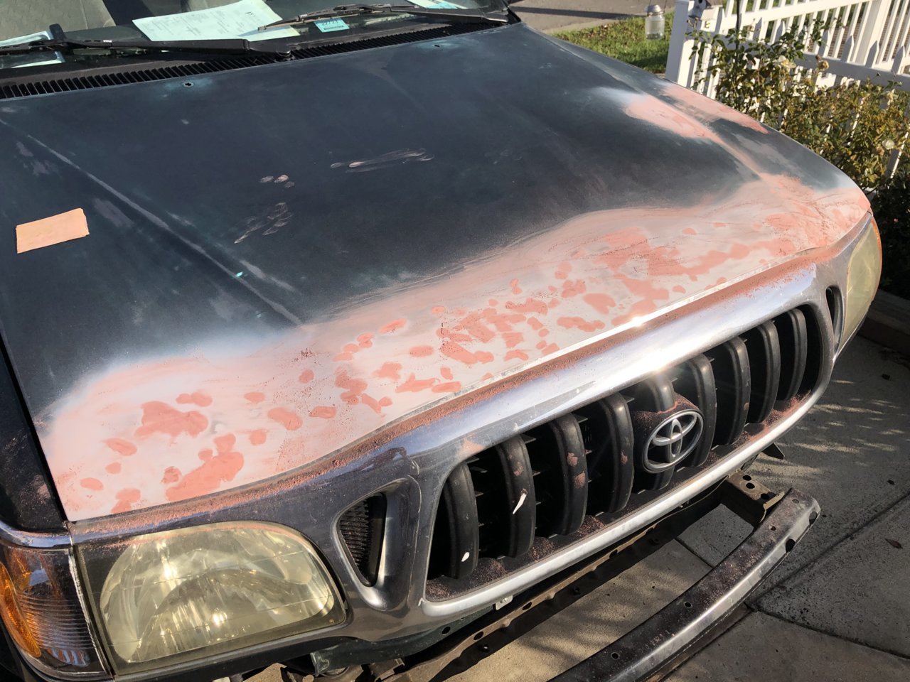

    Repainted the front hood to stave off rust from the failed clear coat.
    Rough sand, Grind out the chips with rust started, fill them, primer, sand and paint. I tried to use pre-mixed rattle can paint but one can was not enough so i will have to re-do it. This is the warm up for the roof which is getting bad.

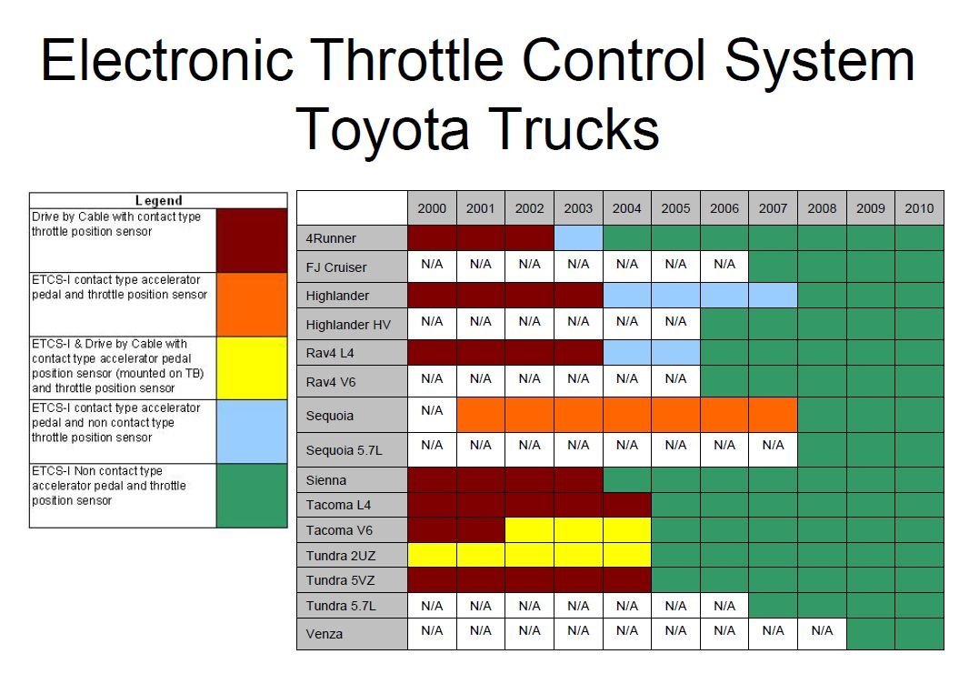

    Found this on a previous forum, looks to be that the 02’s had the same ETCS-I.
    When I searched valve body on toyotapartsdeal.com the 02 and 03 parts look to be the same too. Is there a way to check this on my truck: ie you guys have a photo of the 03-04 valve body so I could compare?
  13. Dec 8, 2020 at 6:39 PM
    #133
    04Pre_Runner
    Feb 9, 2017
    #210143
    4,878
    Andrew
    2004 DC Tacoma SR5 4WD V6
    If you have a transmission cable on your throttle body you don’t have the ETCS-I.
    BartMaster1234 likes this.
