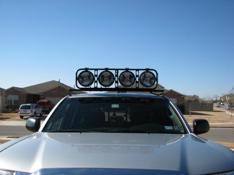

    I bought the brackets from another member on here and bolted them to the roof rack channel sheet metal. Then I sealed it up with clear silicone to keep the water out. Its been solid since there is a second bar on the middle of the truck that provides three points of contact for the light bar. No issues as of yet.

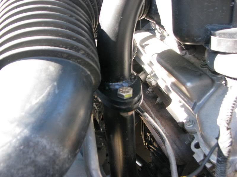

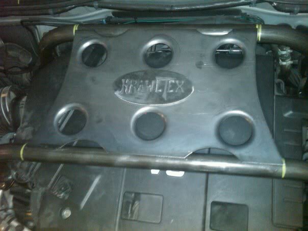

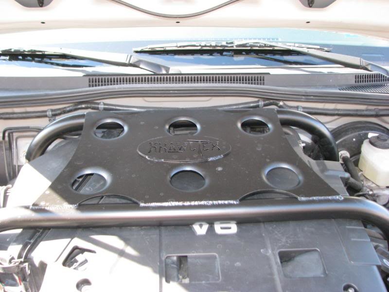

    Here is how the engine cage is coming. There will be some more bracing added to the plate and two tubes. It will use sandwich plates to be removable instead of tube clamps.
    The light bar is done and mounted as well but no pics.

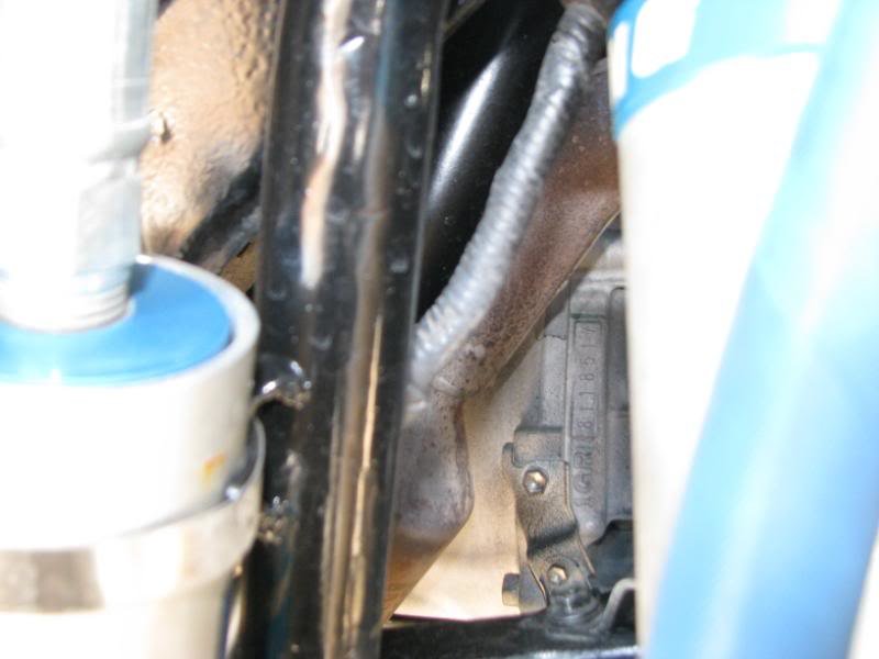

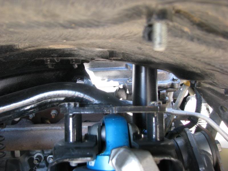

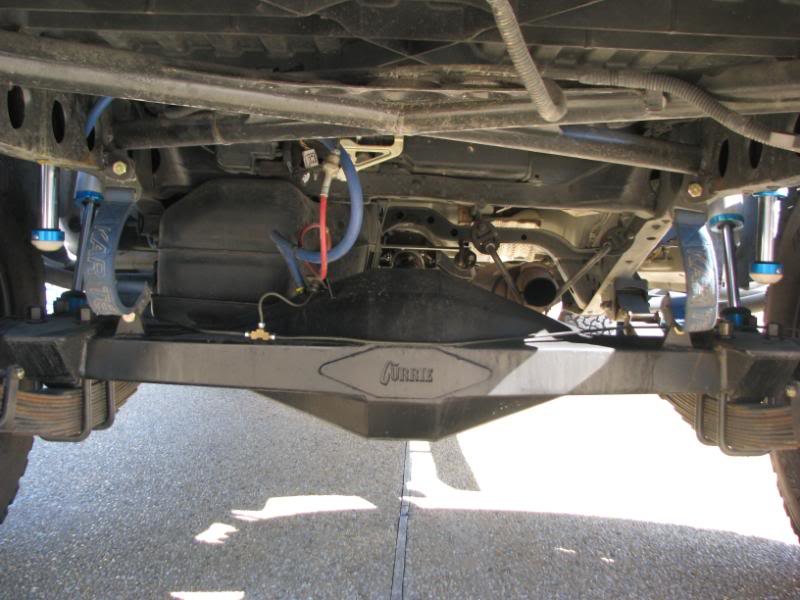

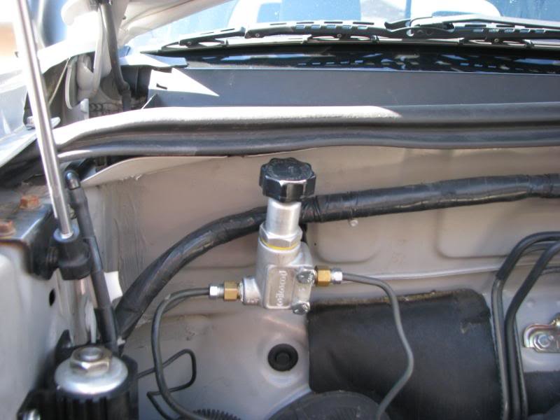

  10. Feb 13, 2011 at 11:13 AM
    #210
    06HAOLE
    06HAOLE [OP] Well-Known Member
    Jan 4, 2008
    #4102
    3,190
    Fort Worth, TX
    2019 Ford Raptor

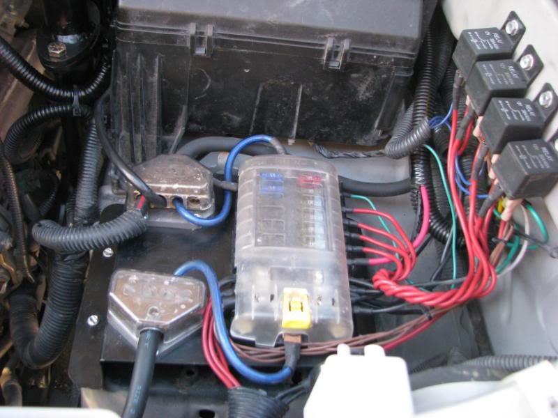

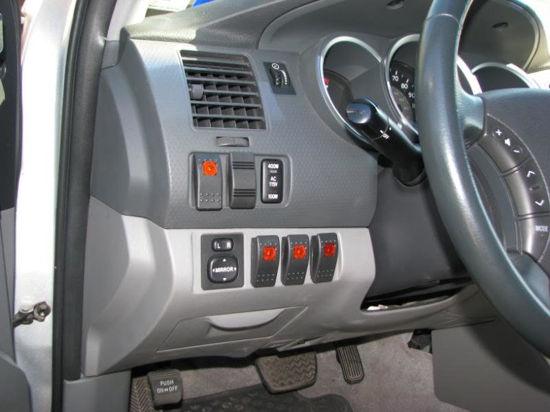

    Here are some pics of recent work.
    -new light bar
    -added dist blocks
    -new switches
    -wired in line lock and prop valve in a better way
    -engine cage
    -moved brake lines on axle to center so they dont hit limit straps
    Light shot is with unadjusted lights so the pattern is crappy. I will take a better pic after they are aimed and adjusted. My head lights are not even on in this picture. Its all HID light.

    SWEET truck! Its cool to see a full on LT setup on a truck here in Texas. I was wondering if there were any awesome trucks like this close to wear i live, as i thought it was mainly California and Arizona. Your build makes me want to get LT even more. I was checking out your build on the Krawltex website and i was just wondering what the engine cage is for?
  18. Feb 18, 2011 at 7:29 AM
    #218
    mjp2
    mjp2 Living vicariously through myself Moderator
    Feb 16, 2007
    #924
    22,015
    Milton Juevo Portimous II
    NJ
    Current: '21 Bronco Badlands. Previous: '06 TRD Access Cab, v6, 6-speed
    It's to make me jealous. ;)
    It prevents the frame from twisting and keeps the coil buckets from buckling in towards each other on hard hits.
    Abuse fatigues stuff, so the more reinforcements, the better.

    Thanks, that makes sense now. What happens if you have to get to the engine to work on it?
  20. Feb 18, 2011 at 8:18 AM
    #220
    mjp2
    Feb 16, 2007
    #924
    22,015
    NJ
    It comes right out with a couple of bolts. :)
