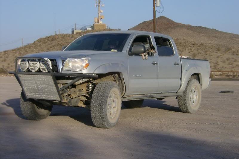

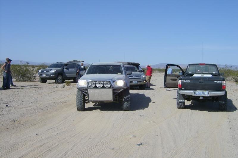

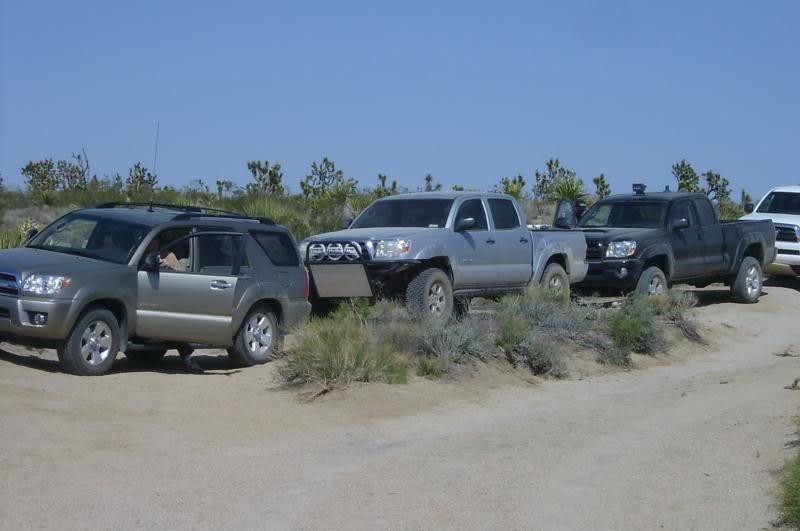

    Here are a few photos from the 1st Annual Mojave Trail Run

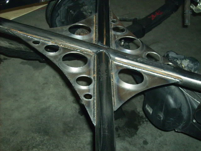

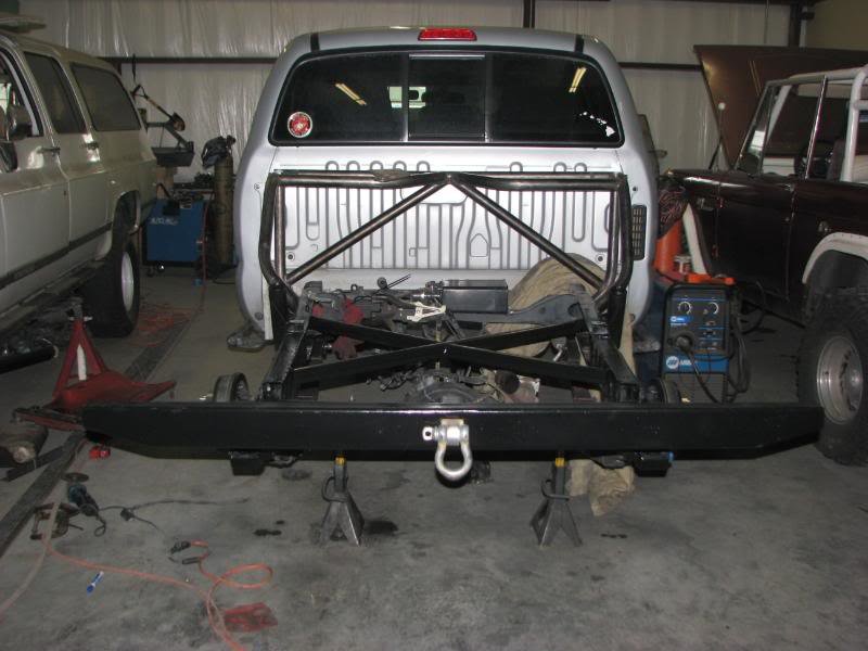

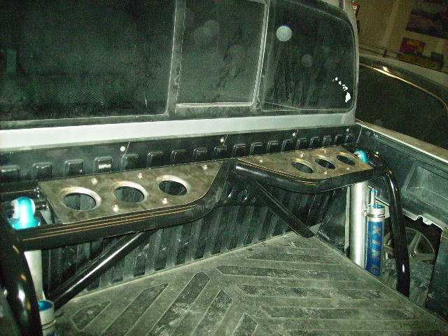

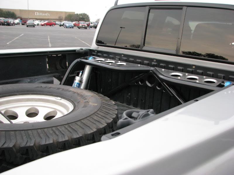

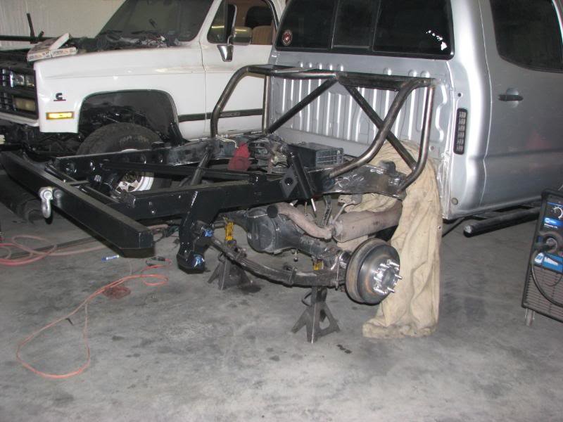

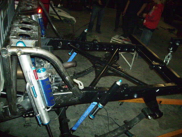

    Here is the almost completed rear end build. It has been a very long 3 days in the shop.
    To do:
    • Cut two more plates to finish boxing frame
    • Cut holes in bed for bed cage and shocks
    • Cut plates to box in top of bedcage
    • Make tabs for limit straps
    • Make bracket to reinforce bedsides
    • Make many gussets for bling factor
    • Relocate exhaust to clear addtional uptravel
    • Finish painting frame and bedcage
    • Mount bypasses and bumps
    • Mount gas tank
    • Bolt up shortened driveshaft
  4. Dec 24, 2009 at 4:06 PM
    #24
    06HAOLE
    06HAOLE [OP] Well-Known Member
    Jan 4, 2008
    #4102
    3,190
    Fort Worth, TX
    2019 Ford Raptor

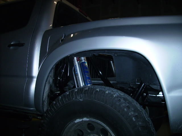

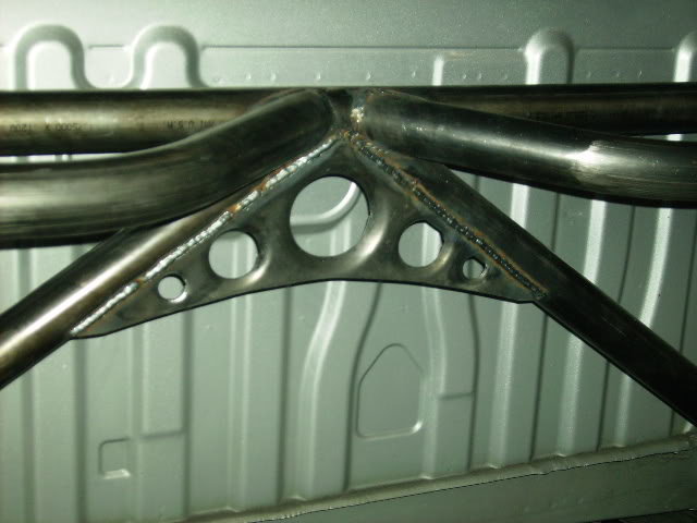

    Some detail stuff

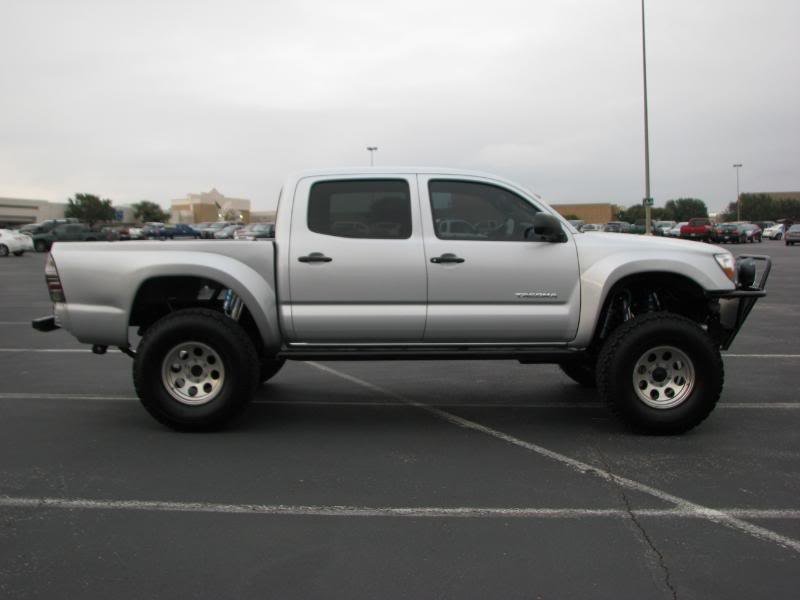

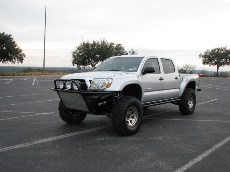

    I had to add a few more when shes all clean. Its a little nose high but not too bad.

    The stance is perfect and I wouldn't change a thing. :thumbsup:

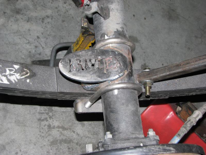

    Have you contacted the fabricator about the rear bump strike plate issue? Any warranty on that work or just going to fab up a larger plate at your cost?

    so did you find out what your doing on the rear bump stops ? just longer pads ?
