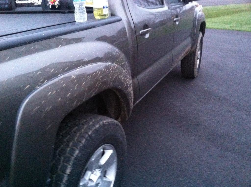

    Scraped the living hell out of my front passenger fender the other day. About a 1.5ft long scratch all the way down to the plastic. :( too bad bushwacker flares are so expensive. Maybe I'll see if I can score a cheap set somewhere and hit them with some bedliner..

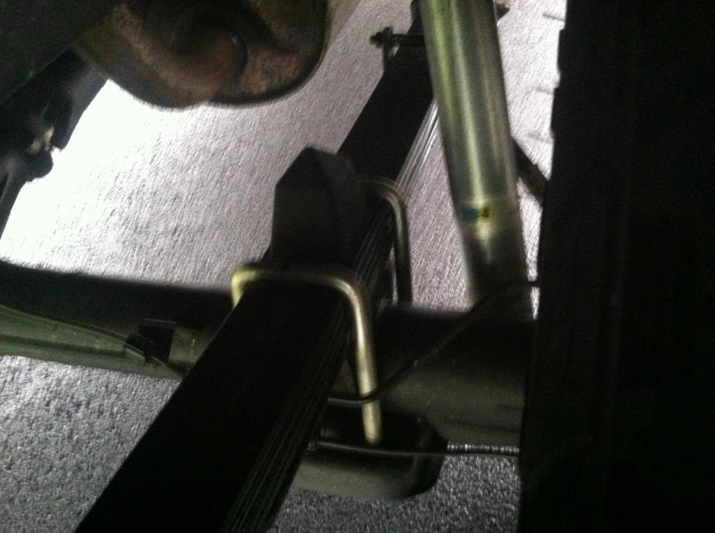

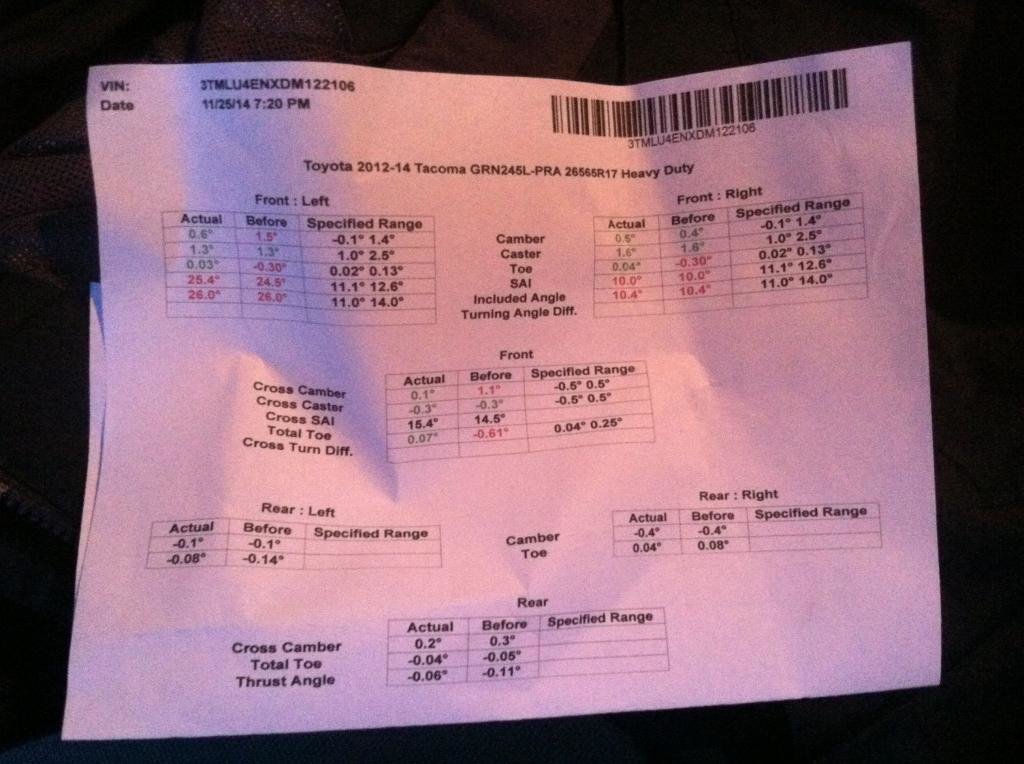

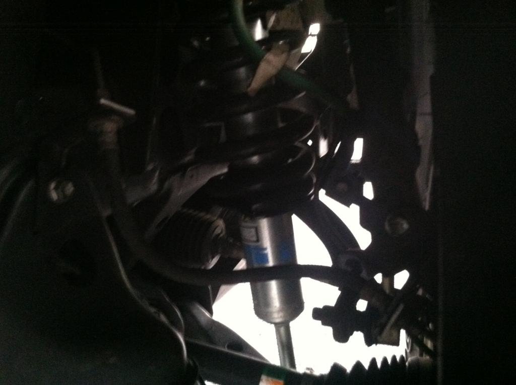

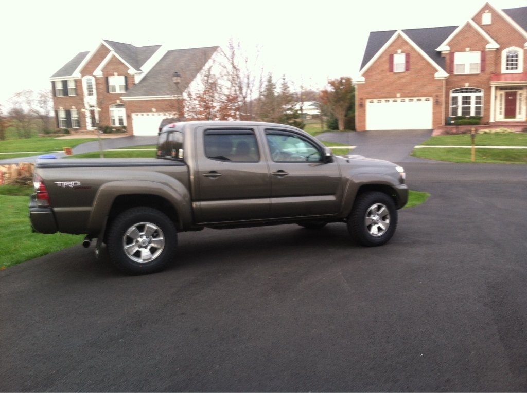

    ALRIGHT, so, long needed update. Been super busy lately. :eek:
    Last week (Sunday and Monday) I met up with Skygear at his place in NoVa and got my lift installed. After fighting with NTB to have the front struts and coil springs assembled, I ended up renting (buying) a spring compressor from Advance Auto. The guy at NTB said the spring was too long, so when it was compressed it curved and contacted the side of the strut.. I looked at it with Skygear for a few minutes and we noticed that the guy had the bottom cup/seat upside down :rolleyes:
    Anyways, we got the front driver's side done in about an hour and a half. Got the front passenger side down in about an hour. When reassembling the passenger side though, disaster struck in the form of stripped bolts. The two bolts on either side of the LCA ball joint got stripped and wouldn't go in. After talking to another local member who works at a dealership, we learned that those two bolts are an M16-1.25 which is a specialty bolt only made by Toyota, and they are only available to Toyota dealerships when hand released by Toyota of America. Eventually ended up using a dremel to re-cut the threads on the bolt and got it all back together. Rear lift took about two hours total on Monday night.
    5100's on all 4 corners, OME 885x coils, and Wheeler's HD 3-Leaf progressive AAL. Front went from roughly 20.5" hub-to-fender up front to 23", and roughly 23 to 24.4" in the back.
    Pictures! :D :bananadance: (It was dark most of the time so I dont have any from the install)
