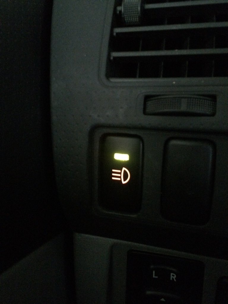

    Small victory of the day: swapped out my fog light switch for an FJ 6-pin switch. a little cutting with the dremel and a little soldering, and now I have a fog light switch with an indicator light without the headache of switching out the 4-pin harness to a 6-pin. :woot:
    All in all, cost about $60, but had to buy the diode, heat shrink, and some more solder along with the switch.

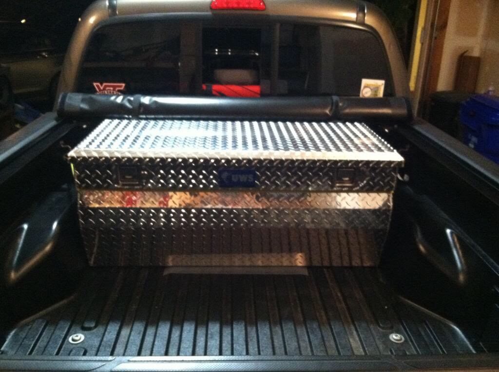

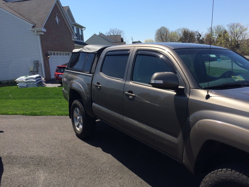

    As far as the box, I only have these two other pictures on me at the moment. I'm out of town at the moment, but I can definitely take some others if you want one of something specific!
    The box is a UWS TBC42W tool chest. I got it from Amazon: http://www.amazon.com/UWS-TBC42W-Wedge-Series-Truck/dp/B0017HB3X8
    It fits perfectly between the wheel wells of a shortbed (48" wide and the bed is 50" at that spot) and is the exact height of my tonneau. I think without the tonneau it's about a half inch taller than the bedrails, but I don't know for sure. I originally had it Jerry rigged to the bed rail along the back of the cab with some galvanized steel strapping and some bolts, but I wanted to clean it up some so I ended up drilling two holes in the bottom and mounting using the existing bed-frame bolts. It's solid and isn't going anywhere, but also only takes about 3 minutes to take out by myself if I have the need. It's been a very well used investment. Lol
    If you don't have a tonneau and want a really low profile (and a shortbed.. I'm on my phone so I can't really tell) the UWS TBS52SPLA (I believe that's the right one) is a typical crossover style box, but it's made for a step side ford ranger. It's the same width as the bed, and fits like a glove between the wheel wells. I.E. It sits on the bed between the wheels, and comes up and over the top of the wheels. It's the setup I was going to originally go for but I wouldn't have been able to open it because the rails on my tonneau stick out a little bit.

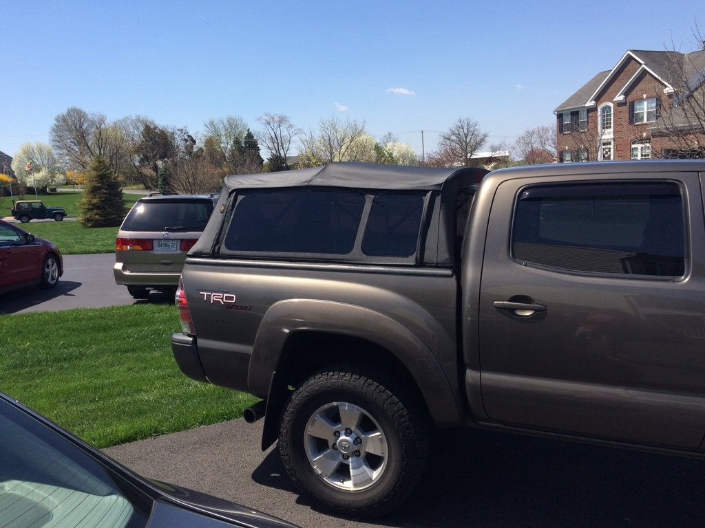

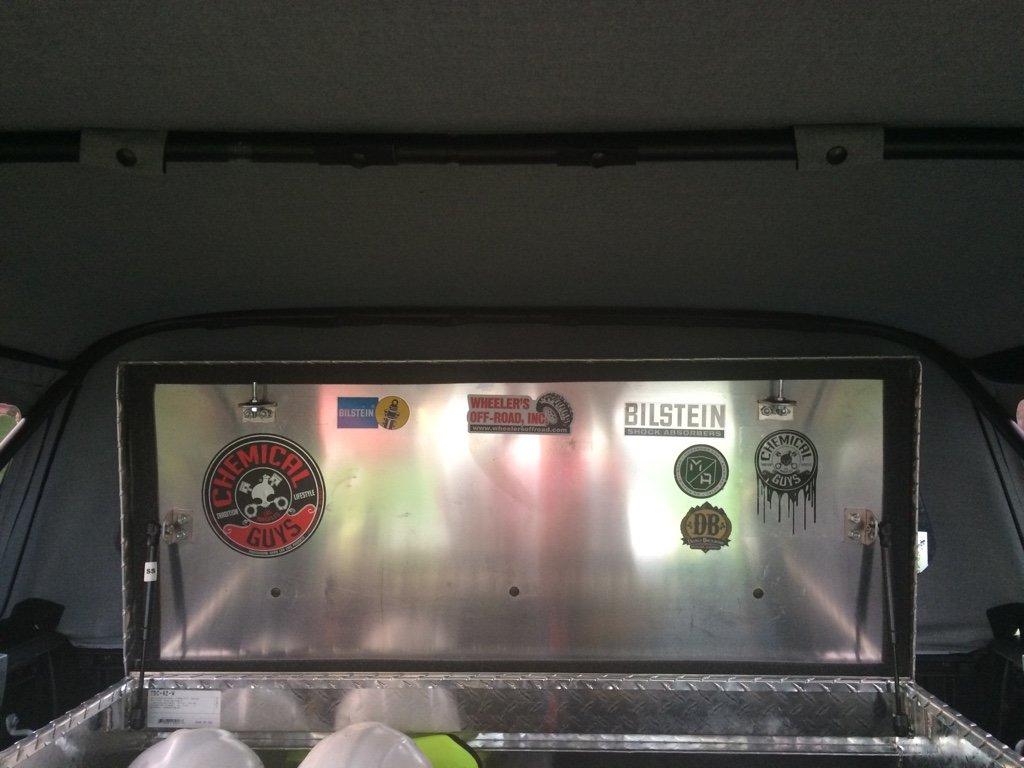

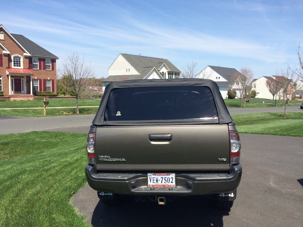

    Installed this bad boy yesterday!
    And my tool chest can still easily open with plenty of room to access and open the lid.

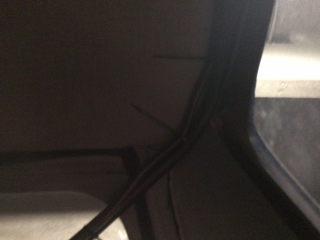

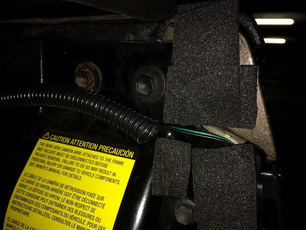

    Wired up the third brake light today. Sort of a pain in the ass just because of how I tapped into the tail light and having to extend the wires, etc. Rather than screwing the brake light to the topper frame I just zip-tied it in place. It seems pretty stable. Extended the wires, tucked them inside a wire loom and ran them down along the edge of the frame, along the bottom of the side rail and tied it into the tail light. I need to find a more permanent solution for running the wire loom along the side rail, but i'll deal with that later.

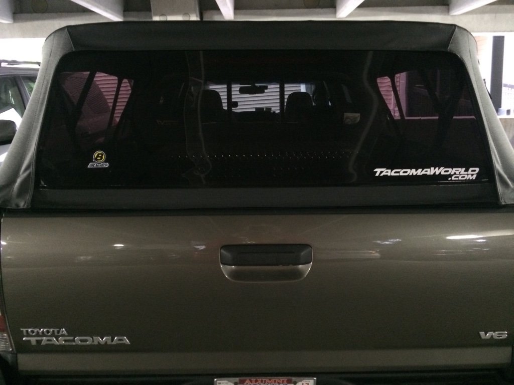

    prettied up my 3rd brake light wiring today and added some quick disconnects. Also put a new TW sticker on my Bestop :woot:
    Heading over to Skygear's place on Wednesday to help him install some LCA's and with his on-board propane endeavors, so I may have him redo my shitty soldering on these disconnects..
