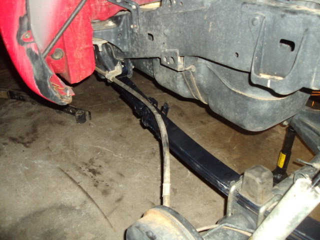

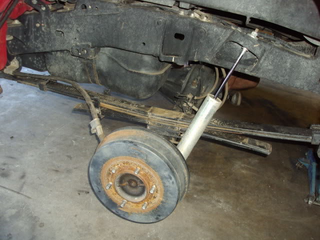

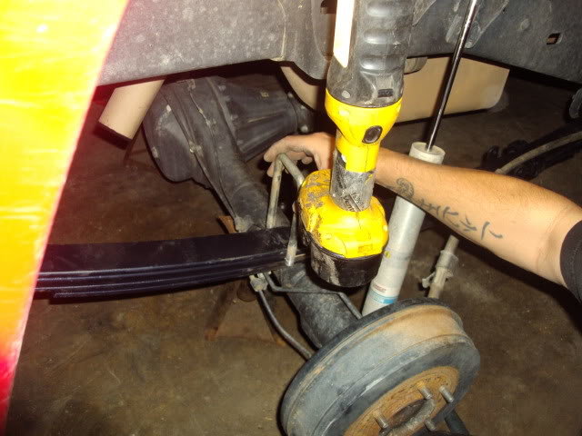

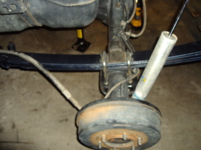

    Well out with the old & in with the rebuilt, we got them done about 90 mins ago.....

    Before......
    After.....
    have better pics just gotta find, anyway hopefully this will achieve what matt was looking for , minimal lift with firmer ride, personally I think we need to shorten one spring &/or add one more, we'll see how it does for him this weekend...

    were those bolts holding the leaf pack on the shackle stubborn???

    No, just tight (as they should be ;)) He did gain an extra 1.5"-2" lift but we were really shooting for firmer ride & I think we got it , def. much better than the AAL that was on it... He's going to romp'em this weekend & give me some feed back, actually I'm glad it didn't lift anymore than it did , he's about at the end of his rear 5100's travel...
