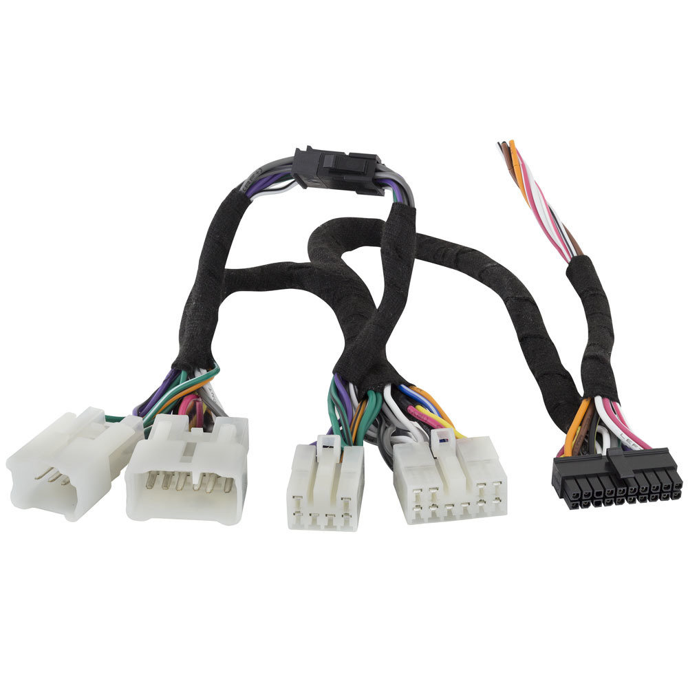

    Does anyone know of a "T" type adapter harness that plugs into the back of the radio and then accepts the factory radio harness so that nothing has to be cut? Something like this attached image perhaps?
    Thank you!
