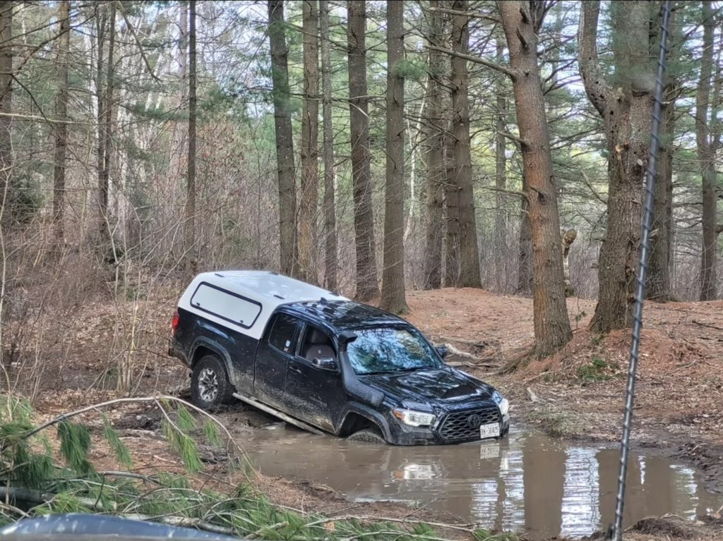

    Also just had the starter start acting up, so that was done as well. I had previously sunk the truck in a mud puddle and submerged it, so this isn't the trucks fault, most likely. Also did a CV axle- once again my fault, got the front end bound up in heavy snow towing a trailer in 4 low :bananadead:

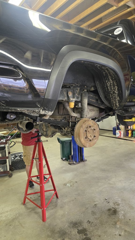

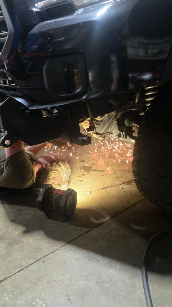

    WELP, jinxed that, diff seal fully went and puked fluid all over.
    As you may be able to tell, replacing it became quite the project. Nut that's tack welded in the frame broke off when trying to remove RCI front skid plate. Bolts are hard as fuck to cut through with a sawzall. Welded in a new nutsert into the frame for now, bolt is smaller than optimal but it'll work for a while. Going to pull all the skids at some point and clean them up as well as clean the underside well.
    Anyways, got the seal replaced, and rebooted the drivers side CV axle while it was out (@Norilsk once again saved my ass :cheers:)
    Did that last night/this morning, and then tonight I installed Icon RXT leaf packs in stage 2 configuration. Rides amazingly, gained about 1.25 inches over Icon AAL + stock pack. Should tow better too.
    (Thank you @tacoma16 for getting ubolts made for me!)
    Truck drives great, needs a alignment though. Front end is a little bit noisy, I think it's ecgs + cupped front tires. I'll know for sure when the snows go on come winter. For now, gotta just chill and drive it, can't be dropping 3 grand on this thing every month...

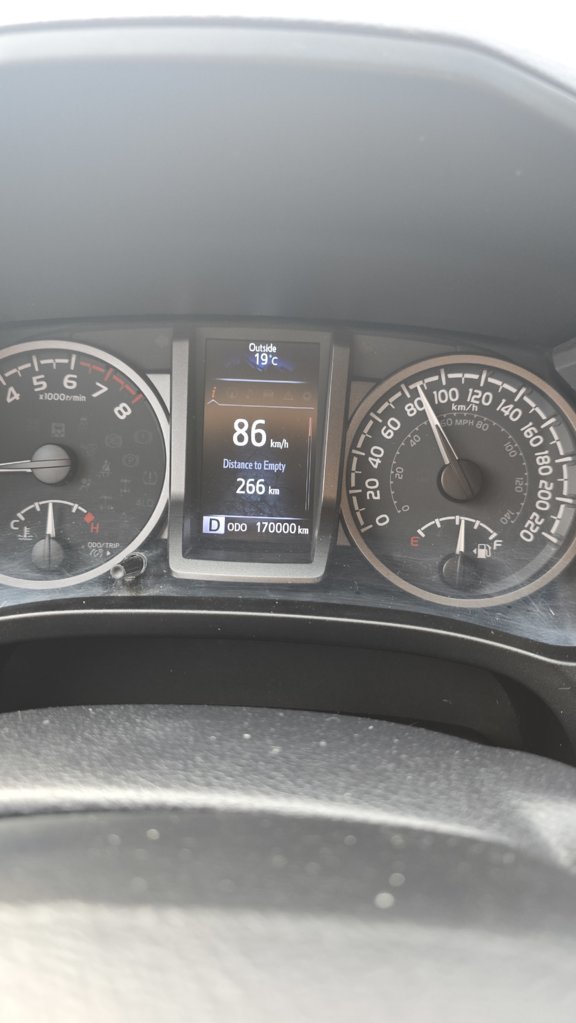

    Hurray for 170k km (105k ish miles) though!

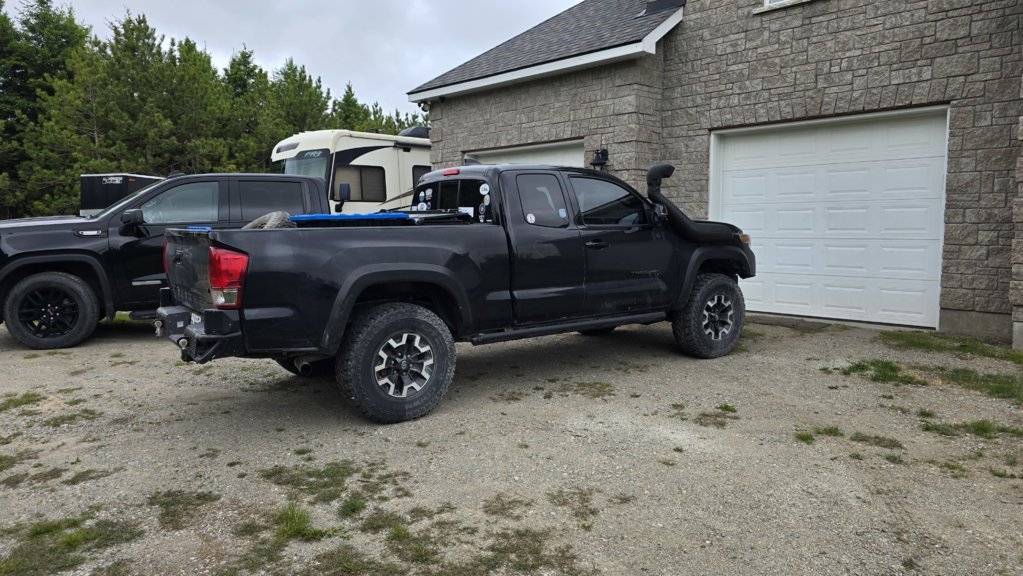

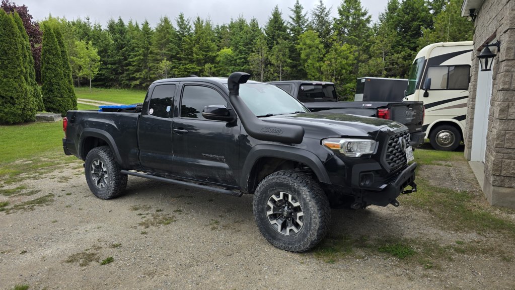

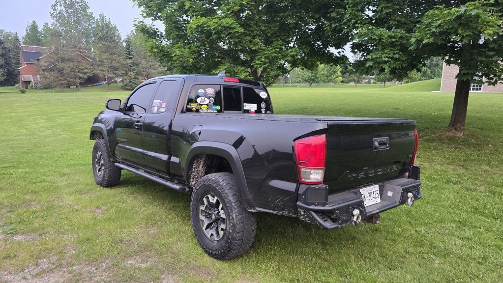

    How's the rake? Looks to be quite a bit of height in the back
  7. Jun 8, 2025 at 4:07 AM
    #127
    MaverickT883
    MaverickT883 [OP] Paintless
    Nov 17, 2020
    #346995
    3,655
    Maverick
    Ontario, Canada
    2021 Tacoma TRD Off-road Access Cab
    Check build thread!
    It's not too bad. Picture is with the truck off camber, having just put in the springs so hasn't settled. It's about a inch higher in the rear now.
