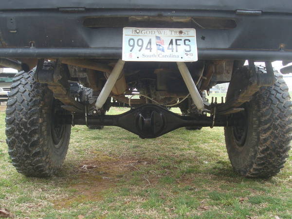

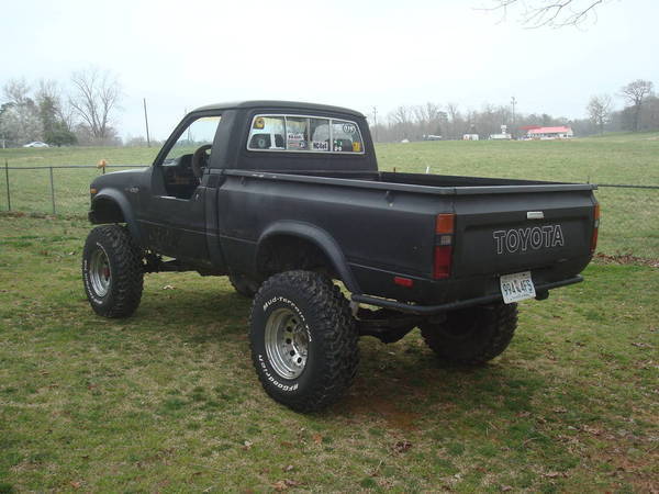

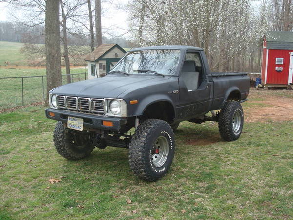

    Got everything finished. New rear brakes, 1" bore MC, LSPV bypass, IFS width axle *fully rebuilt* with new Chromo shafts and 1.5" spacers for the front. Threw the half doors on also since it was nice out this weekend. :D
    One thing I have noticed is the Spartan locker is popping more/louder than it did with the narrower axle. Im guessing it's because that 3" was just enough of change in how fast one tire spins vs the other in turns. Still not bad enough to make me want to take it out though. It feels like the truck handles a little better and rides a little better also.
    *edit*
    And one thing I found out is the 79-85 u-bolt flip plates are narrower than the 86-95, thats because the spring perches are wider in the IFS axles. You can tell in the last pic the u-bolts are angled in a little at the top. Going to take them to class and mill the holes out a little larger one day soon.
