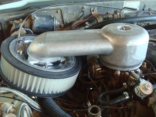

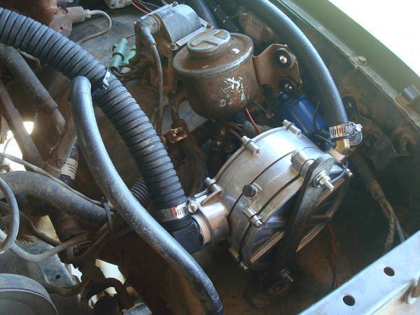

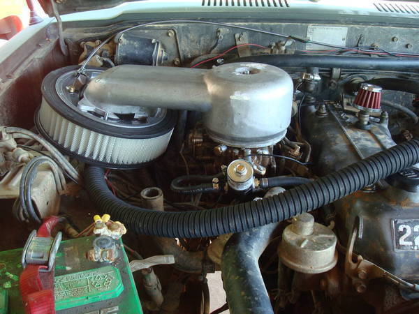

    Still have te carb, there is an adapter that bolts to the top of the carb to run propane. I'll post a few pictures of it.

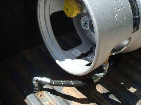

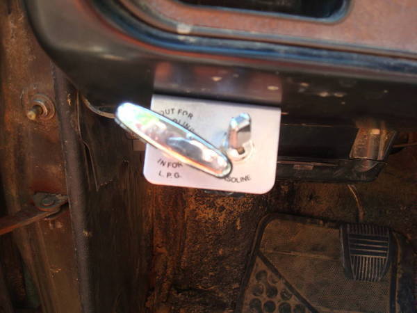

    Truck runs great on both fuels. Switch over from gas to propane takes about 1 minute. From propane to gas takes about 15 seconds.
    Tank
    Pull the knob to run gas (air cleaner opened), push the knob to run propane (air cleaner closed). Switch is for selection of gas/no fuel/propane
    Lines run into a regulator
    Adapter to run propane.

    Propane will run on any angle. Where the carb will cut out while on an angle.
