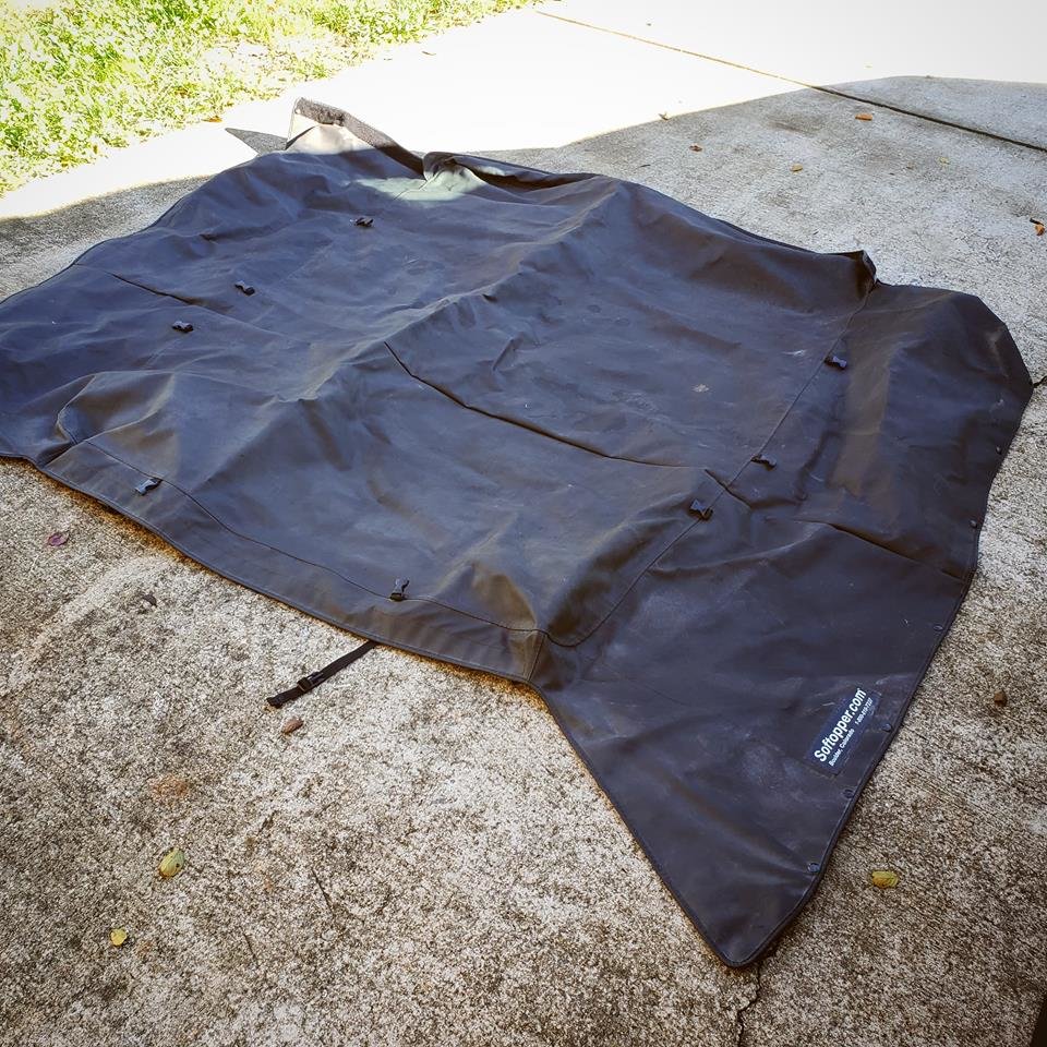

    Sent the softopper out to get shortened 8" at a local upholstery shop due to the bobbed bed. I will also have to shorten the aluminum frame for the canvas top.

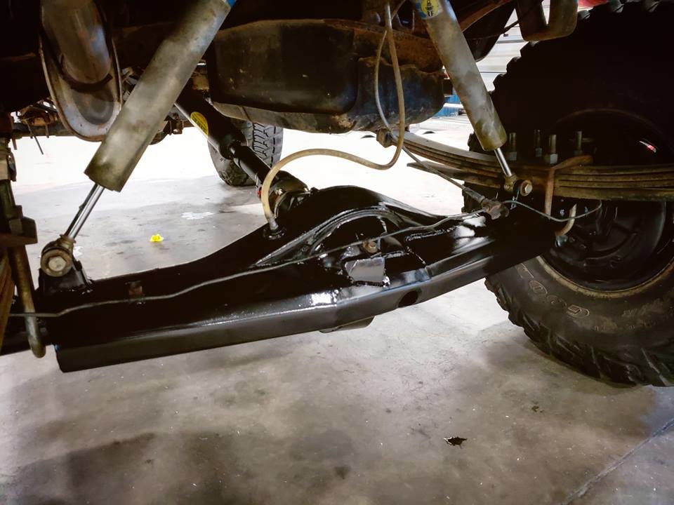

    Ran into some issues this weekend. Drove down to the parts store, hit a bump, and lost all dash and rear lights. Spent the weekend ripping the entire dash out and tracing each wire to figure out where the short was. While testing and blowing more fuses, I ended up losing low beams in the process. FINALLY found the short which was in the pass side fender running light. Thankfully, I also stumbled upon a thread that discussed how the low beam circuit in the column can eventually burn out and lose ground. After dissembling the column and doing some tests, I made a jumper to ground which brought back my low beams... Man, I hate electrical issues.... One positive thing is that the odometer is now working again and I have a much better idea of how the Taco wiring harness is mated and ran (along with everything else). Not only that, but everything is labeled which is awesome, a very professional job and could save me some headache in the future.
    So, that's how I spent my weekend.

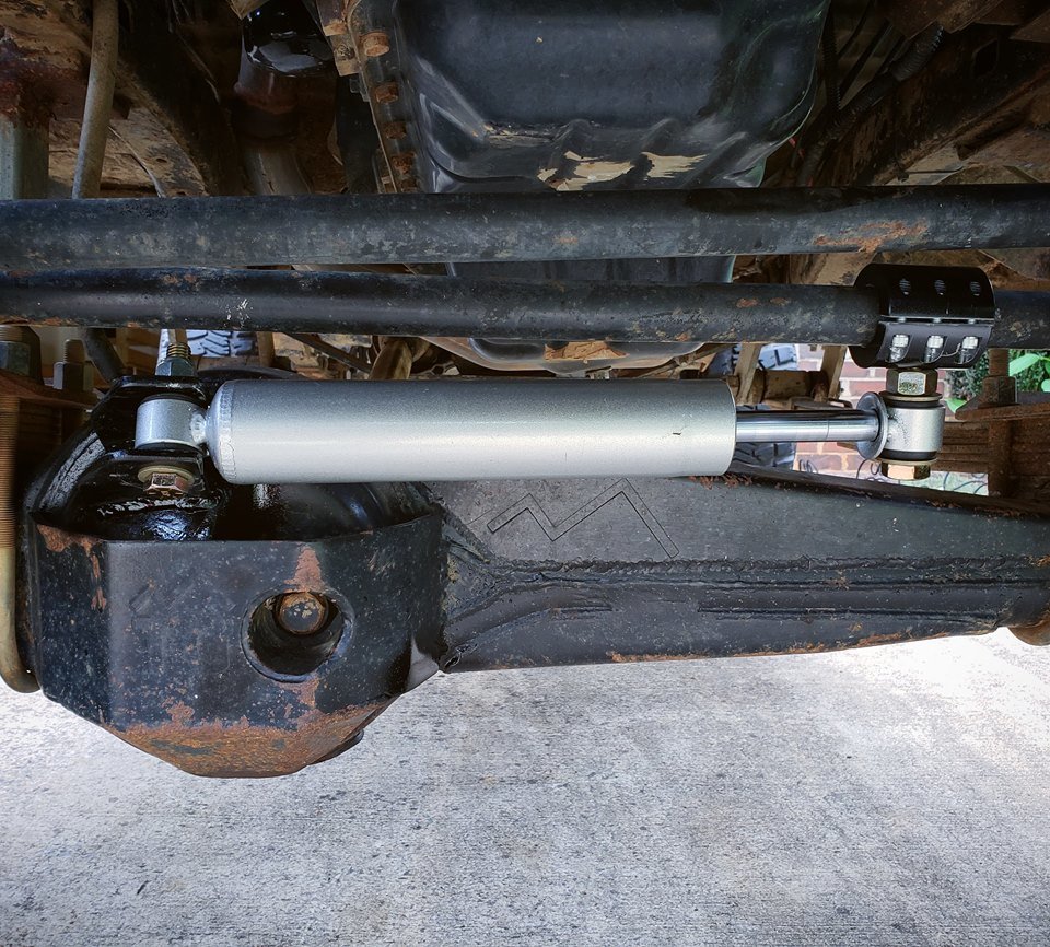

    I did, however, get a chance this week to drill and tap my O.D. clamp to 5/8-11 for the single shear, and fabricate/weld some 1/4" mounts (double shear), and install the dampener. My plan was to build it in a way that would translate over to hydroassist down the road without having to redo the mounts. Also, I decided to mount it underneath the tierod to keep enough room above the axle for the 3 link this winter.

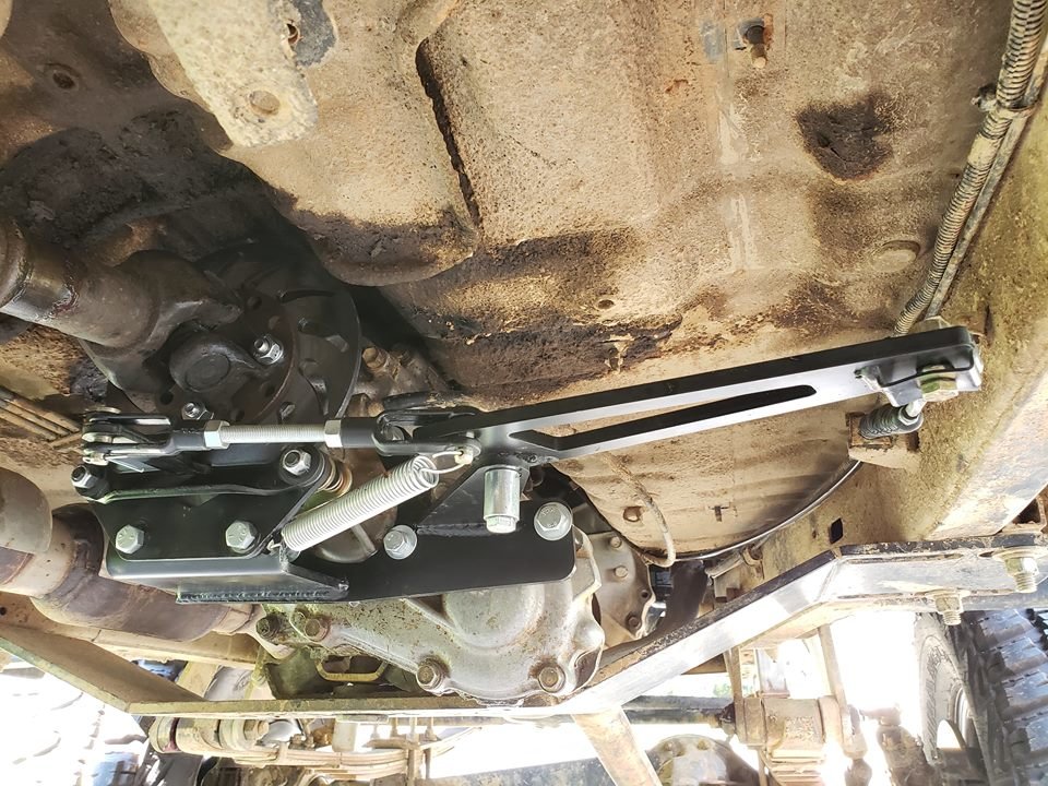

    New U-joints and transfer case mount is in. Had to shim the cross member a bit more due to the tcase brake rubbing on the cab.
    With the stiffer mount the cab vibrates a lot more now, but that was to be expected after reading similar reviews online. Its a bit annoying, but I will get use to it. With that said, I can definitely feel a difference just in response and acceleration. The transfer case is also no longer rubbing into the cross member.
    Other than all of that, nothing has really changed much. Still have my usual vibrations which I thought was bad u joints and still have that horrible grinding noises at higher speeds. Next thing to do is swap out the third and see if any of that is related.

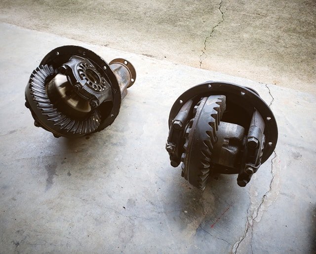

    Swapped out to the open 5.29 third. Problem fixed.
    Everything on the locker third looks fine to my eye, nothing unusual, but definitely made a difference removing it. Also handles so much better without that locker trying to lock up around corners and stop lights. I will be getting a selectable locker for sure down the road.

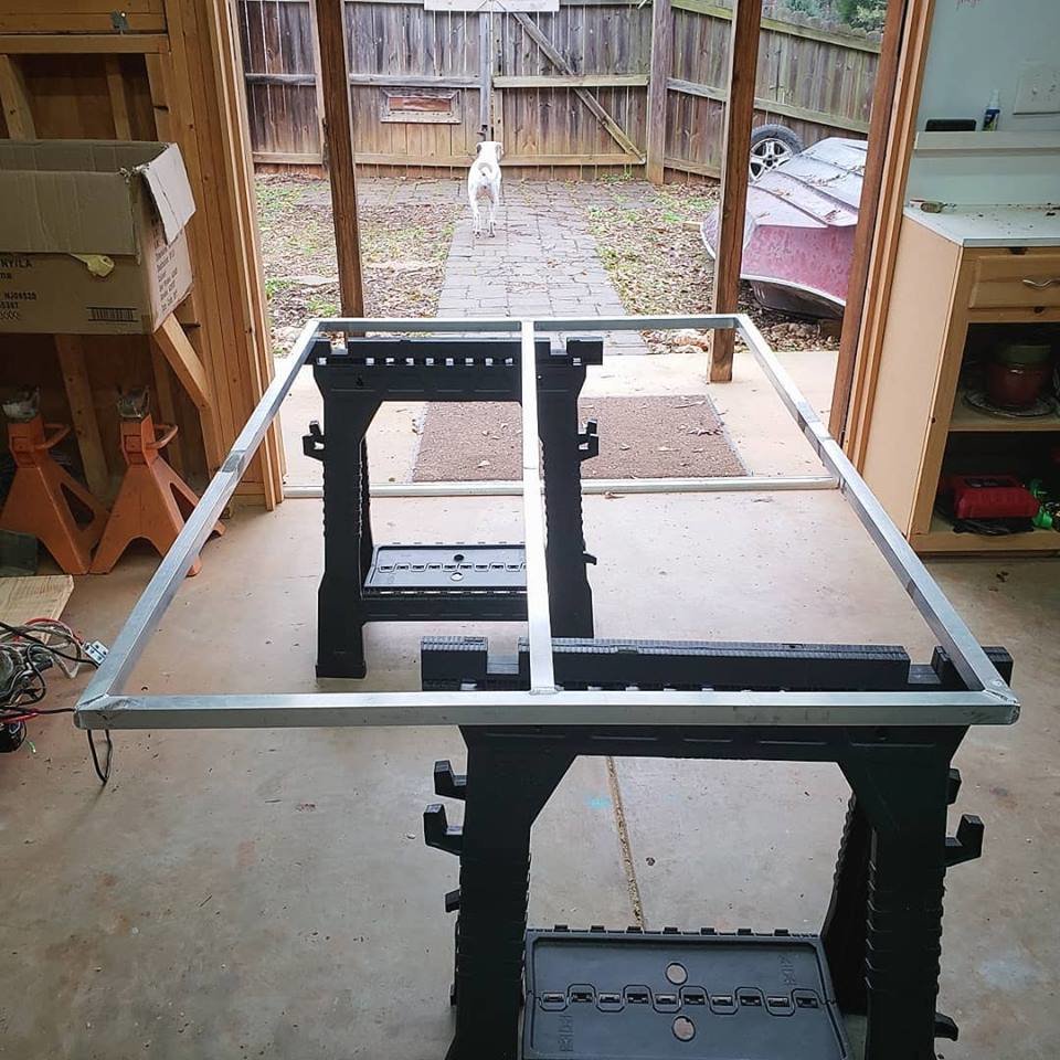

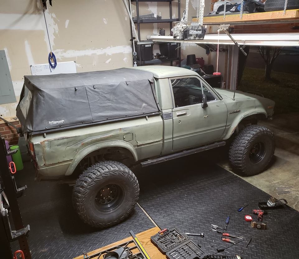

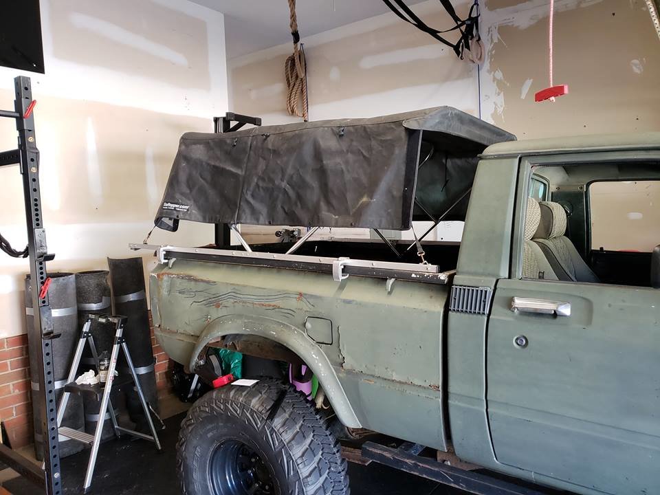

    Also picked up the soft top I had shortened 8". Had to redo the entire frame due to the length change. There was a bit of math involved and was a lot more in depth procedure I had planned on. Thankfully it all turned out perfect and works as it should.

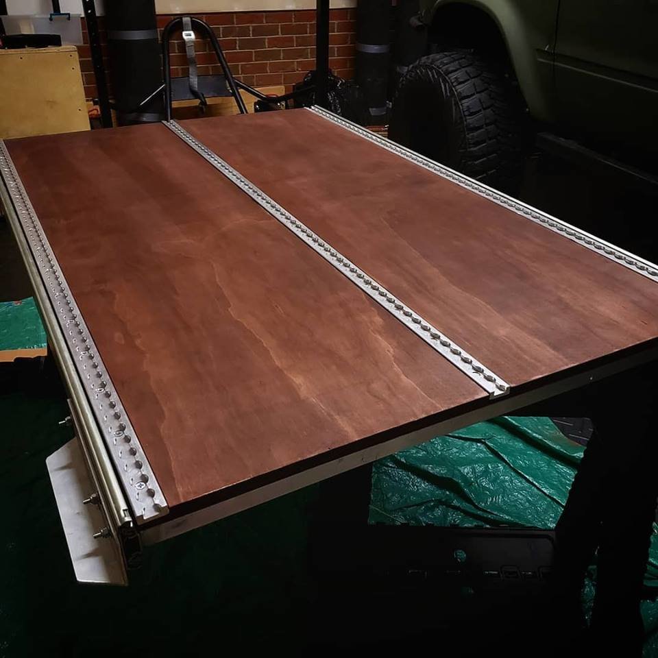

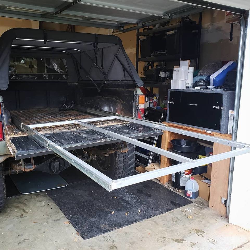

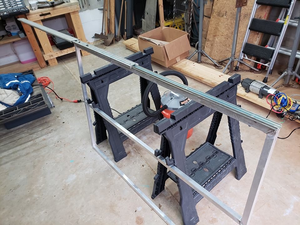

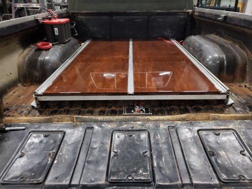

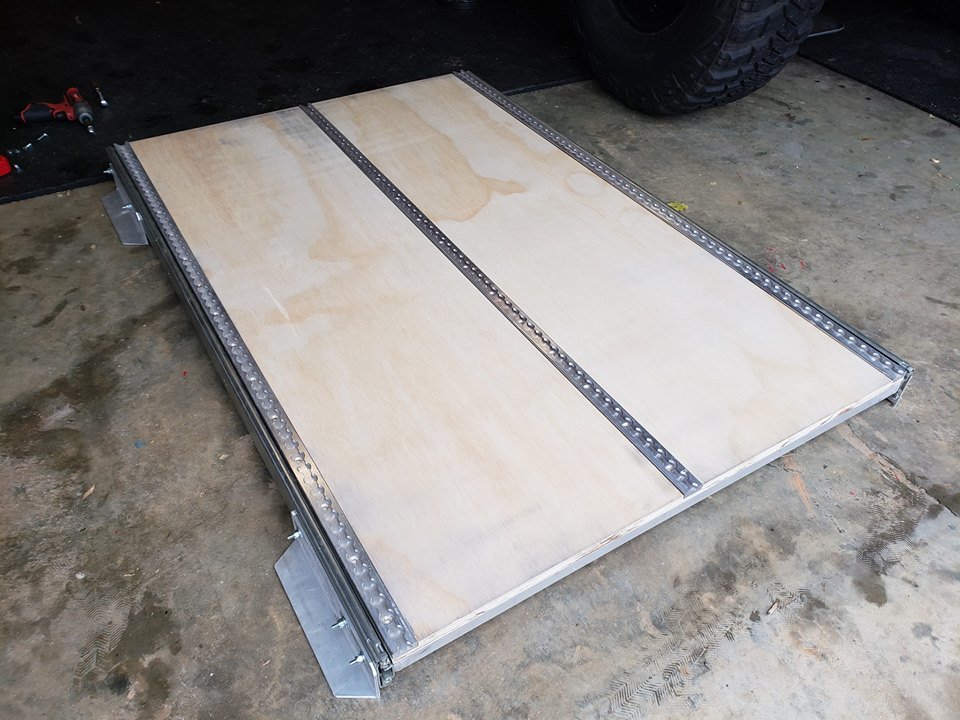

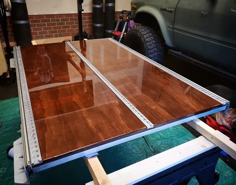

    I started building the 60" slide out bed for the rear. These are two heavy duty slides that have a capacity of 250 lbs at max length. I built a 1" x1" aluminum square frame with 3/4" finished marine grade ply resting on top of it. 3 heavy duty airline tracks at 60" will mount through the wood and into the frame. Honestly, the longest process will probably be the staining and sealing of the wood. But so far so good....
    47095677_10213403027214351_7322993241966_b5784b65a9542cd0d76cfc277606d0b0fcbc7988.jpg
    47041040_10213403027614361_2994129101993_a7b5770c0dc247032ad4712b949440576a182dd6.jpg
    47390802_10213403029094398_1094071742457_f846e621807ac290d24b520b9295a31138be13a0.jpg
    47215315_10213403477185600_3459833445281_22a92dbfc1b1f3c743e28dbeb4d75ca1d73396f9.jpg
    Stained and sealing...
    48360602_10213506526201761_8648941884959_c5057d4c0f8ef07bbd4afc6d992bac4990dc38d3.jpg
    48362648_10213511891055879_3973981347470_9fbab48fd67785cb207de3d566d820498bbad1ce.jpg
    Spintly likes this.

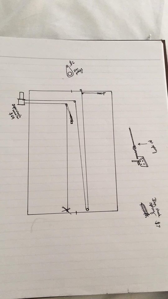

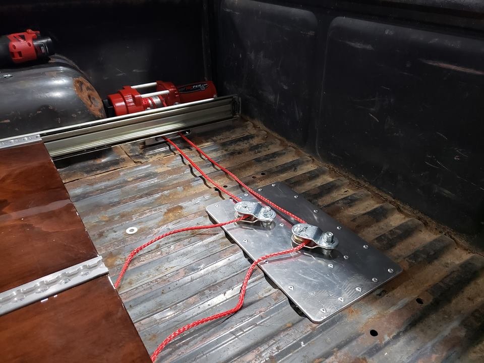

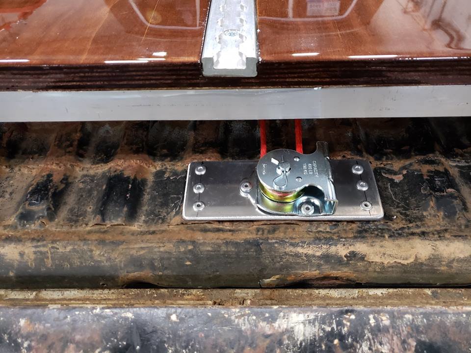

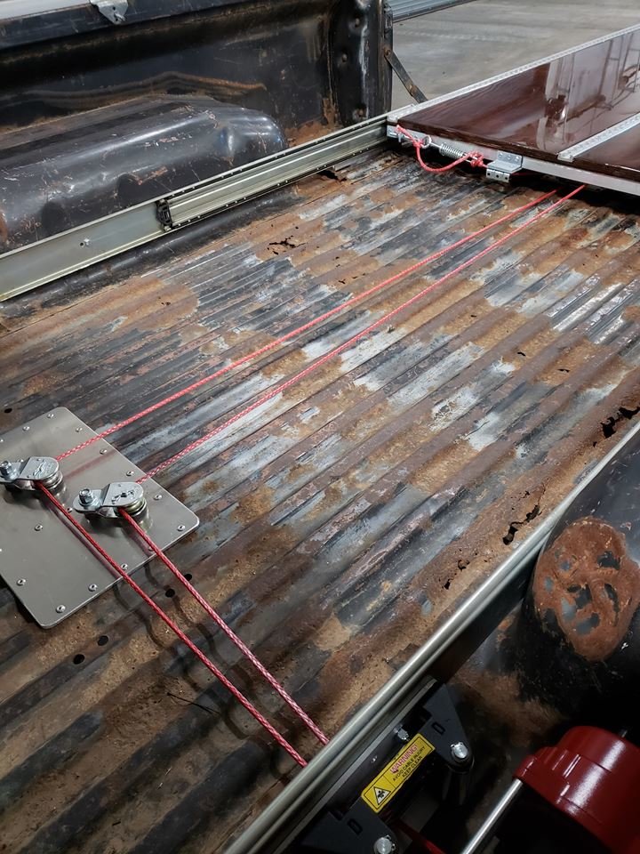

    Started building my idea for the automated rear bed slider.
    Uses a pulley block system and an old small 12v winch with 3/16th synthetic line.
    The idea is, not because I am particularly lazy.. But, to have a slider system that will work on up/down grades with full weight. Even a slight grade in either direction will make a pulling a pushing a 200 lb loaded bed slider much more difficult. Also, it defeats the need to have a locking pin system.
    If the 12v system does fail, the winch can be put into free spool mode and the slider system can go in and out manually.

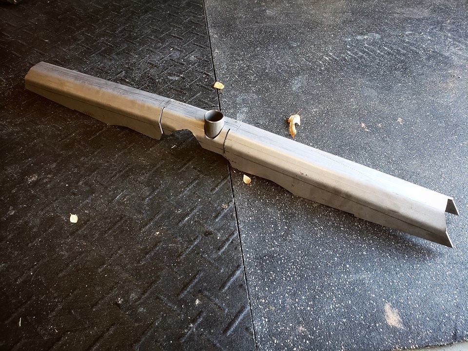

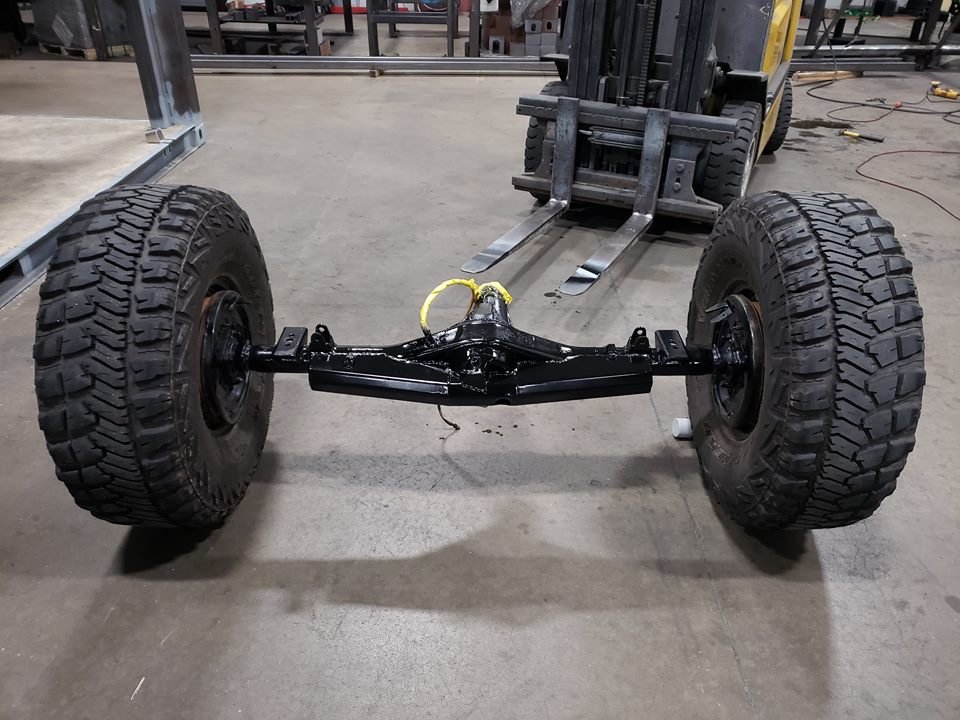

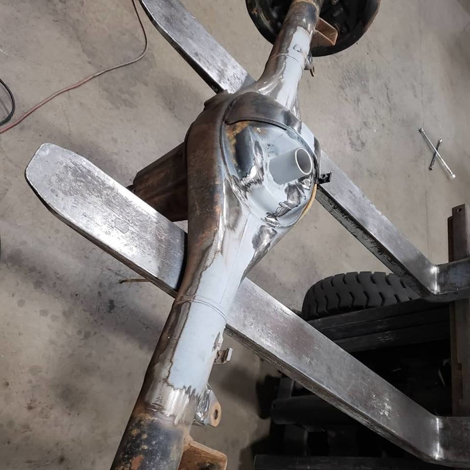

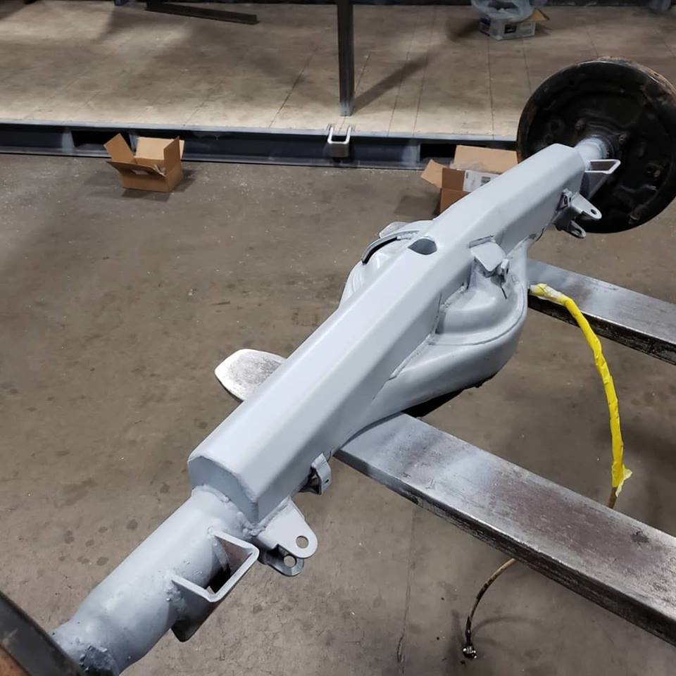

    Removed the rear end and welded up the RuffStuff back truss...

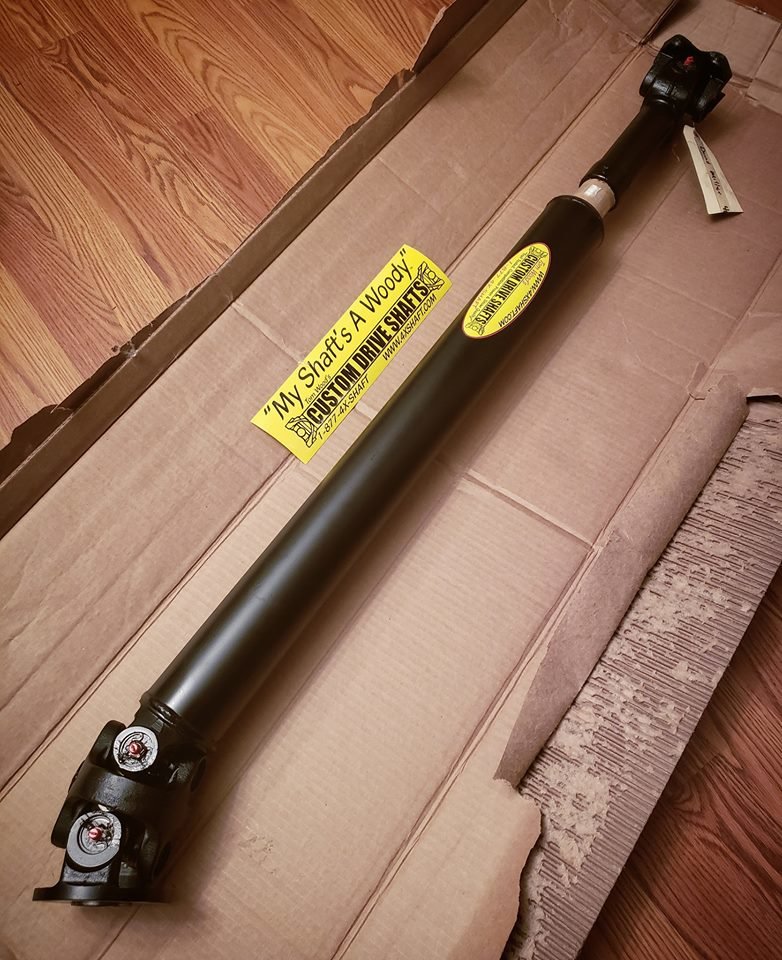

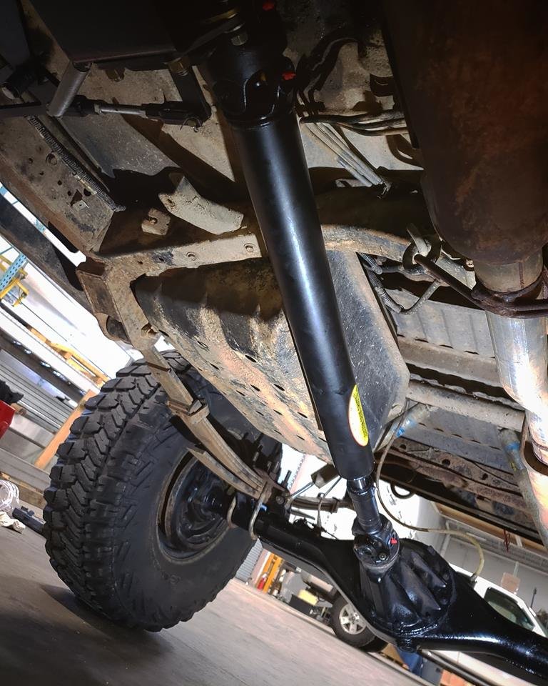

    Also ordered a Tom Woods CV to get rid of these bad vibes.... Worth every penny. Thankfully, the rear perches were welded so that the pinion angle was shooting straight up at the tcase... Not so bueno with a regular joint shaft as you can see... but perfect for throwing in the new CV shaft.
