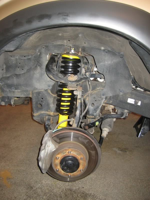

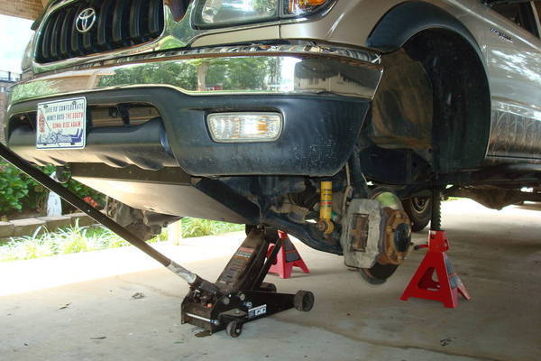

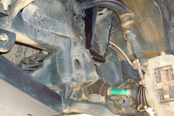

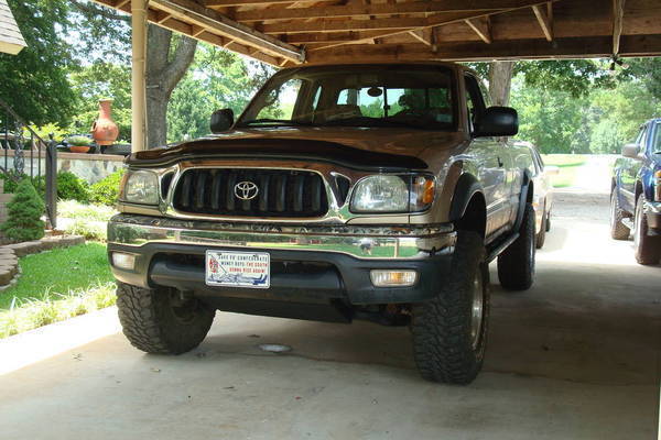

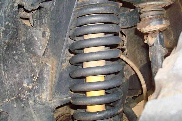

    So, I ordered a set of OME nitrochargers and 881 coils from DSM, they got here today. I went ahead and pulled the old crap out including the spacer lift (JUNK) selling it for $50 :D. Anyway heres a few pics...
    Before w/spacer
    As you can tell the factory coils are SHOT.
    Off the ground
    And drivers side fully removed.
    The new kit should be assembled tomorrow morning.
    Measurements Before OME kit w/3" spacer (from ground to bottom of fender flare)
    Drivers side before w/3" spacer - 36 7/8"
    Passenger side before w/3" spacer - 37 1/4"

    Well got it aligned and got a few measurements
    Drivers side before: 36 7/8"
    Drivers side after: 36 3/8
    Passenger side before: 37 1/4"
    Passenger side after: 37 1/4"
    Not as high as I hoped but oh well, and its probably going to settle more with time :rolleyes:

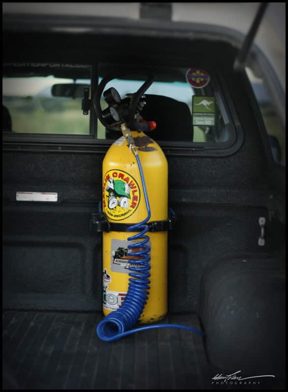

    If you are looking for CO2 tanks, check with local convenience stores. Sometimes they have old beverage tanks that they are cycling through and will sometimes have some they are willing to part with at a good price. Buying a retail tank like a PowerTank can be expensive. But a used beverage tank can be very affordable and while the 10lb size is maybe a little more manageable, I prefer the 20lb tank. It costs me about $17 to have it filled at a local CO2 place, at it will typically last me an entire wheeling season if all I do is refill tires with it. However I use the same tank for my welding projects so depending on the project I might go through 2-3 tanks of CO2 in a season. Still that's not bad. I chose to get an adjustable regulator so that I could change the output pressure in case I wanted to run air tools. I bought a used regulator from the same local CO2 place for ~$40. After purchasing hoses I was into my tank for less than $100. That's much better than a Powertank, and an ARB compressor. The CO2 is SOOO much faster at filling tires than an ARB compressor, and if you even lose a bead on a tire, the ARB may not have enough pressure to reset the bead. Not a problem with the CO2 tank.
    Now if you decided to run a dedicated tank that is hardmounted in the truck and just use a compressor to keep the tank filled, than you have a great setup as well as you don't have the hassle of needing to pay to have the tank refilled, but you lose the portability of a CO2 tank.
    This is my tank in the back of my truck. I purchased the bracket at a local fire extingusher supply store.
