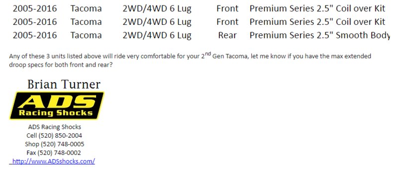

    I guess I am not 100% sure of the question I am asking either, but I would imagine that it would be what the LCA is capable of in terms of travel. Here is where the question is coming from :spy:
