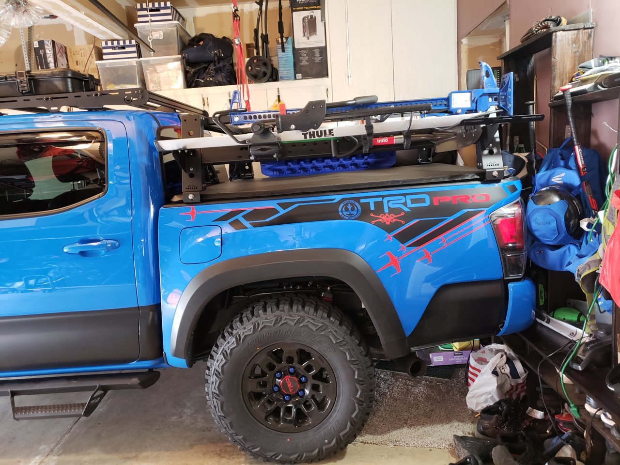

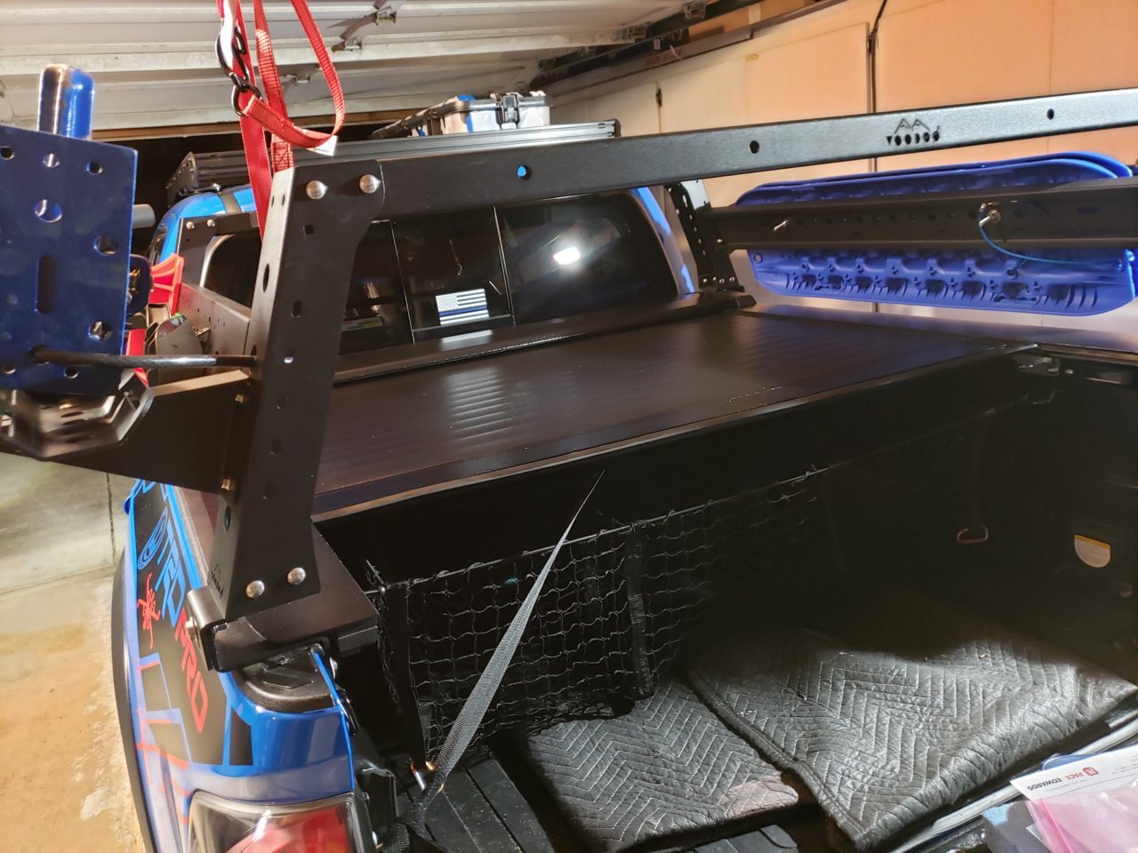

    Any modification needed for the brackets specific to the revolver. Cutting the rail or plastic rail cover. Does the rail leak more water now? I was looking at those voodoos for my truck also and I have the revolver cover.

    So, yes a few things with this install. First the plastic that covers the rails (inside lip) makes the fit under the tonneau rails tight with the voodoo brackets. Since the plastic was pliable I was able to bend them enough to make them work. As for the water tightness, the tonneau was never that water tight, I always had some seepage from rains or car washes; so with the brackets sandwiched between the tonneau rails and bed rails it does lift the tonneau rails about 1/8 in.; so I would assume it would let more water seep in; but I’m more worried about security and being able lock stuff up in the bed which the brackets let me do. I had to make no modifications for the install. After install everything worked as normal. Hope this helps and good luck.

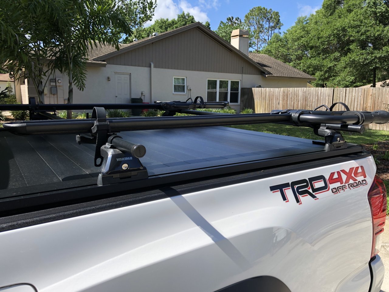

    Any plans for a solution (aluminum) to fit the RetraxPro XR cover? I’m using Yakima towers and round bars, but would like something taller.

    All of our racks fit Retrax covers.
