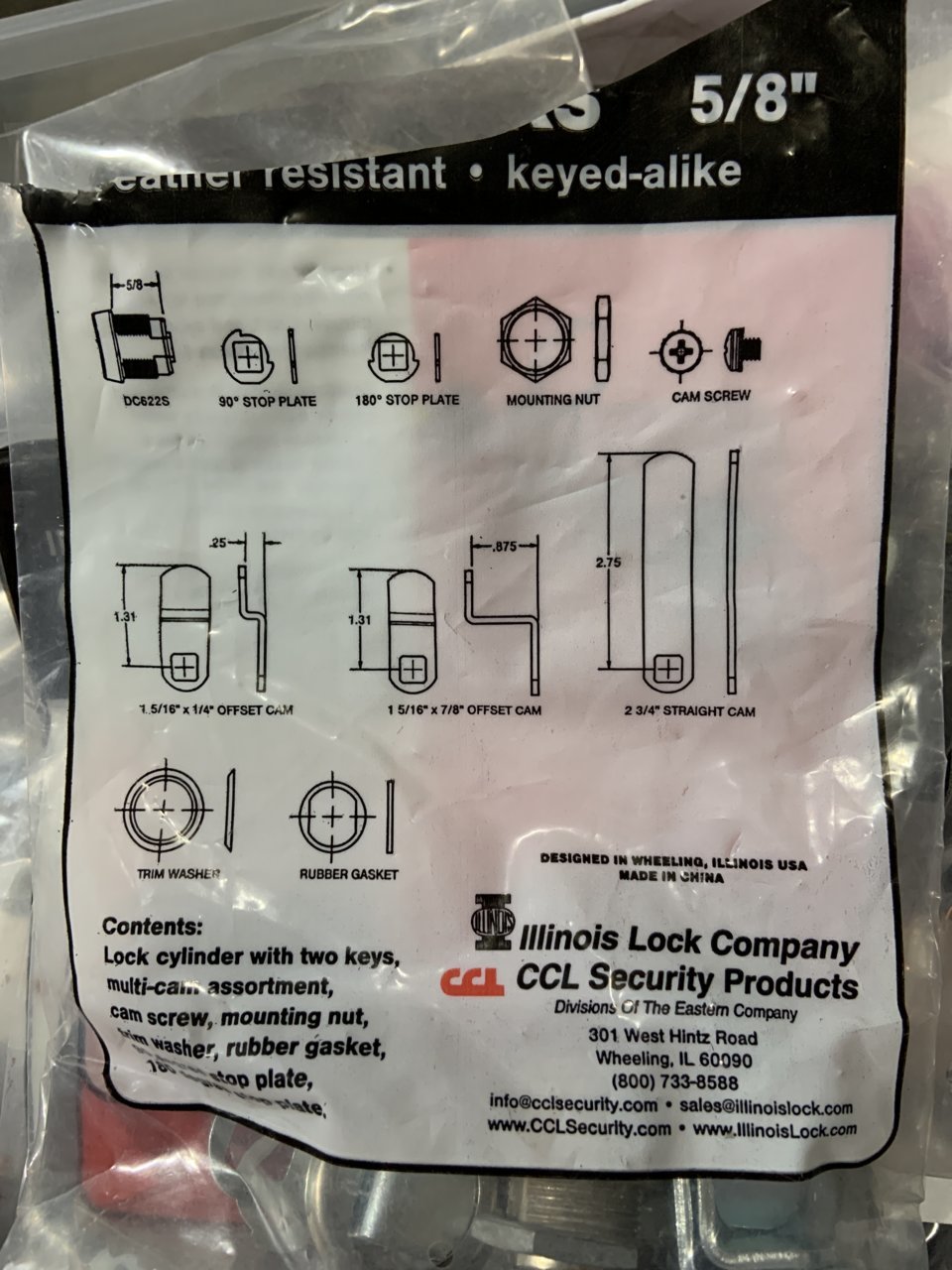

    Did you get any specs for the locks? I’m headed to my garage and will see exactly what I used. It was super simple to modify the arms with basic tools that you might have. Also you might be able to order the correct arm length. I didn’t know how they measured them so I just modified what was sent with the upgraded weather proof locks from CCL
  9. Apr 6, 2021 at 6:49 PM
    #369
    b3itz
    b3itz Camp Life
    Mar 6, 2019
    #285589
    932
    Northern KY
    2016 MT OR DCSB
    Tuned, geared, armored, BP51s...
    Nope. No response.
    How did you hack the arm off? I guess an angle grinder would do?
    I'd love a strut on the box. That thing keeps whacking me in the head lol
  10. Apr 6, 2021 at 8:53 PM
    #370
    BroID
    BroID Well-Known Member
    Nov 7, 2017
    #235337
    722
    The Gem State
    2017 Tacoma TRD off road
    BFG KM2 255/85r16 Bilstein 5100s OME 888, HD Dakar’s, JBA control arms, BAMF Shackle hangers and shackle.
    Gas strut would be awesome. I’ll have to think on that one as far as how I would set it up. Although I migh not consider a gas strut because I kinda like how it slams shut on me when I drive away with it open. Let’s me know that I was an idiot and left it open.

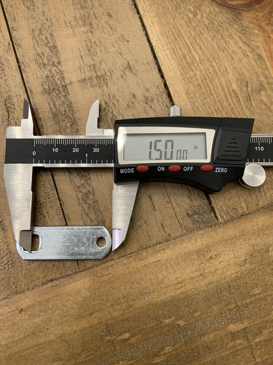

    So the arm that comes with the lock I linked in a previous response is too long. I basically traced the old one on it with a sharpie Cut it to length with a 10” fine hand saw straight across at the longest part of the traced portion and then used a table grinder to round the edges and smooth the cut so it matched what came with the cargo box. Didn’t take long at all. If you don’t have a table grinder then a metal file and a bench vise could get the job done.
    I used the 5/8 cam lock
    the reason I wanted the specs from KBVOODOO was to figure out how the company he used measured the cam or as I have been calling the arm that locks it. Here is a photo from the back of the packaging. Might help ya figure out what size of cam to order from CCL if your not wanting to cut, grind and smooth.

    Quoting my own post but the part number for the locks are 62207
    CCL 5/8 cam lock

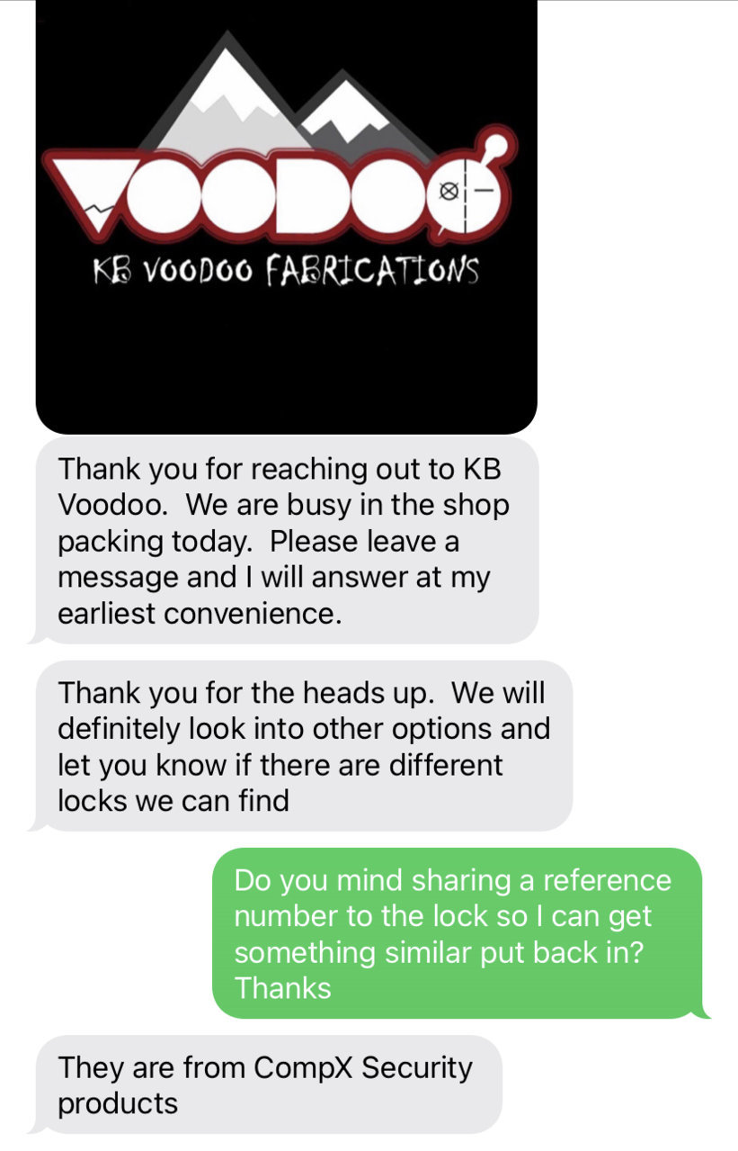

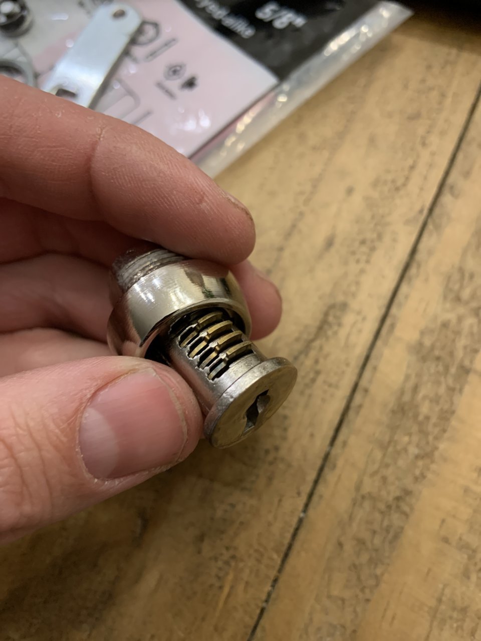

    LOL. Like I said. I figured it out without any very non special proprietary specs. Haha. I’m wondering if all your doing is not admitting to using a cheap lock that is used for indoor file cabinets. Below are pics of one of the locks that had less than 1 month of use before it failed. Also some of the measurements so that they can be easily replaced without any very non proprietary specs. What is used is a comp x lock. It says it right on the key.
