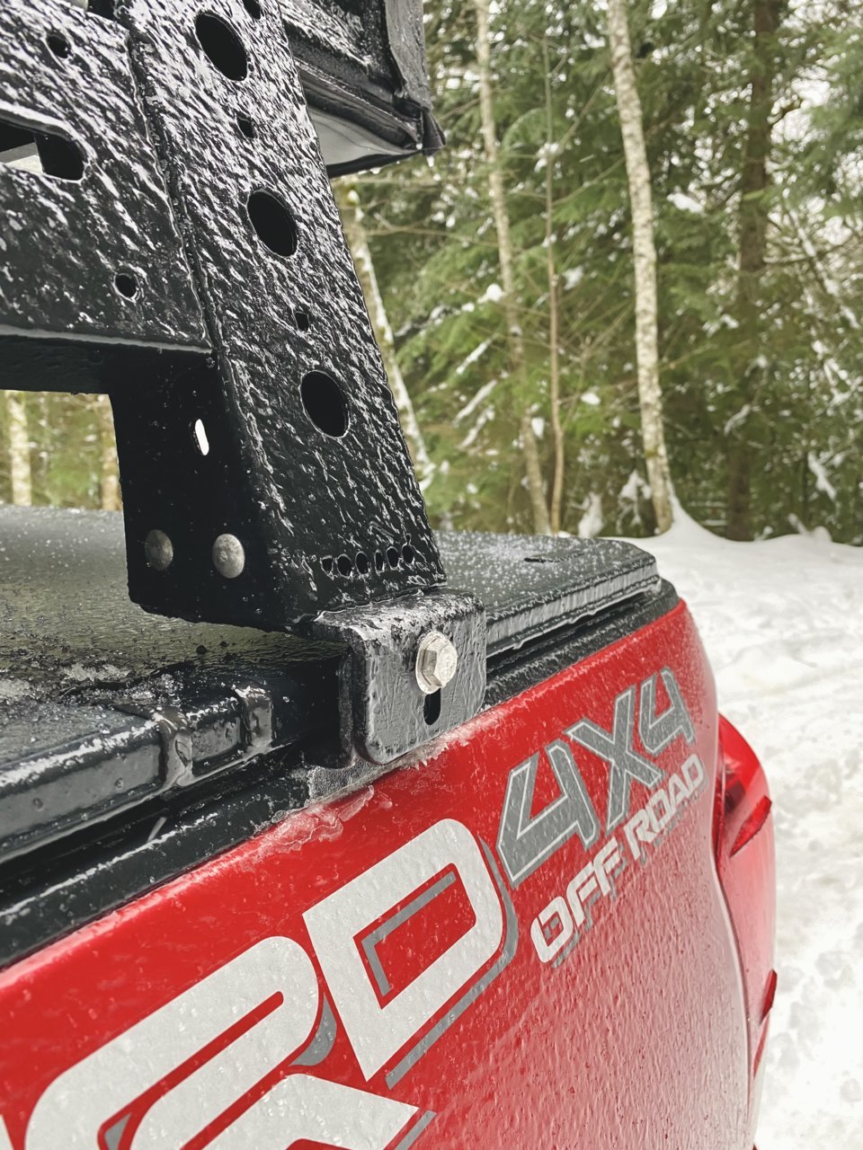

    Looks good, but you need to adjust your installation.
    The should be adjusted so that it is more narrow, it isn't supposed to overhang the side the bed like that.
    The bottom of the legs should look like this:

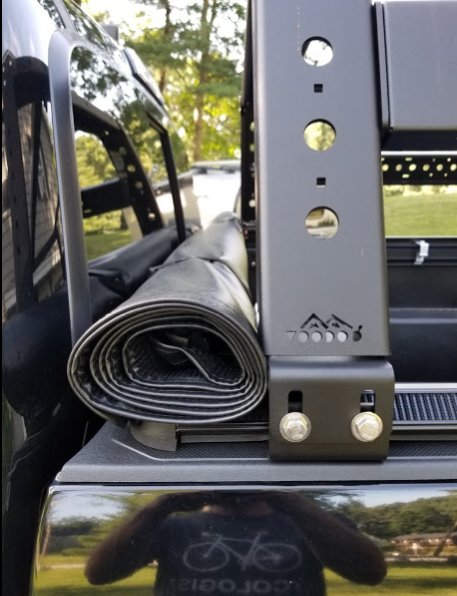

    Just put an 18" Taco Max on my DC6'. Looks great, I am able to roll up the Truxport tonneau all the way, takes about 2 minutes.

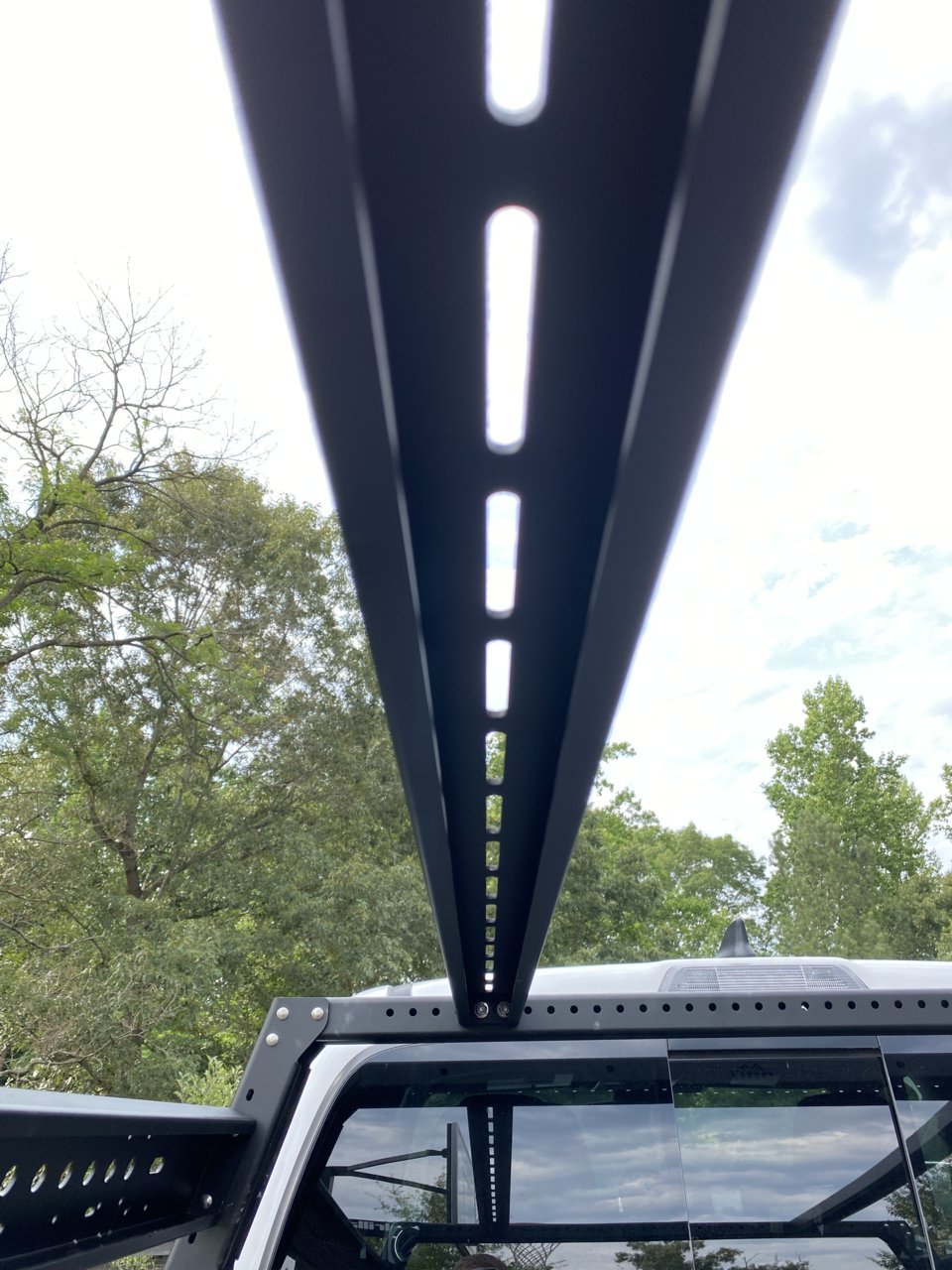

    1. There is a lot of flexibility in where the top bars go. In addition to holes every 2" or so, the top bars themselves can slide left/right a bit (see photo) before you bolt them down tight. The rails of my RTT are exactly 32" apart, this allows me to get this just right and bolt the RTT directly to the top bars

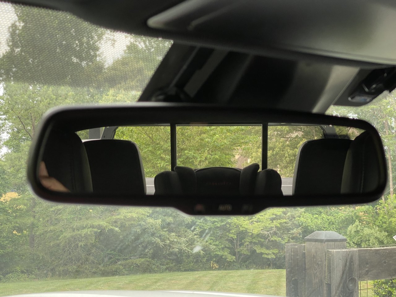

    2. I really like the height of the 14" rack with the tonneau adapters. Just tall enough that it does not in any way obscure my vision during normal driving, but also sits a touch below the roofline (see photo from driver's seat).

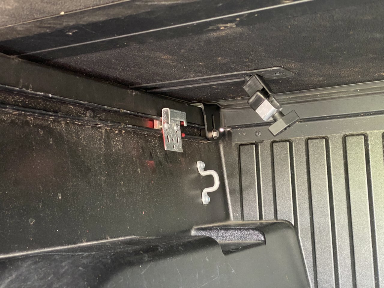

    3. I have the Solid Fold cover that came with the truck, it it JUST slim enough that the tonneau adapters do quite not sit on it (all the weight is on the bolt), so I put some rubber gasket material in between the tonneau cover and the adapters to take some of the weight off the bolt. I'm sure this was totally unnecessary but the engineer (chemical) in me had to do it. The mechanical engineers will probably tell me I am an idiot.
    4. Because of the way the truck bed is shaped on the inside, the rear attachment pieces of the rack (which bolt to the truck bed itself) end up kicking out the side walls of the bed ever so slightly. At least on my truck. You can see it when you tighten the bolts down. I am going to drop a washer between the tonneau adapters and the rear attachment pieces to bring them in just a little.

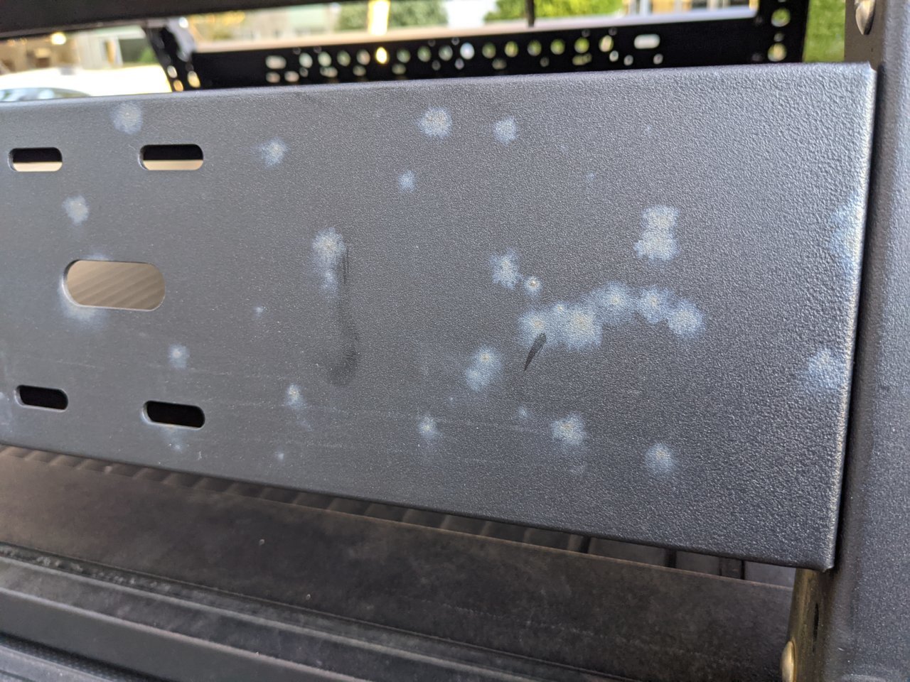

    I gotta share my story with this product.. I am really disappointed with it, and with the company. They've completely ignored my inquiry regarding the obvious low-quality of this product..
    1. Ordered in July2021
    2. Installed in ~August
    3. We get a bit of snow in Jan but really not that much
    Here's the rack as of now:
    I contacted Max Modular on Jan 9 and got this response:
    "Salty winter roads will cause that on anything made from steel. We make aluminum racks for exactly that reason."
    Since then, no response at all. They've ignored my emails.
    I've spoken to several body shops in the area and they have told me this is an issue with low-quality powdercoating - the bare metal isn't sandblasted but coated with something that clearly wears off because this piece is rusting from the inside!
    I'm clearly not the only one having QA issues with this company: https://www.tacomaworld.com/threads/our-latest-project-max-modular-bed-racks.561985/page-5
    Anyways, buyer beware.
