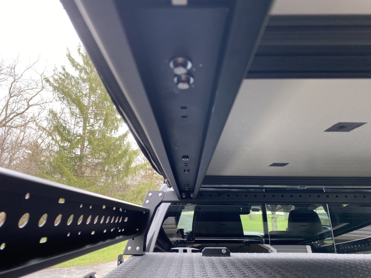

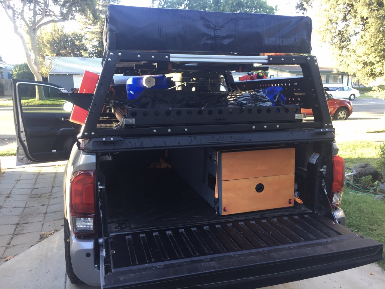

    Does anyone know if the mounting brackets that come with the yakima Skyrise rtt will attach to the top bars or are the top bars too big?

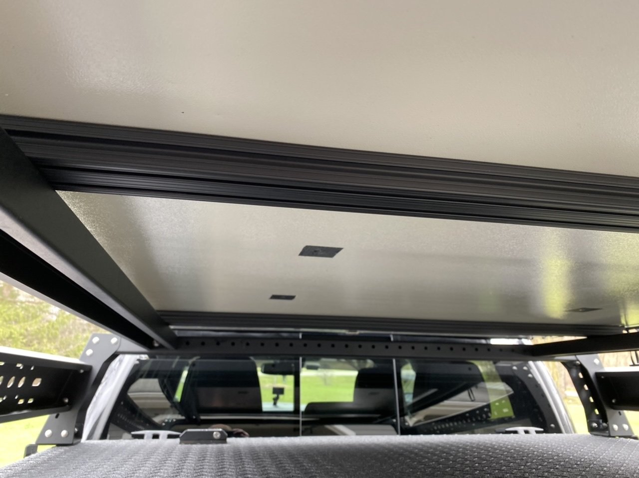

    I had a Yakima Skyrise M and the claws are not great for larger square load bars as they are designed for oval load bars. So on my @KB Voodoo 18” AluMax rack I added two 1” square tubes that I bolted together in pairs to the underneath side of the load bars. They were small enough for the claws to hold tightly. Worked great till I bought my iKamper.
    Here’s a couple photos showing how I chose to solve the issue, and clearances.
    ACAC674B-37DB-4947-9361-E347EBEBCDA1.jpg 0BC551A8-BB0F-46F2-8986-D2755CF50A1A.jpg C062CD51-7659-4E31-8450-FC4106D2DF64.jpg 2D20A0F3-9368-4D12-B18D-992E843D0E7C.jpg

    I have the Medium HD and had to use some 80/20 rails to mount. I discarded the Yakima mounts.

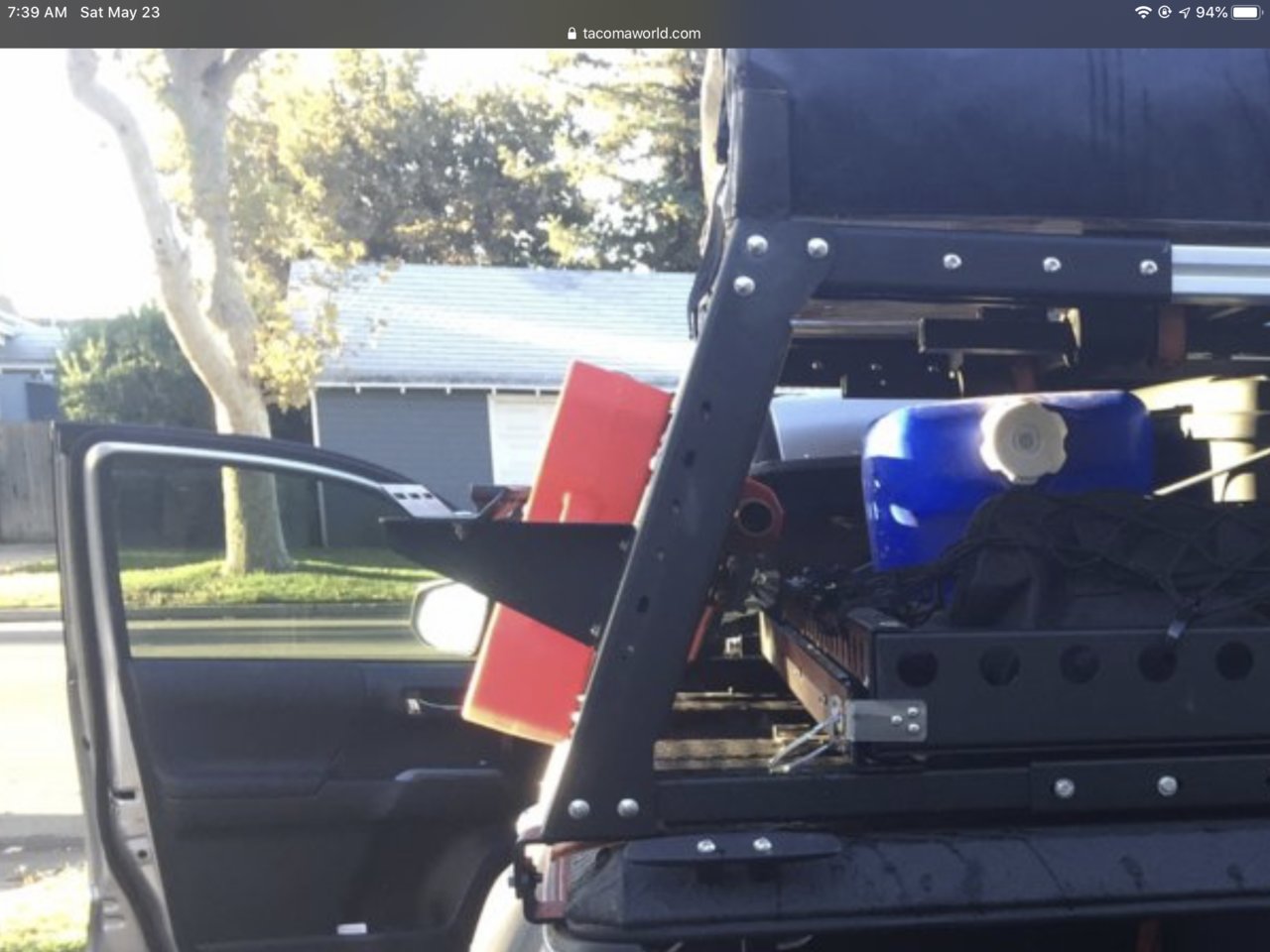

    Not sure the angle, but here’s a close upC6C4861A-84DF-4181-AA42-93C15422491A.jpg

  11. May 23, 2020 at 9:31 AM
    #271
    RusD
    RusD Member
    Jan 23, 2018
    #242167
    18
    2017 QS DCSB OR Tacoma
    Thanks! That looks pretty darn close to the same angle as mine. Just don't want bikes leaning away from the truck. How do you like the mount on the side? Plenty stable? It sure looks cool and has got to be easier than lifting to cab height.

    Thanks for your reply. So you used the 80/20 and then did you just bolt directly into the threads for the original mounts?

    Correct. I used M6 80/20 T-nuts.

    Awesome. You happen to have a picture?

    29DEE1C2-990E-44C8-BAA3-0DCDFF0071AA.jpg 59917C2A-0C62-4FF7-97B1-887BB78453FE.jpg 1F60FDE8-A02F-4143-858B-65C02B25C90C.jpg 4B9C1FAA-E209-4A37-8E62-C00491FF8264.jpg

    What a hassle but awesome solution. I think that’s what I’ll do. Thanks for the pictures
