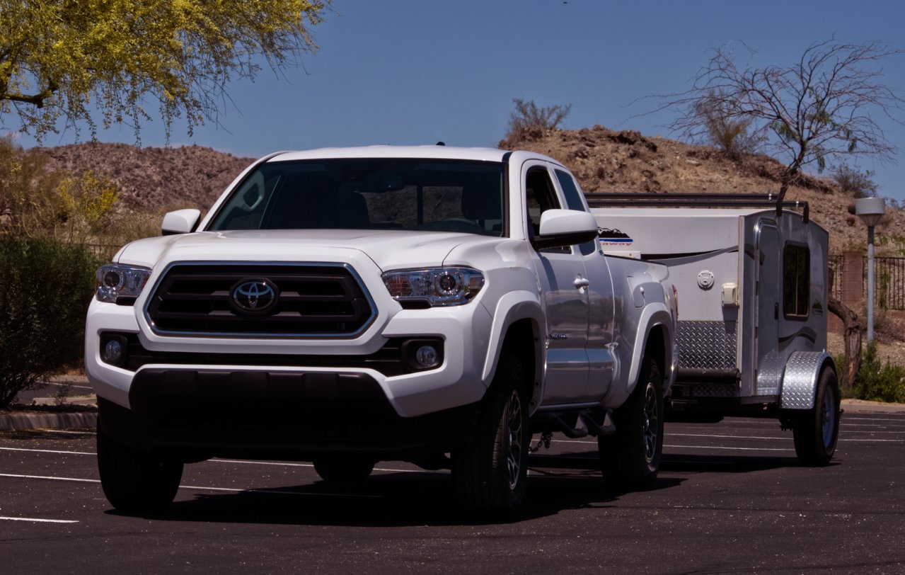

    This has probably been addressed elsewhere but I'm sure others may want
    to know this as well. Is there a limit on how fast one can be driving in standard
    DRIVE before switching to S Mode.
    And to further complicate the question if running in standard DRIVE with ECT is
    there a max speed before switching to S Mode.
    Reason I'm asking is while towing a 1,000 pound teardrop on the flats I see no
    reason to run in anything other than ECT until I hit some steep up or down grades,
    at which time I'd like to go S4 ~ S5 but wondered if I was doing 55-65 mph would
    switching to S Mode at that speeds be detrimental.
