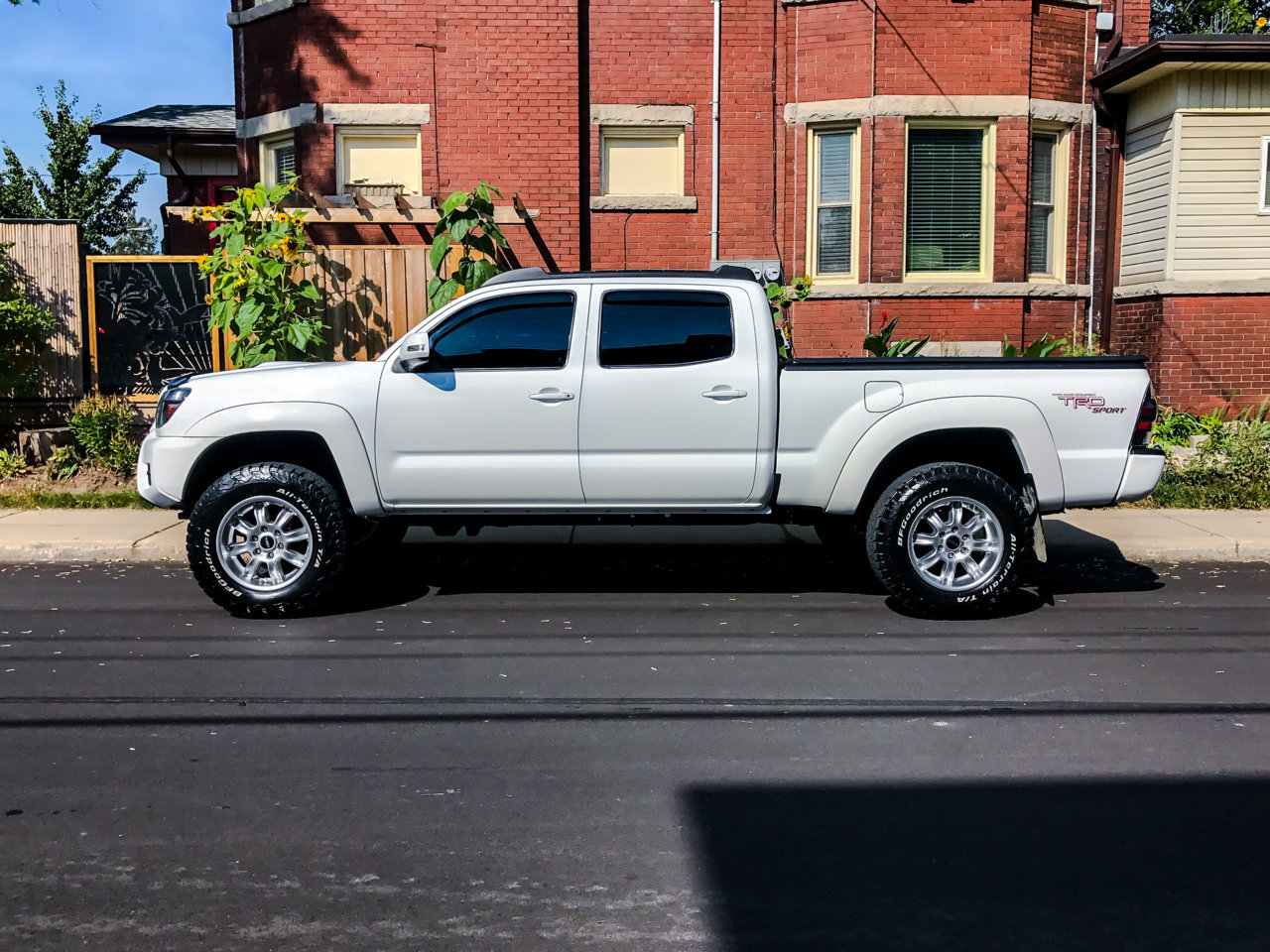

    ‘13 SUPERCHARGED DCLB TRD SPORT
    I did 275-70-18 on a 2.5” lift.

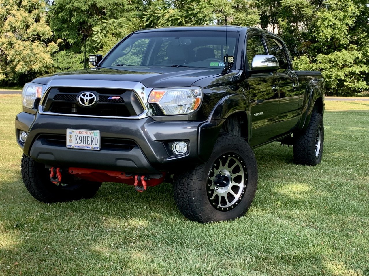

    I have a 2.5” lift and went with 32” tires with a wheel that has a -12 offset (if I remember correctly) only had to remove the mud flaps up front and I’ve had no issues. Perfect for daily driving and works great for most basic to medium off roading thus far…
    Side view:
