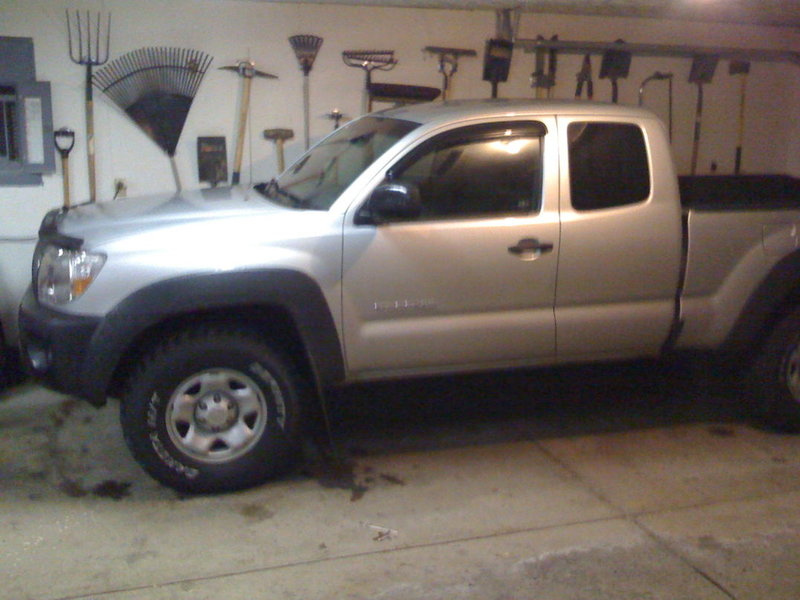

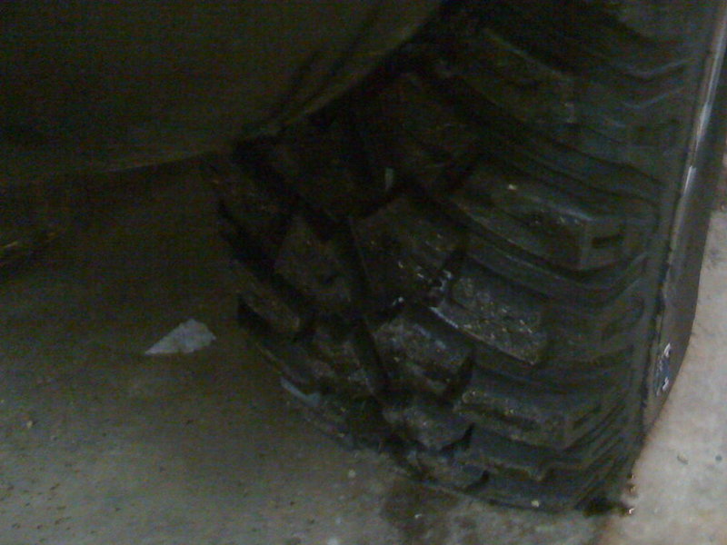

    No lift and no rubbing with the 30 x 9.5's. To keep the tires from rubbing, you have to remove the small black box from the front wheel wells.
    Guys that have the Readylift kit for the 5 lug can run 31 x 10.5.
    Check out this link for some posts about it over on Toyota Nation. Check out pages 2 and 3.
    http://www.toyotanation.com/forum/showthread.php?t=183794&page=2
