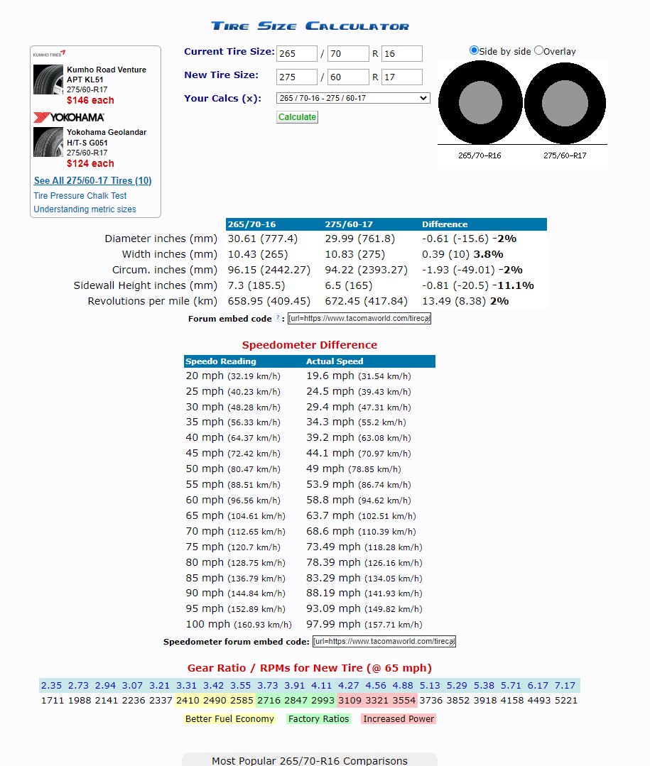

    If you have a TRD Offroad, the stock tires are 265/70/16; going up to 275/60/17 will fit just fine:
    DJ's Taco and ScottyStone like this.
