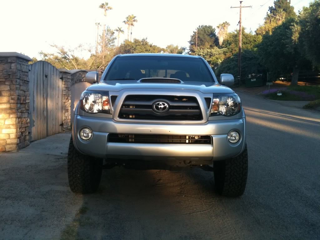

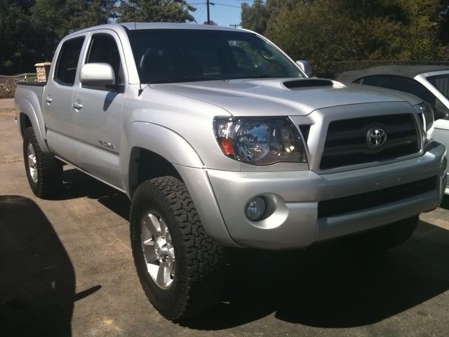

    It looks like this however I would recommend an alignment right after the lift: IMG_0215_30a555fd29ef286278ae33ef1fdc2f4da10c5f97.jpg

    Sorry I'll try to take some better photos the lighting is bad!

    KRich
    KRich [OP] Well-Known Member
    Dec 11, 2008
    #11490
    121
    BC, Canada
    07 Black DCSB TRD Sport 4x4
    Truck looks sweet! Definitely going to go with the BFG A/Ts myself. Really debating whether it is worth going to the 285s and having to use spacers and trimming or if I could get away with the 275s without any spacers or trimming and if it would be very noticeable difference. What kind of spacers did you get and how much are they if you don't mind me asking. Probably a good idea so you can have some more space between the tires and the stock UCAs. I was a little pissed this winter when I realized I couldn't fit chains on my front tires. Do you have any pics of the side view? Cheers!
