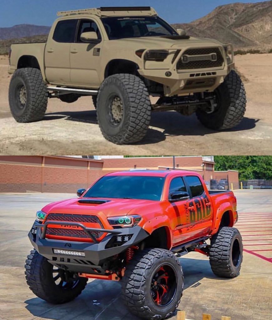

    IMO run some 16x8 wheels 0 off set on some 265/75/16 will look good. No rub etc. unless you want to cmc etc. with 285’s

    :rofl::rofl::rofl::rofl::rofl: Ridiculous
