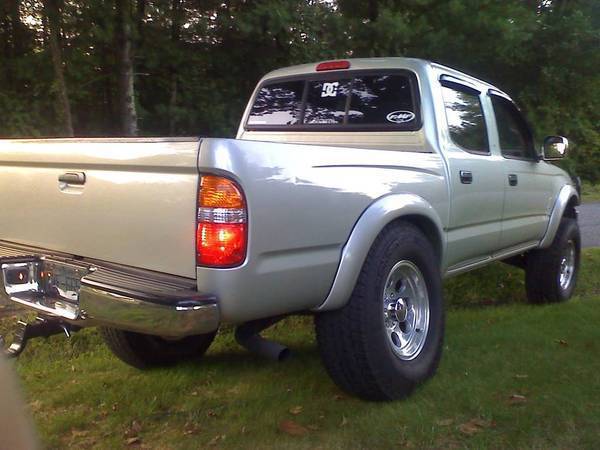

    it may work for you....yeah my wheels have a 4" BS....theres a guy in here running 285s on a stock 2nd gen i think but not sure...good luck man
    heres a pic with all the flex she has in the rear...if you plan on wheeling it keep a spare set of 265s around...
    BTW 305s are 34.01" seriously doubt those will go with 2" try 285s if anything....http://www.tacomaworld.com/forum/tirecalc.php
