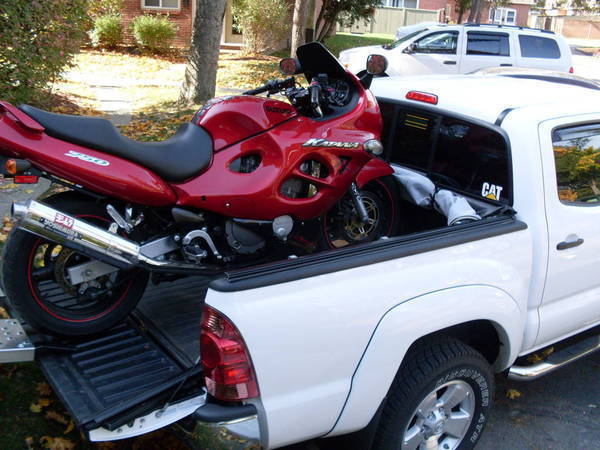

    This is how my Katana travels. So far I've driven several thousand miles like this (300 mile trips at a time, not all in one shot) no bent tailgate. The Katana is a 750 and weighs in around 450 +/-. Your 650 should be fine, if you're still concerned you could cut a piece of plywood that lays from the front of the bed onto the tailgate. This will help spread the weight across the tailgate more evenly.

    Thanks! That Katana is fairly long, especially for a sport bike, so yours might not sit back that far. I'd just put a piece of plywood so it fits tight against the front of the bed and you could even screw a couple 2x4's at the front to act as a wheel chock so the front tire can't turn. A piece of advice, make sure the plywood is secured somehow to the truck when you unload, otherwise the bike is rolling backwards down the ramp, you hit the front brake and the whole platform starts sliding out (unless you have a rubber mat). Not a fun situation.

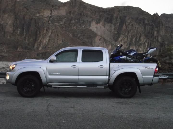

    i drove from hinesville georgia to las vegas to northern california like this....and had no problems with a bent tail gate or anything
    168640_182997508398339_100000642728719_4_d6f2ae633a1df13205796ee4a29c1e4da897bdab.jpg

    It's a hell of a lot easier to load it straight on than try to turn it once it's in the bed...
    Plywood works just fine. Plywood on it's own is flexible (although 3/4" is pretty rigid) but it's added support. In order for the plywood to bend, the tailgate would have to give underneath it. The plywood helps spread the weight so it's not a point load on the tailgate (for a bike this size, you don't really need anything, it's just added security). Angle iron is overkill for a 650 cc dualsport.
