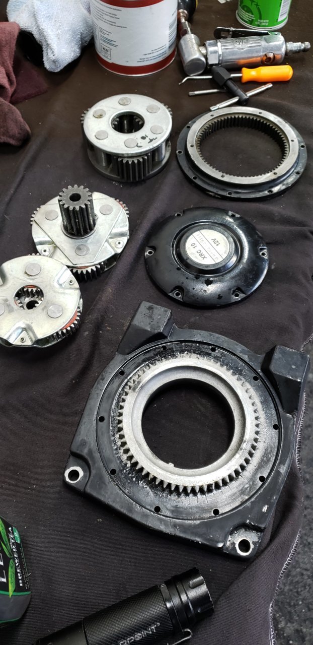

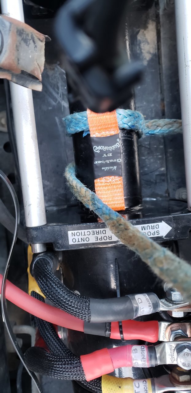

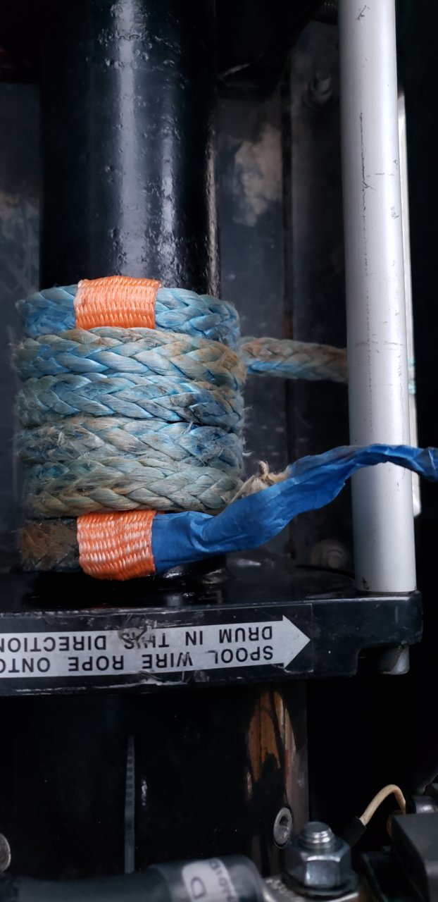

    I recently entirely rebuilt my winch and added this winch line keeper made by BubbaRope during the project, I think its a must have accessory..
    When I say rebuilt, I mean rebuilt from a complete tear down and rewired with good quality 2gauge wire..
    And since it was all apart, I added a Harbor Frieght Badlands Winch Wireless Controller into the mix..and it works bitchen!!!
