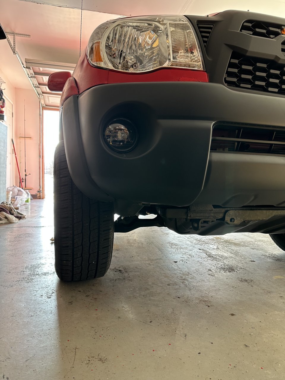

    I have a Tacoma 2008,I replaced Moog lower control arm,and Bilstein 5100.
    So camber setting maximum,but it’s still positive camber,top wheels go out.
    Anyone has any idea how to solve it?
    Thank you!

    Very typical for lifted trucks, you'll need after market upper control arms that add caster and remove camber.
    SPC adjustable, Camburg, total chaos all make them.
    Typically with 5100 lifts, even at max I can get then in spec, which is still positive, but at the very top of positive.

    What setting do you have your 5100s on and what springs are you using?

    I probably it’s 1’ on 5100s and OEM spring.
    I’m feeling good,but positive camber makes steering wheel wobble and pull to one side.
    Worry on the way!
