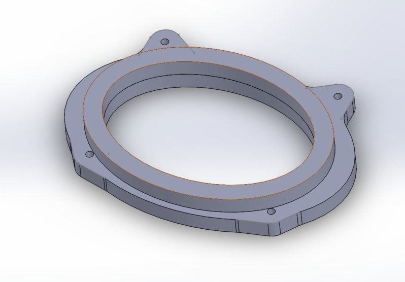

    74
    Eric
    This mount needs modifications made to it so it wont contact the door card! I throw up a screen shot of my new model when it is done. Contact me if you want the .dxf and you can throw them into a cnc router.

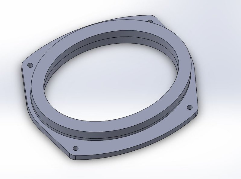

    This will work much better. I am developing some stress marks in my door card around the speaker area need to take them off and see what is going on with that. My speakers have a top mount depth of 3.5"
