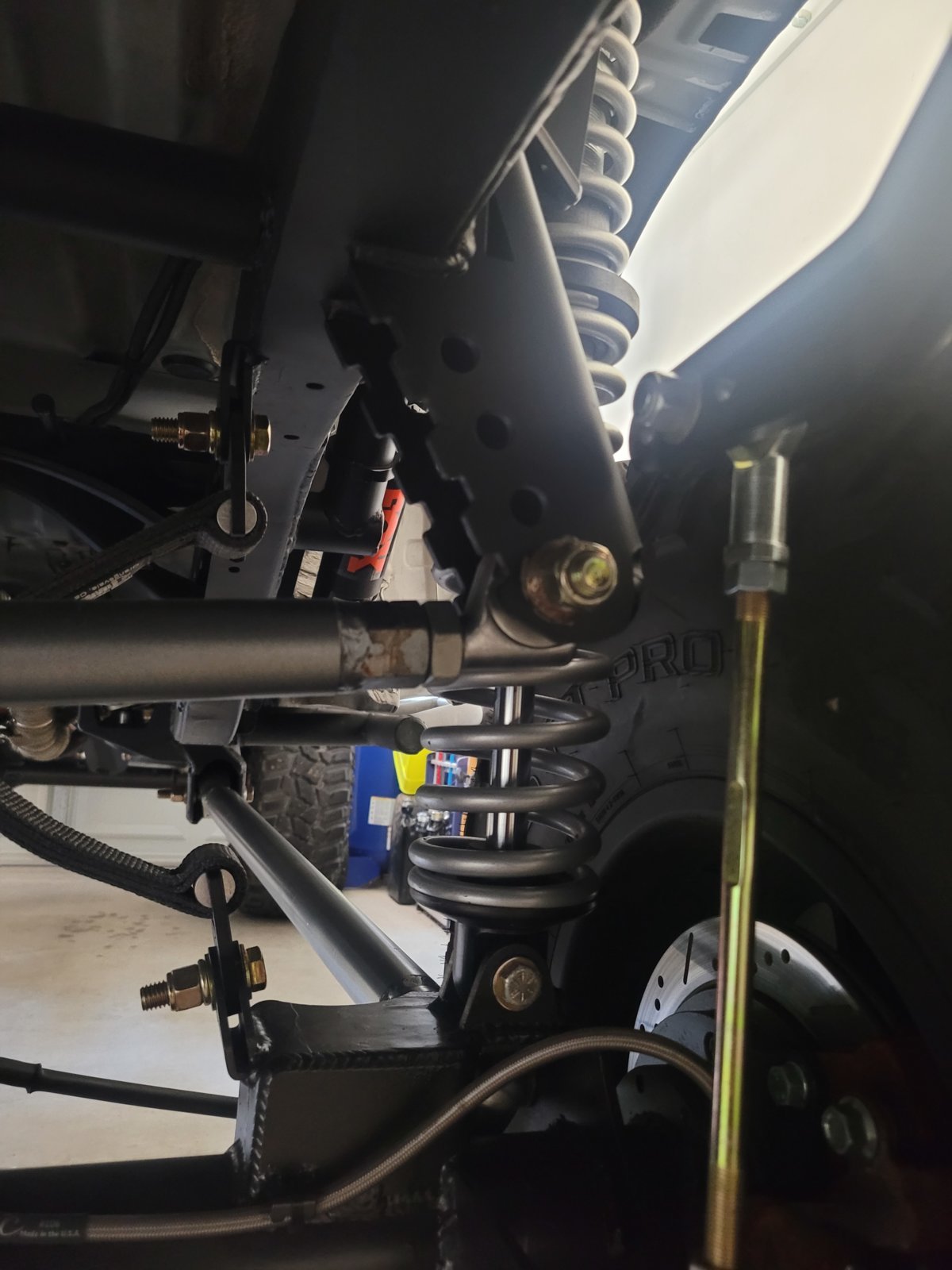

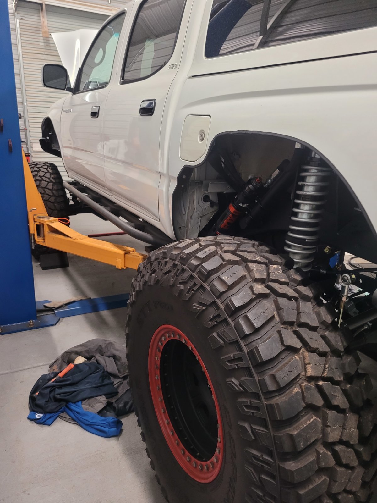

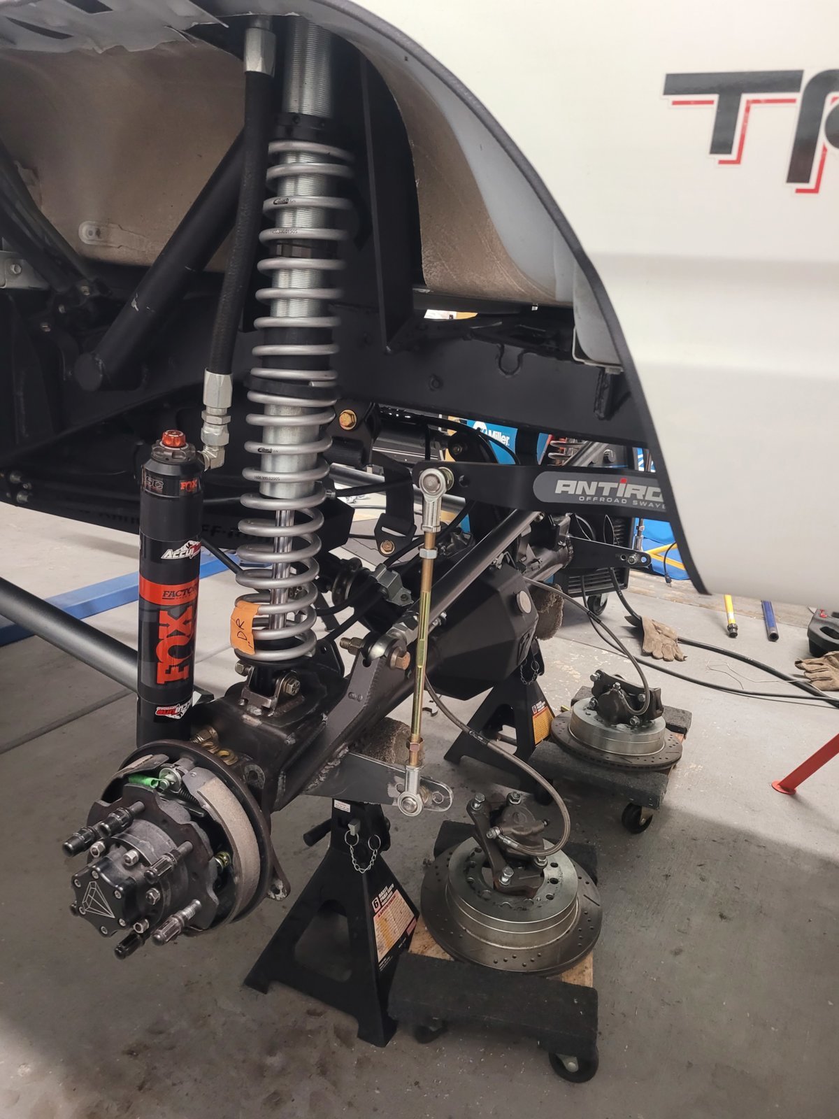

    Pictures?

    Mine's 100% completely different from how you would imagine yours being like

    lol now I want to see anyways

    It's less Tacoma and more mod
    Them leaf spring boys don't know how to read anyhow :p

    that’s awesome. Yeah basically exactly what I’m planning ;)

    But might not work the same. I'm 70" wms compared to 60" factory
