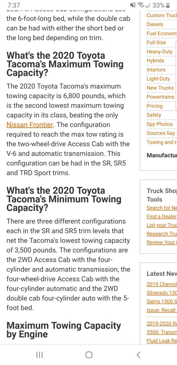

    Anyone know what is the best combination for maximum towing capacity for a V6 4x4?
  2. Feb 7, 2020 at 6:34 PM
    TacoManOne
    TacoManOne YotaWerx Authorized Tuner

    Looks like it went up for 2020 unless it's always been 6800 pounds. Always thought max was 6400.
    Edit: So the answer is v6 access cab with 2wd
    Edit again: noticed op said 4x4 so nvm
  13. Feb 7, 2020 at 7:43 PM
    Lt. Dangle
    Lt. Dangle RIP @stun gun 2016-2020
    Jan 25, 2017
    #208645
    7,655
    Ohio
    2025 Tundra Platinum OR
    6800 has always been the AC 2wd V6 rating I think. Toyotas website builder or the manual will tell you for sure.
    That configuration is available in an OR as well even though your link doesn't mention it.
    shakerhood likes this.
  14. Feb 7, 2020 at 7:58 PM
    Foster1
    Foster1 Well-Known Member
    Oct 1, 2019
    #306837
    669
    California
    2023 SR V6 4x4
    My bad, didn't know it was always that.
    I just googled a bit more and found 6500 pounds max for v6 access cab 4x4. So I'm guessing that's the max for a 4x4 since double cab 4x4 maxes at 6400.
    OP, how much do you plan on towing and how often?
