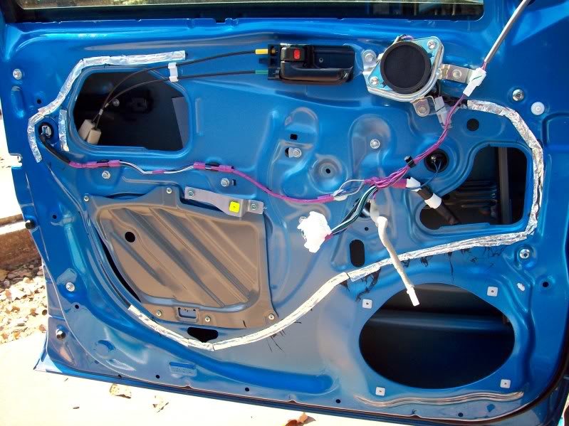

    I have been searching for info on the largest tweeter that will fit in the stock tweeter location in the front doors of my 2011 double cab.
    I want to use a Vifa XT25BG60-04 tweeter which is rather large. The tweeter's dimensions are as follows:
    3.125" cutout diameter
    4.125" overall diameter
    2.2" depth
    Does anyone know what the largest tweeter size that will fit in this location would be? I understand that I will need to fabricate a mount or purchase one from TacoTunes to complete the install. My primary concern is that this tweeter is too large for the location.
    I have done several searches on this site and on the internet with no confirmed results. Please, I realize this is my first post here but if you're going to ask me to use the search function understand that I have already tried this and had no luck.

    Don't worry about the diameter since almost all of it is flange anyway. I'm pretty sure you should be ok on depth too. Here is a pic for reference of what's already under there.
