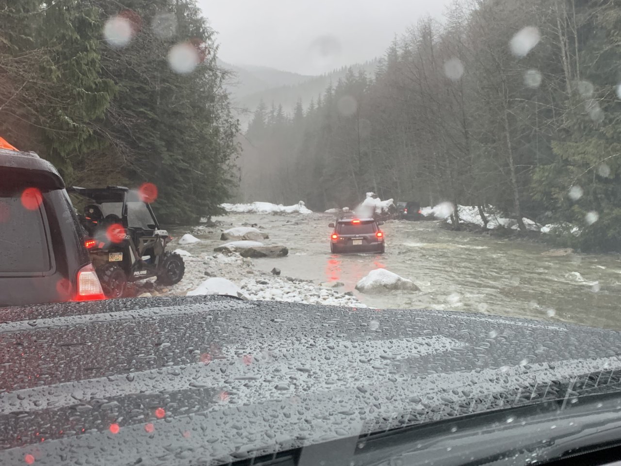

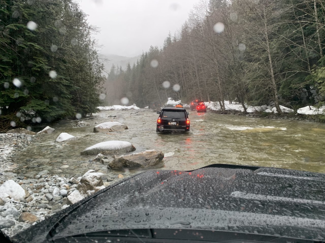

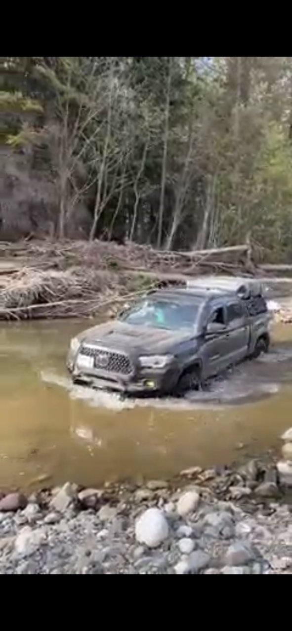

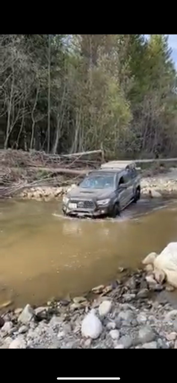

    Some Serious Tires
    I
    Wouldn’t go any deeper than bottom
    Of my doors. Also the alternator is something to consider, it sits pretty low.
    Not the best pics but that’s pretty much as deep as I’ll go. Stock breathers, never had issues.
