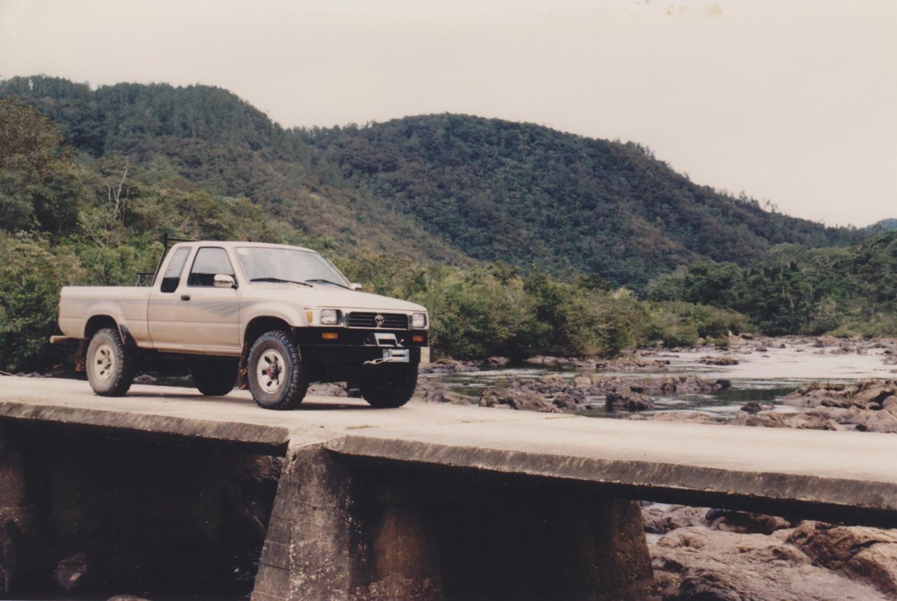

    Crossing flowing water, no deeper than the frame or you will be pushed off the crossing.
    Standing water, keep it below the doors to keep water from getting inside. Drive slowly but with enough momentum that there is a wave out front of the hood and the bumper is in a bit of a trough. Dry out and cycle your winch afterwards.
    My 2nd gen often went as deep as the bottom of the doors without issue. My diesel Hilux has had water over the hood.
    For flooded river fordings in Belize we would disconnect the fan belt on the v8 Chev before crossing, but not worry with the diesel Hiluxs and Unimog.
    Scarier was driving across this with 3" of water over it.

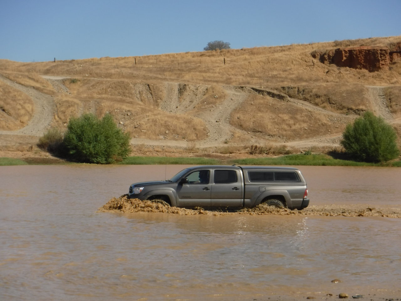

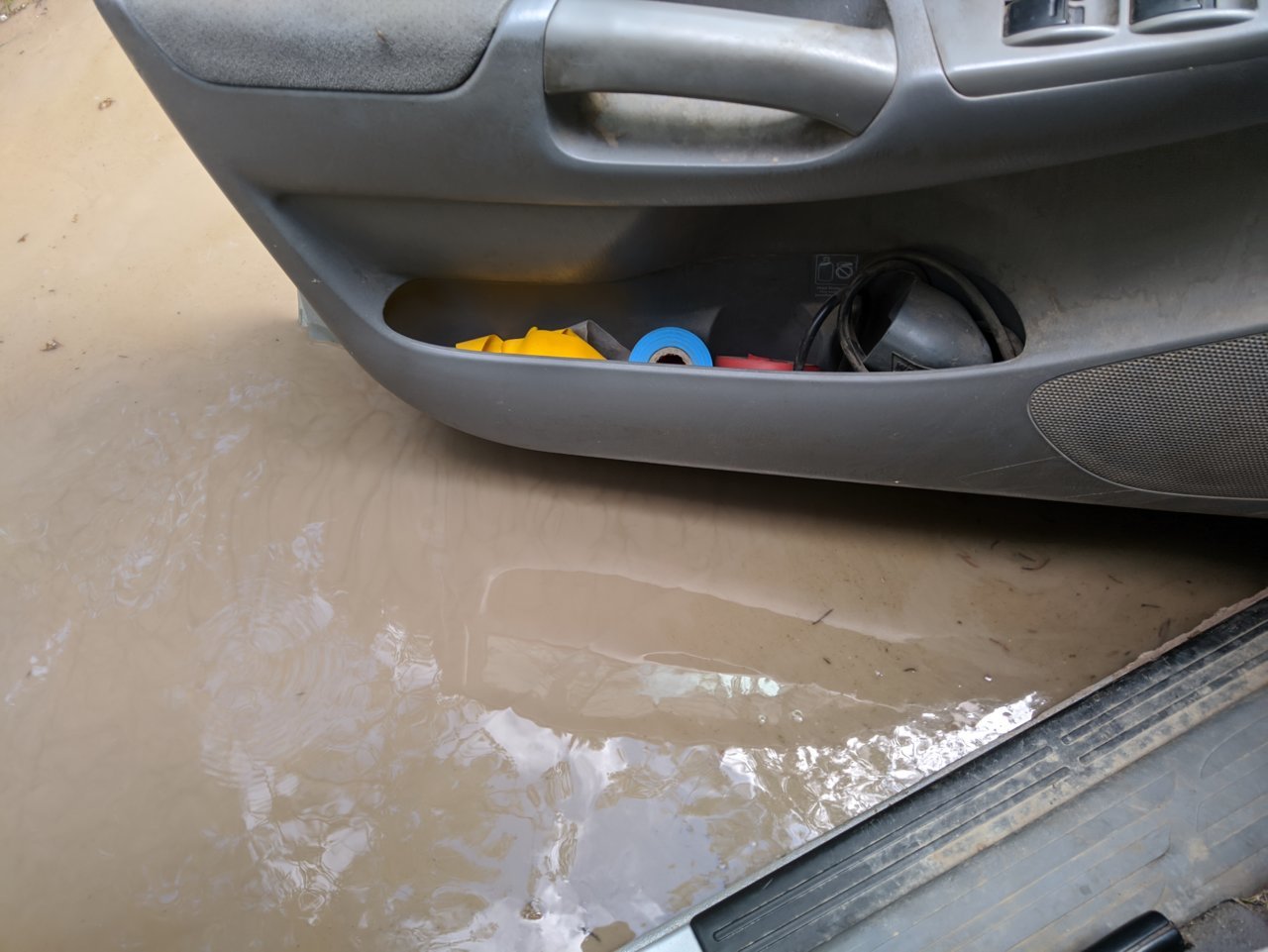

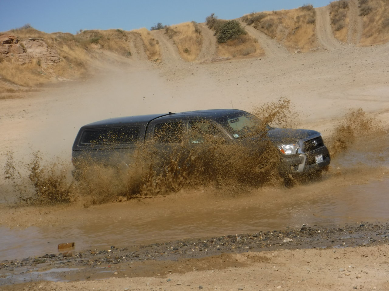

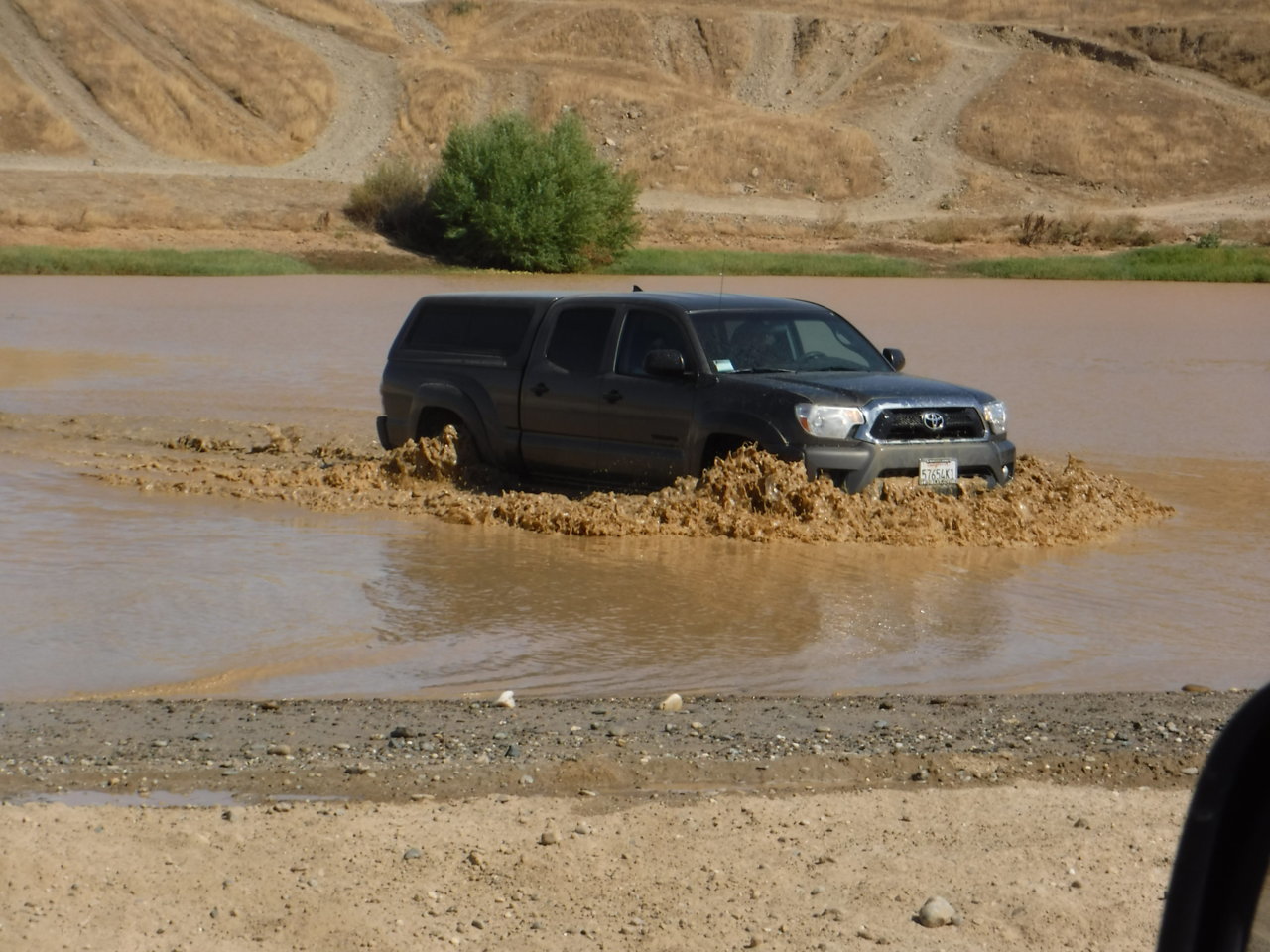

    Me literally less than a week after i brought my new (to me) truck home :anonymous:
