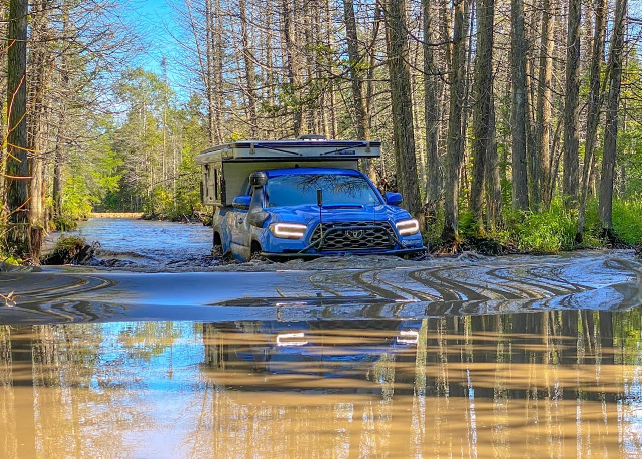

    Long travel house on 35s with a custom aluminum utility bed and FWC
    some welding required
    i try to keep the bed floor above water so the camper doesn't get wet.
    it's all comfort level, some people are comfortable getting their carpet wet, some are not.
    some are comfortable with non-watertight connectors getting wet (anything interior), some are not.
    maybe not the case with salt water, but with fresh water (or mud), electrical components will work for a while wet, for how long is a case by case situation.
    307022843_10101834803046847_692988496913_558e3a2fad5f3acb97ca061f39fc277a74e23f6d.jpg
